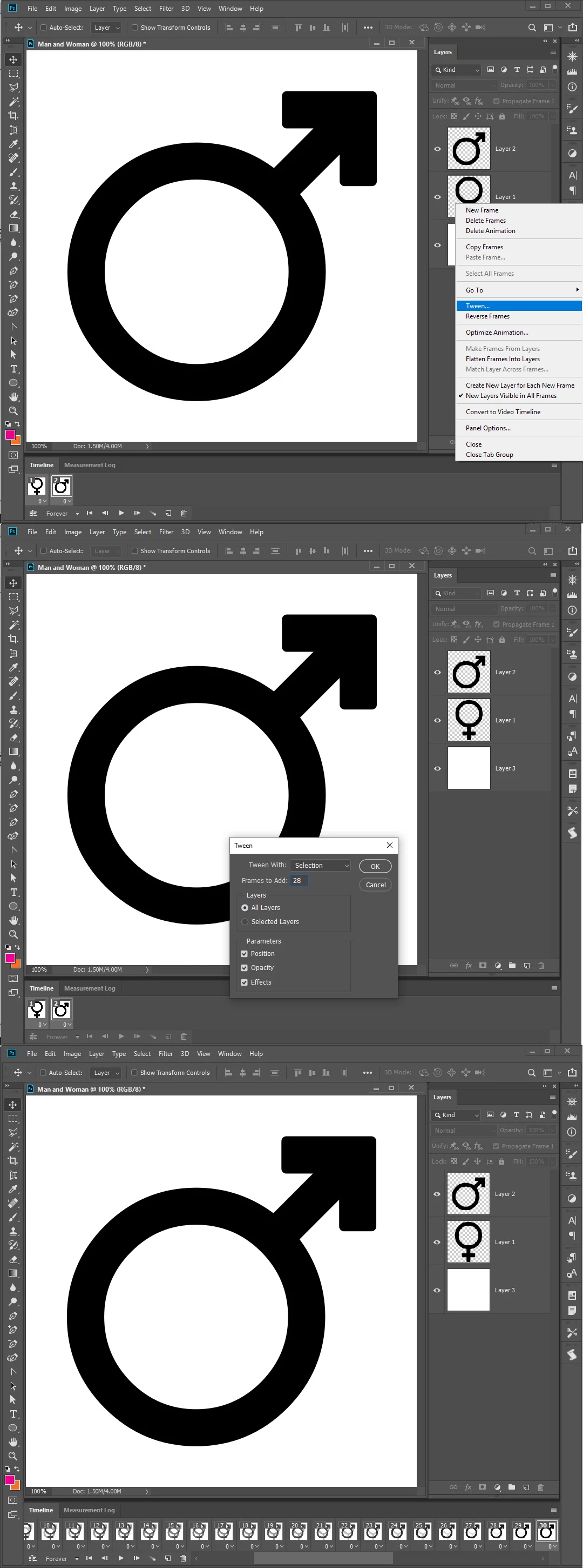

    You can make a super smooth gif with three layers but with 2 or 3 frames. With either a Frame Animation and  tween and opacity or a Video animation  and animating the opacity.  The more frames you created the smoother it will be.

    I was able to get it done with the Tweening option however I am running into two other problems with it now.
    1. The file now comes out to be 15mb, and it needs to be below 300kb
    2. The image doesn't look as good as it did using the website.
