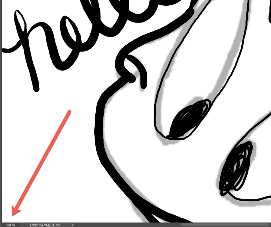

I'm trying to make some lineart on a 3" x 2" image canvas, but my lineart turns out pixelated. The inking line-art I use on Sketchbook Pro is far more cleaner, smoother and crisper. Is there any tweaks I can make on Photoshop CC that can make my line-art smoother.

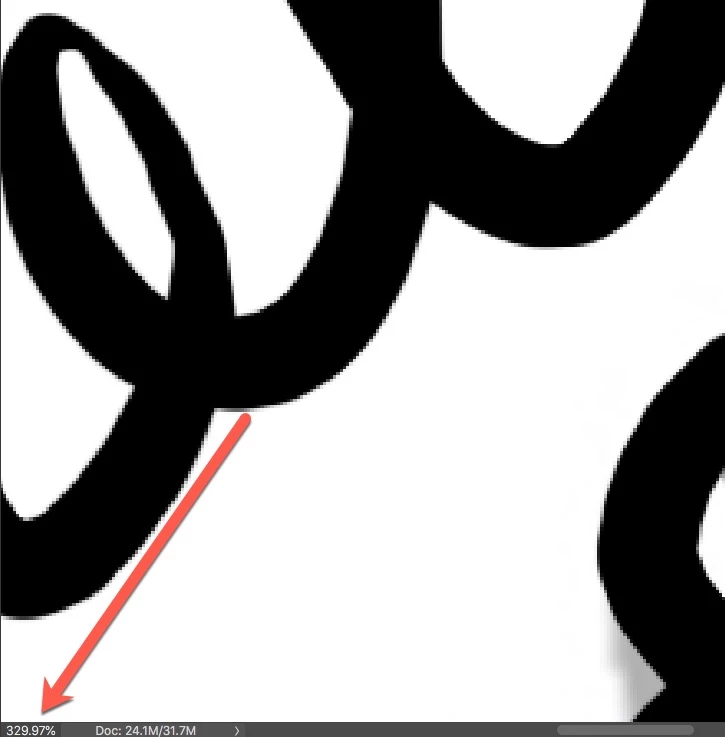

    Illustrator is the way to go for something like this. Do you have an ipad? The Adobe Mobile apps are another option - PS sketch on an ipad pro with the pencil...
    But, you can still make it work in PS - you need to be working on a large image  - lots of pixels. Here is an example - i just created a new document, the default print document 8.5 x 11 at 300ppi. Smooth at 100% but pixelated when zoomed in...

    even that I agree using Illustrator, the drawing should be lined crisp and properly antialiased if drawn using Photoshop, if the parameters are correct. However, to judge if something is crisp, you need to look at it at full resolution (1:1) as recommended by c.pfaffenbichler​.

    How are you drawing the lines?? The pencil tool is very pixelated, the brush is not. The larger you file, the nicer the brushstrokes will look. Post some screenshots...

    May 22, 2018
    Here's this one image. It's a bit pixilated, don't cha think? I use the brush tool, and I draw like I'd use a pencil.

    What is the file’s resolution?
    Could you please post a screenshot taken at View > 100% with the pertinent Panels (Layers, Channels, Options Bar, …) visible?
