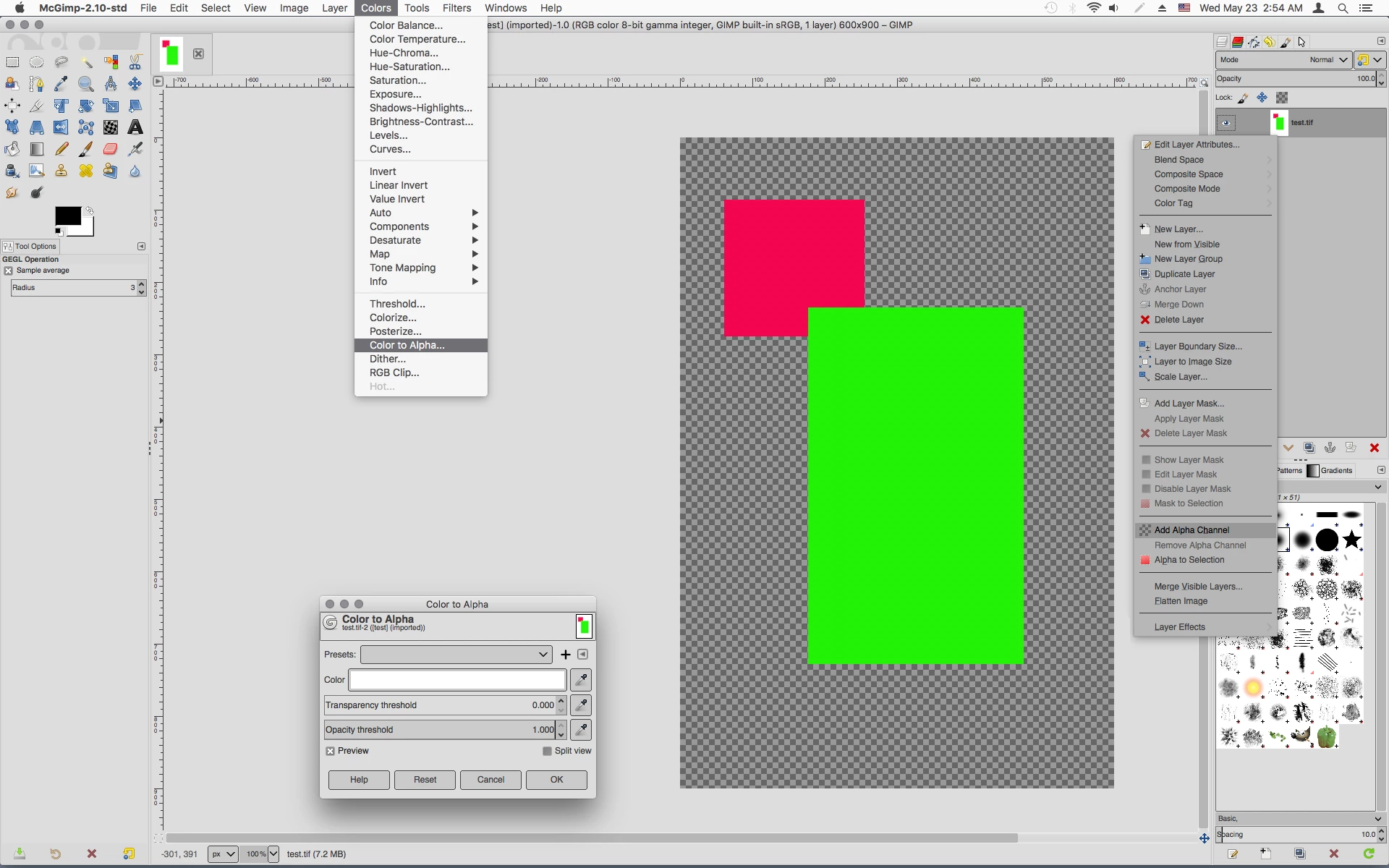

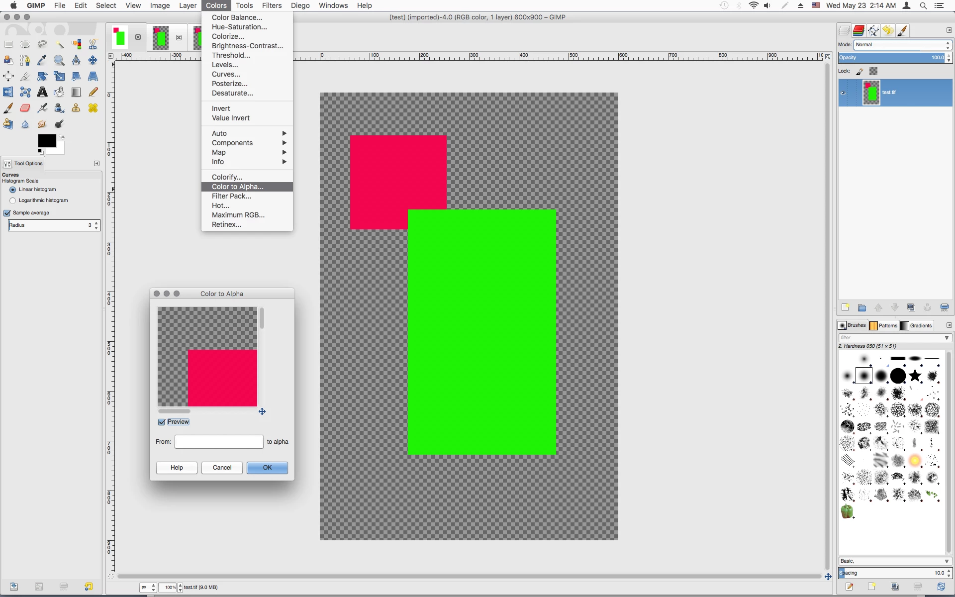

    In Gimp you can get back the transparency in the Test.tif by using Colors>Color to Alpha to remove the white background.
    https://docs.gimp.org/en/plug-in-colortoalpha.html
    In Gimp 2.10 one needs to add an Alpha Channel first before using Color to Alpha.
    Right click on the Layer thumbnail and click Add Alpha Channel.

    gimp 2.8 and older
    gimp 2.10

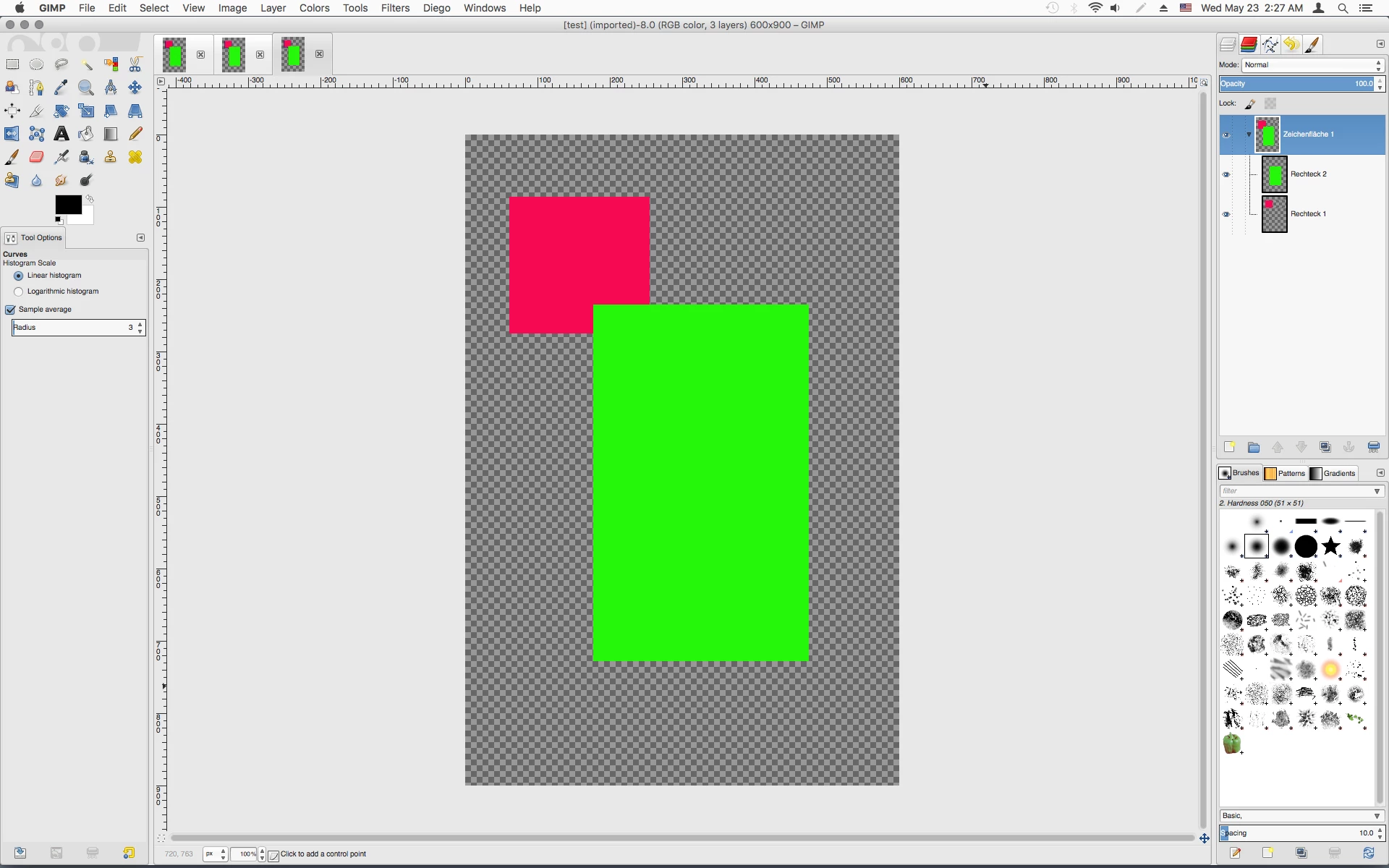

    Your test.tif saved as a psd with the shape layers rasterized and open in Gimp.
