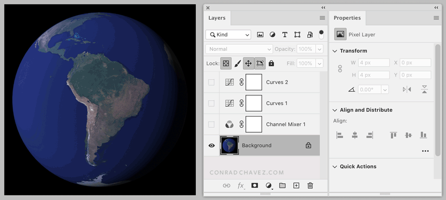

Have you tried using Channel Mixer to alter the color-to-tone relationships, so that the water areas are easier to isolate via thresholds? In the example below, Channel Mixer is used to drop out the foliage and return a grayscale result, and then two Curves layers are used to force apart the resulting land and water tones. It’s a quick and dirty example, and I’m not sure I downloaded the same image you’re using, but hopefully it gives you enough ideas to reduce the amount of work you have to do.
