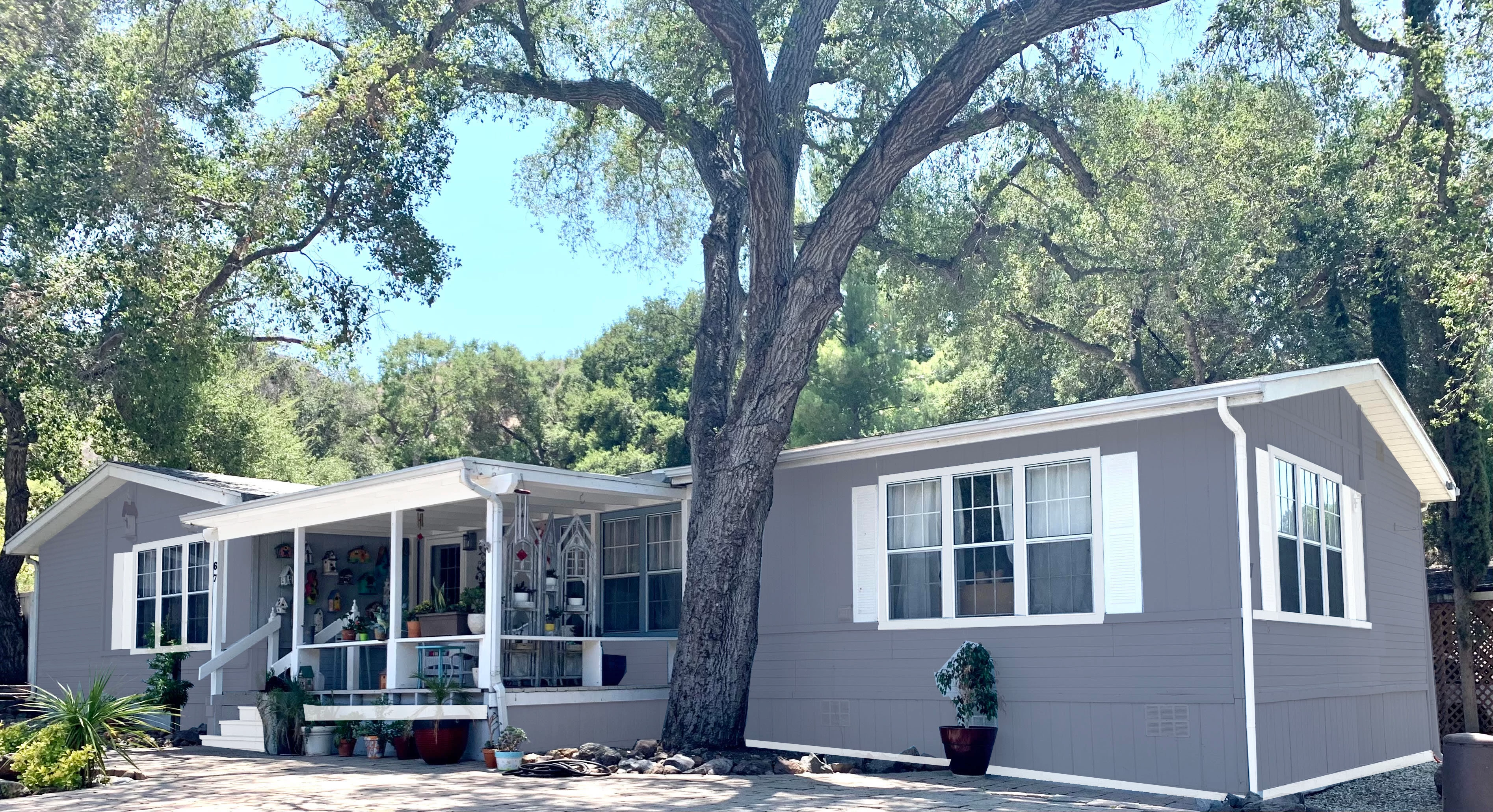

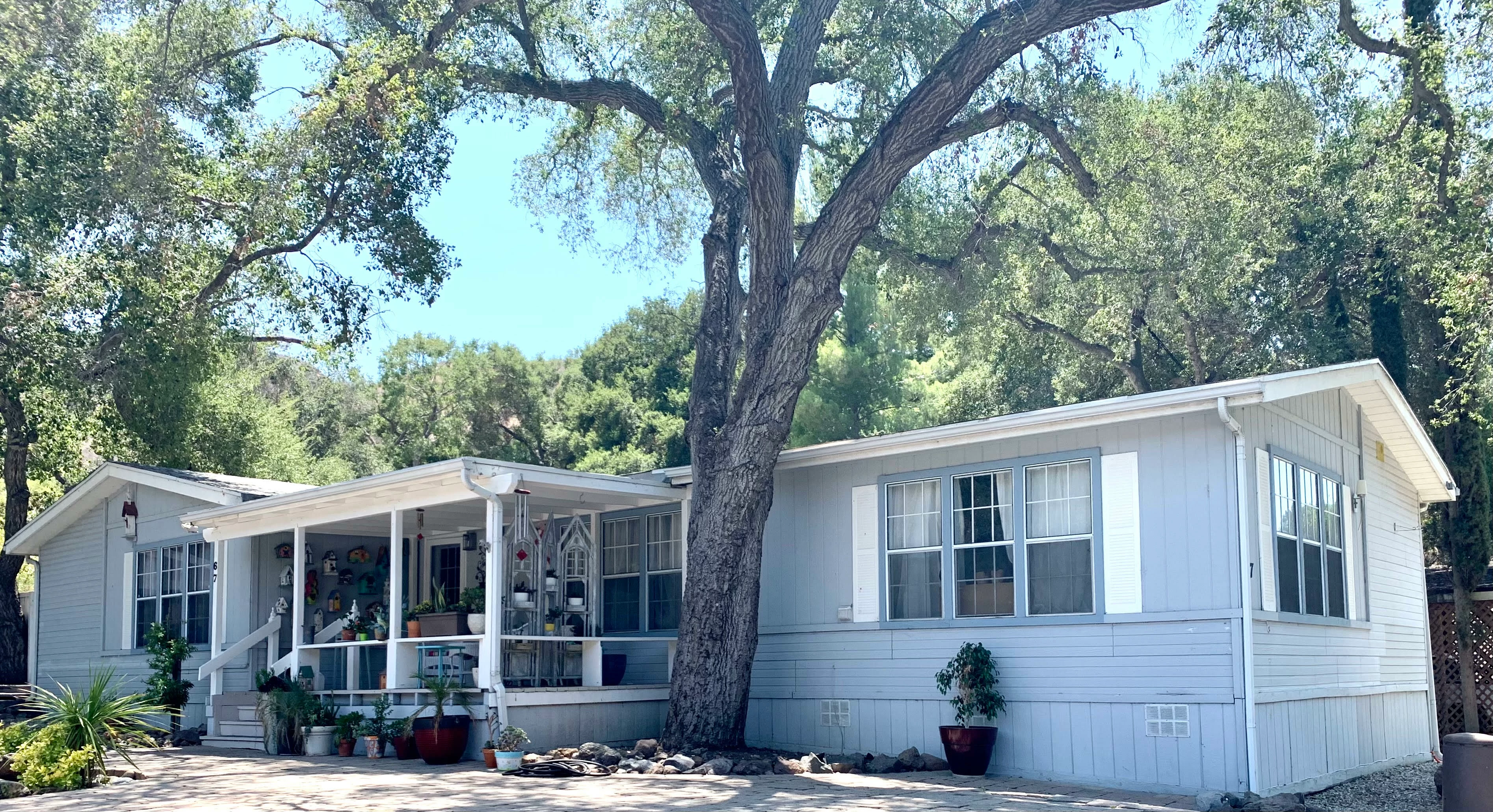

I did several selections of different areas of the house and then immediately filled with paint bucket after each selection. I now want to go back to the individual selections and change the colors without losing all my subsequent steps. Ideally I'd also like to merge the selection areas into 3 groups (non-contiguous selections):  house, trim and shutter colors. In hindsight, I probably should've done the selections and then saved the selections (how?) THEN played with the paint colors via paint bucket??

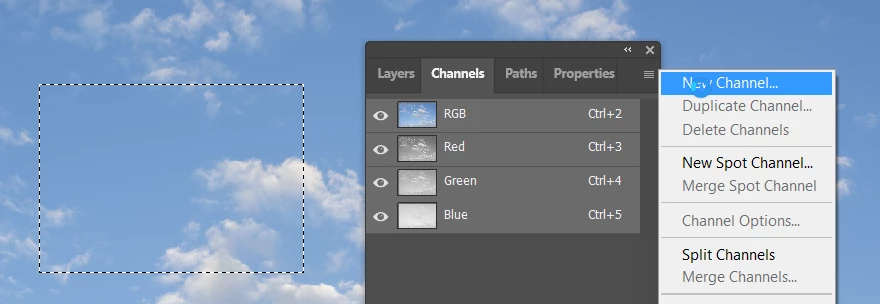

When selections are saved, they are stored in the Channels panel.
