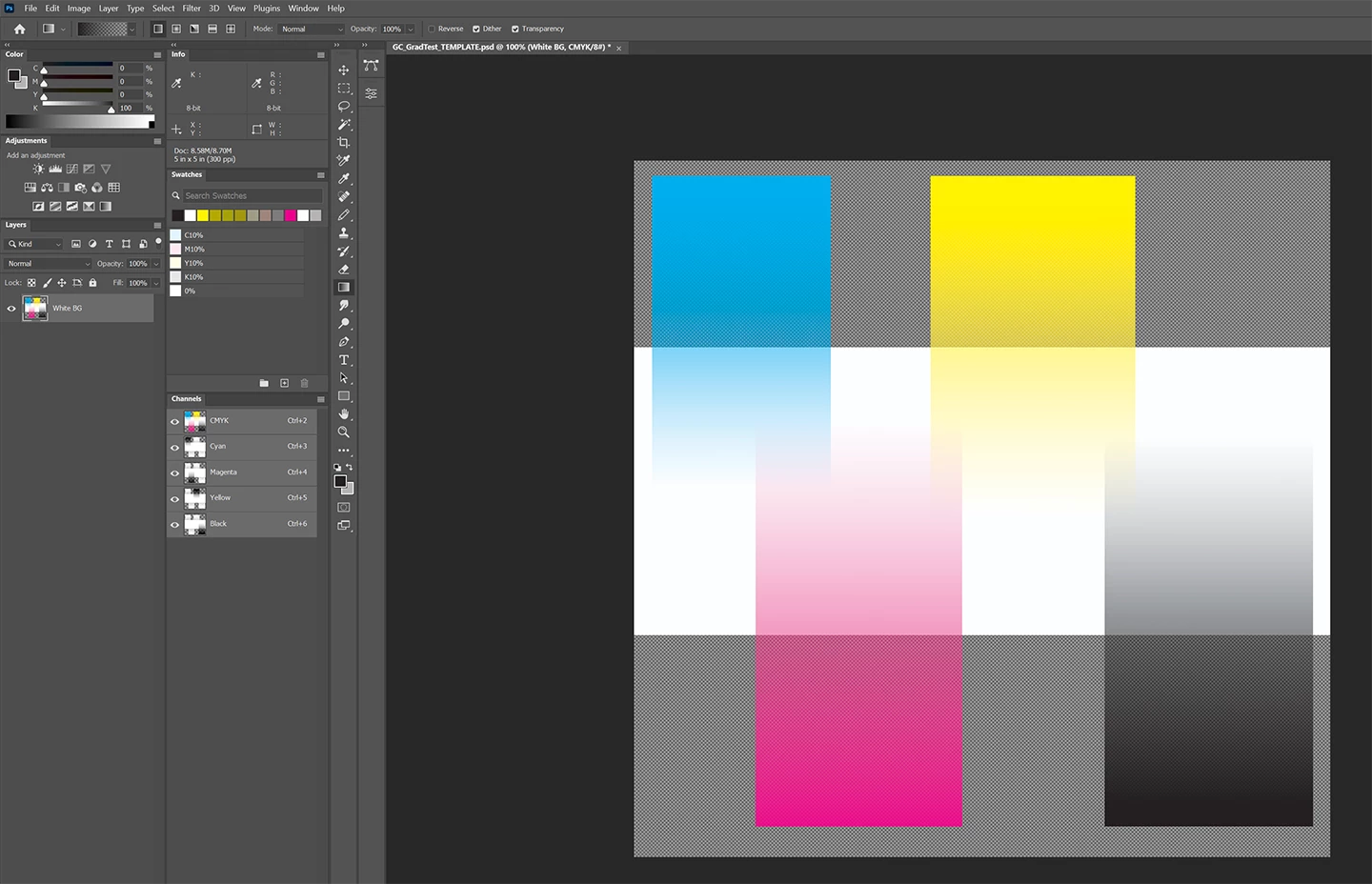

So I've set up a basic example image using pure CMYK + white colors to demonstrate the issue.
My magic want  doesn't have a  point sample, is set to non-contiguous, with tolerance set to 0.

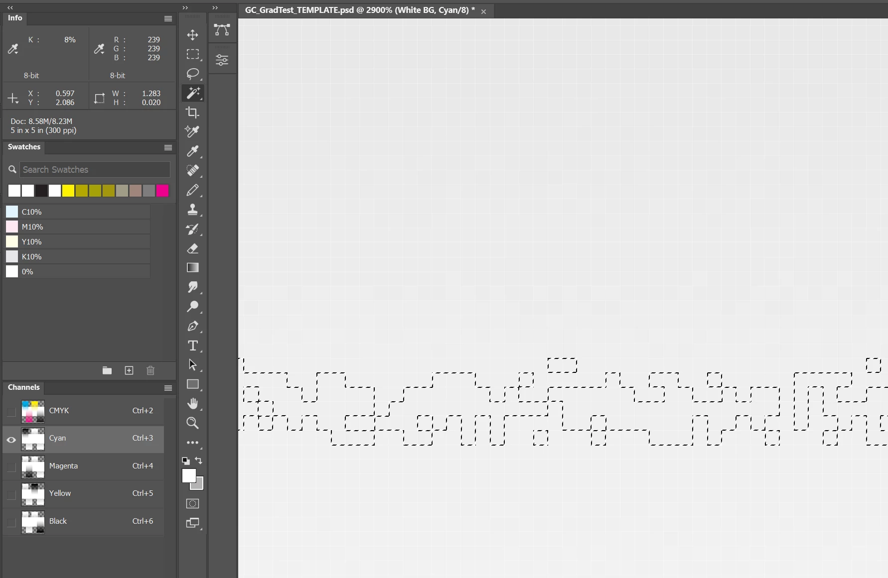

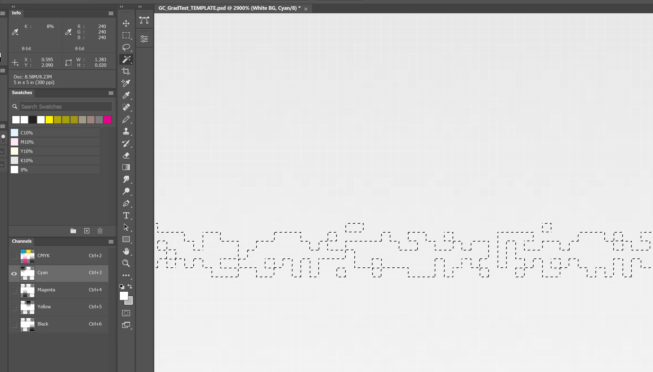

What I am trying to do is select all areas in the image of 8% grey on the cyan channel. Which it looks like it has done however if you look closer you can see that it has selected area of 8% grey that also have the same RGB values. I want to be able to select all areas of 8% grey regardless of the RGB values. The main idea is to select all areas of 1-4% of grey and make it 0% and areas of 5-9% brought up to 10%.
What I want to do is be able to quickly select all the necessary specific grey values in each of the CMYK channels and adjust as necessary.
Hopefully that all makes sense and thanks for trying to help me out!
May 17, 2021
Wanted to follow and mention that it appears as though the magic wand tool in only looking at the RGB values not the K value which is what i want it to do.
