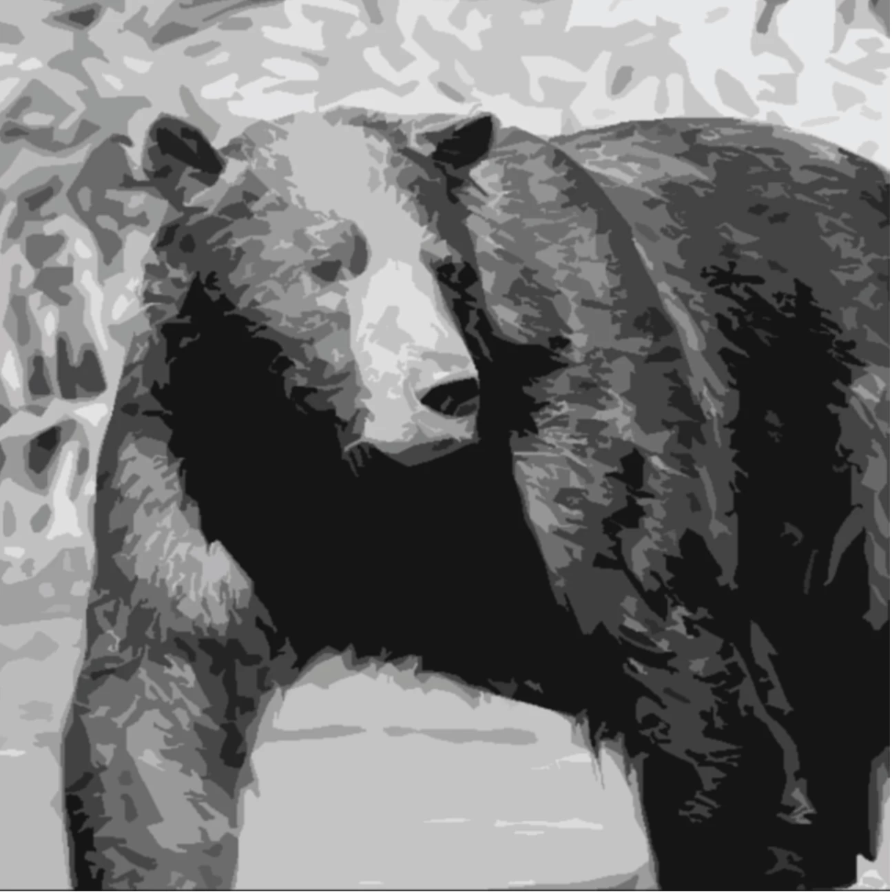

I know it can be done because I've attached the evidence. And it can't be TOOOOO complicated because I did it. But I can't for the life of me remember how.  Help?
GOAL: Create an image from a color photograph that lets me create sections of that photo by value. Maybe 4 values, maybe 10 or more. The important thing is that unlike "posterize" the end result has defined "shapes" that I can use as a template for collage, etc.
See the attached. The original image, and the outcome that I am trying to replicate!
Correct answer Nancy OShea
Looks like one or more Filters from Filter Gallery.
Unless you saved it as an Action or wrote down the exact method & settings used, it may take some repeated trial & error to replicate what you did last time.
Go to Image > Mode > Grayscale.
Copy Layer with Ctrl + J.
With topmost layer selected, go to Filter > Filter Gallery > Artistic > Cutout.
Adjust values to suit.
Hope that helps.
December 8, 2022
Image->Mode->Indexed Color, set to a low value and turn off dithering.
Image->Mode->Greyscale

Is it possible you did it in Illustrator with Image Trace?

Hi Melissa! Thank you. Didn't do in Illustrator. I'm dangerous in PS, LETHAL in Illustrator! Thanks!
Hope that helps.

BRILLIANT!  I think that must be it!!!! Nancy - thank you!!!!!! I thought I was going crazy. Appreciate you!
