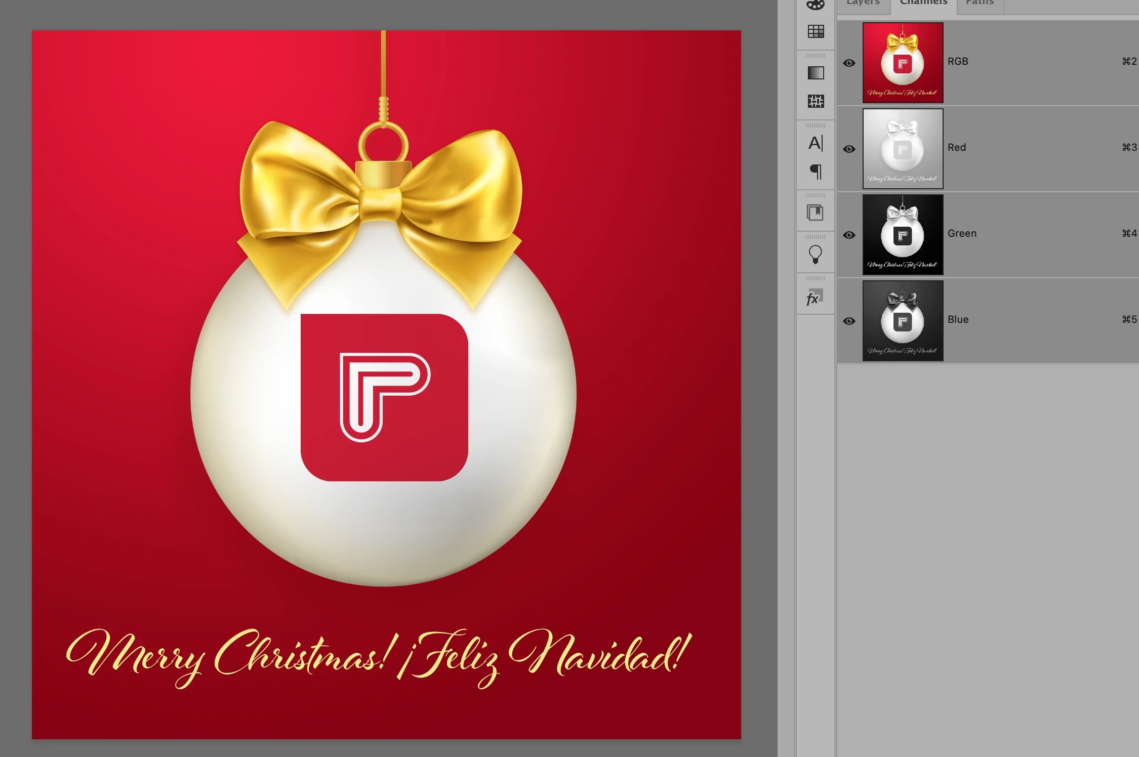

Hi, I'm trying to access channels for just one layer, not the whole image, but I can't figure it out. I'm trying to add someone into an image from another image, and the lighting is weird, so I'm trying to fix it via channels, however when I try and get to them, it's for the whole image- not the layer of the person I'm adding. Thanks!!

The trick is to turn off all the layers you don't want to see, then you will only see the image you want to work with in the Channels.
Here is my original:
Notice the whole image is visible in the Channels panel?

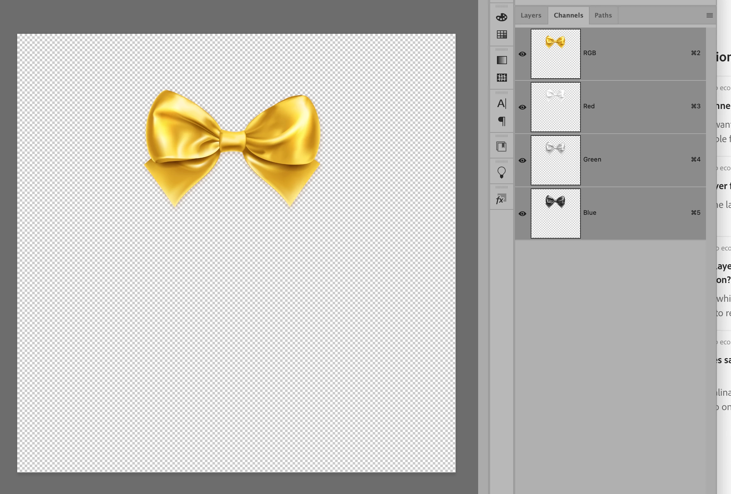

Here is only one layer selected, and the corresponding image in the Channels panel.
Hope that helps!
