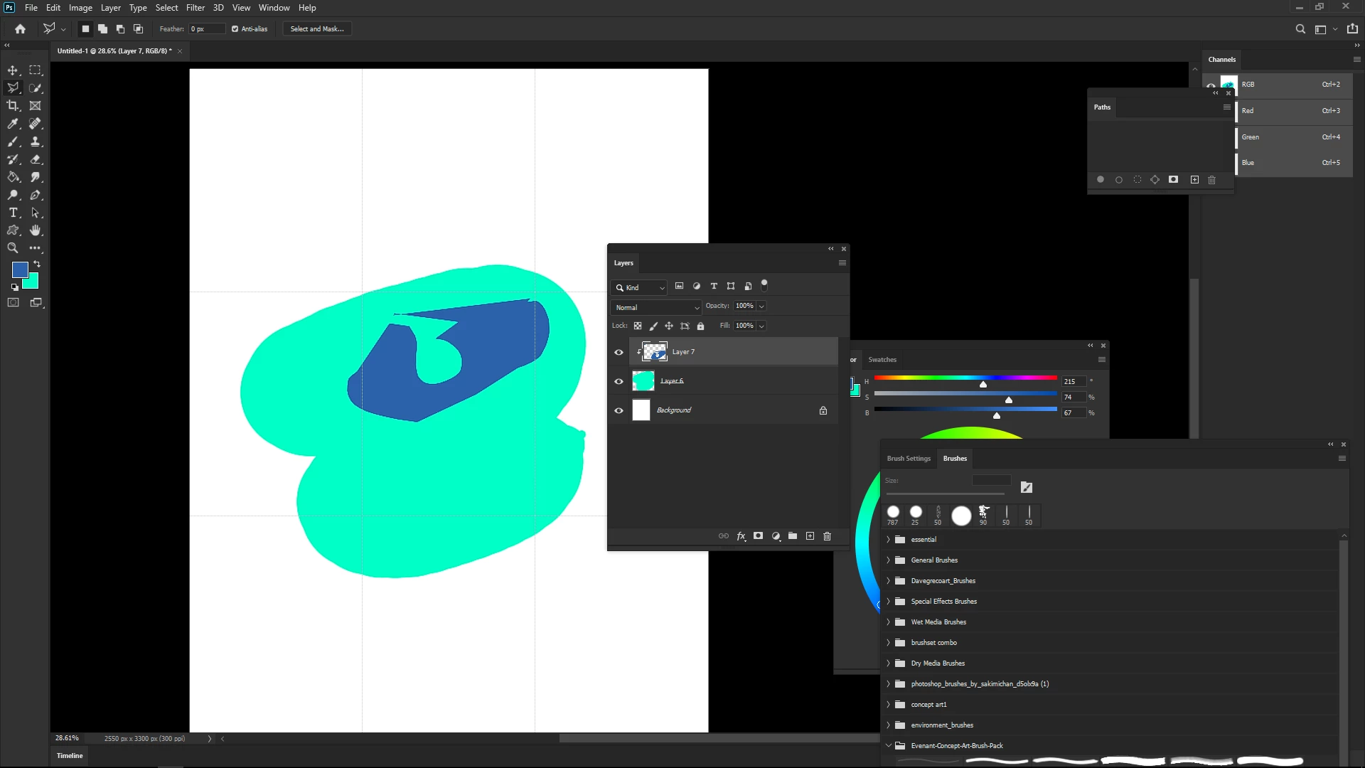

I want to apply a adjustment layer to layer 7 only(which is clipped to layer 6) how do i do it?

You can clip an adjustment layer to a pixel layer, so that the adjustment only applies to that layer - even if that pixel layer is itself clipped to an underlying layer.
In other words, just go ahead and add an adjustment layer, and clip that to Layer 7.
That said, I can't see that clipping 7 to 6 accomplishes anything here, it's contained within the pixel content boundary anyway. It's just floating on top. Unclipping it won't change anything.

How do i clip another layer to my already clipped layer,here layer 7 is clipped to layer 6
D Fosse
June 2, 2021
Place the cursor between the layers (in the Layers panel)
Press the alt key
Click
