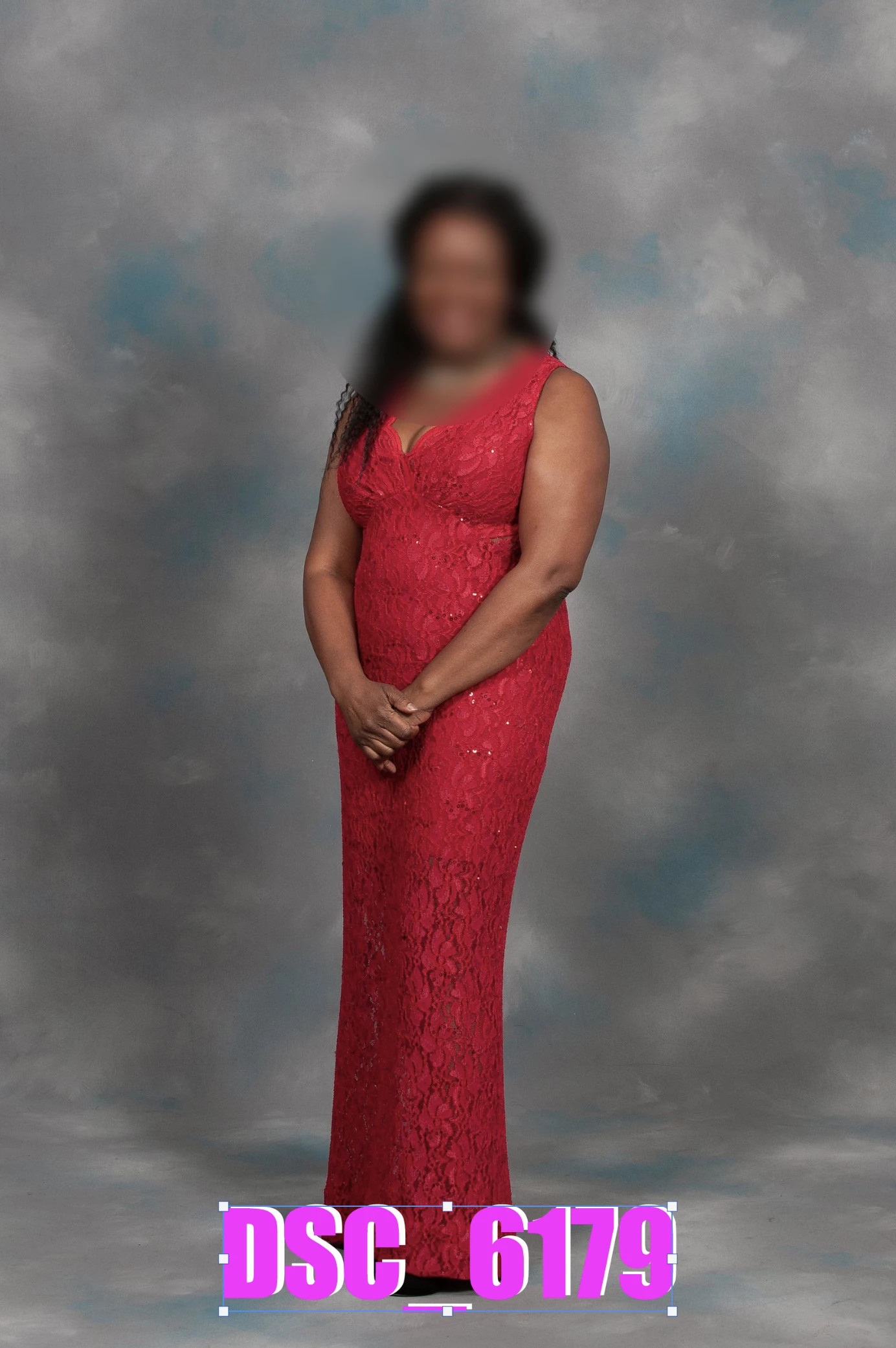

P.S. Here is the result of my script in magenta, it almost perfectly matches your example forum upload.
