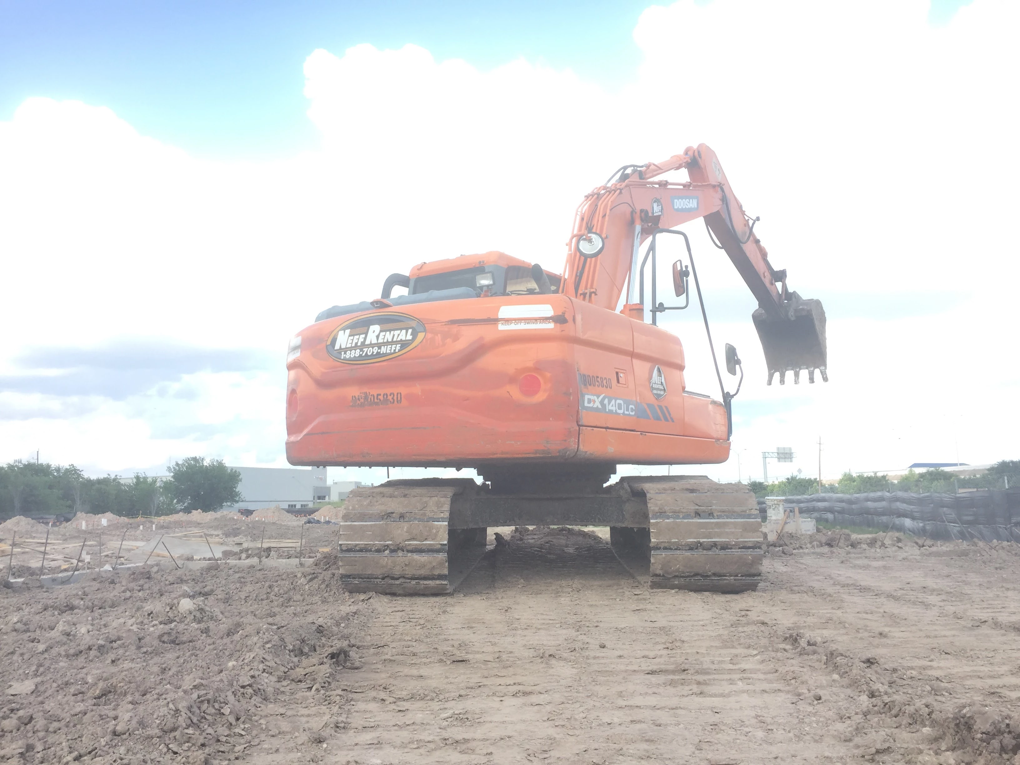

I am trying to 'contort' text over a curved, three dimensional object, but do not know how to do it. I know how to put curved text on a curved line, but I do not know how to make a certain word contour in three dimensions on the back of this excavator? Basically, I want it as if it was painted on the back of the excavator.
Any help is appreciated! Thanks!

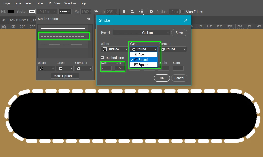

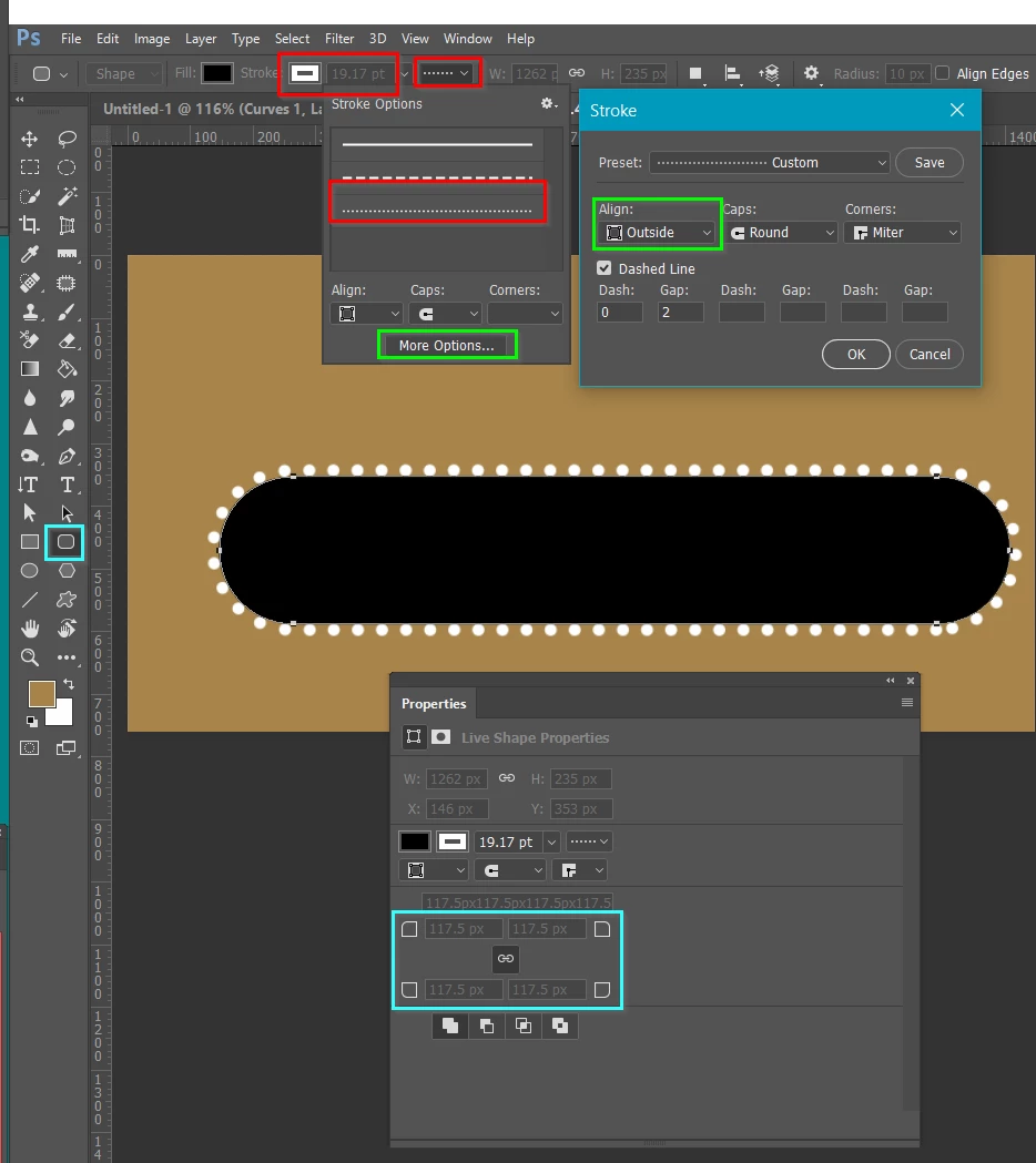

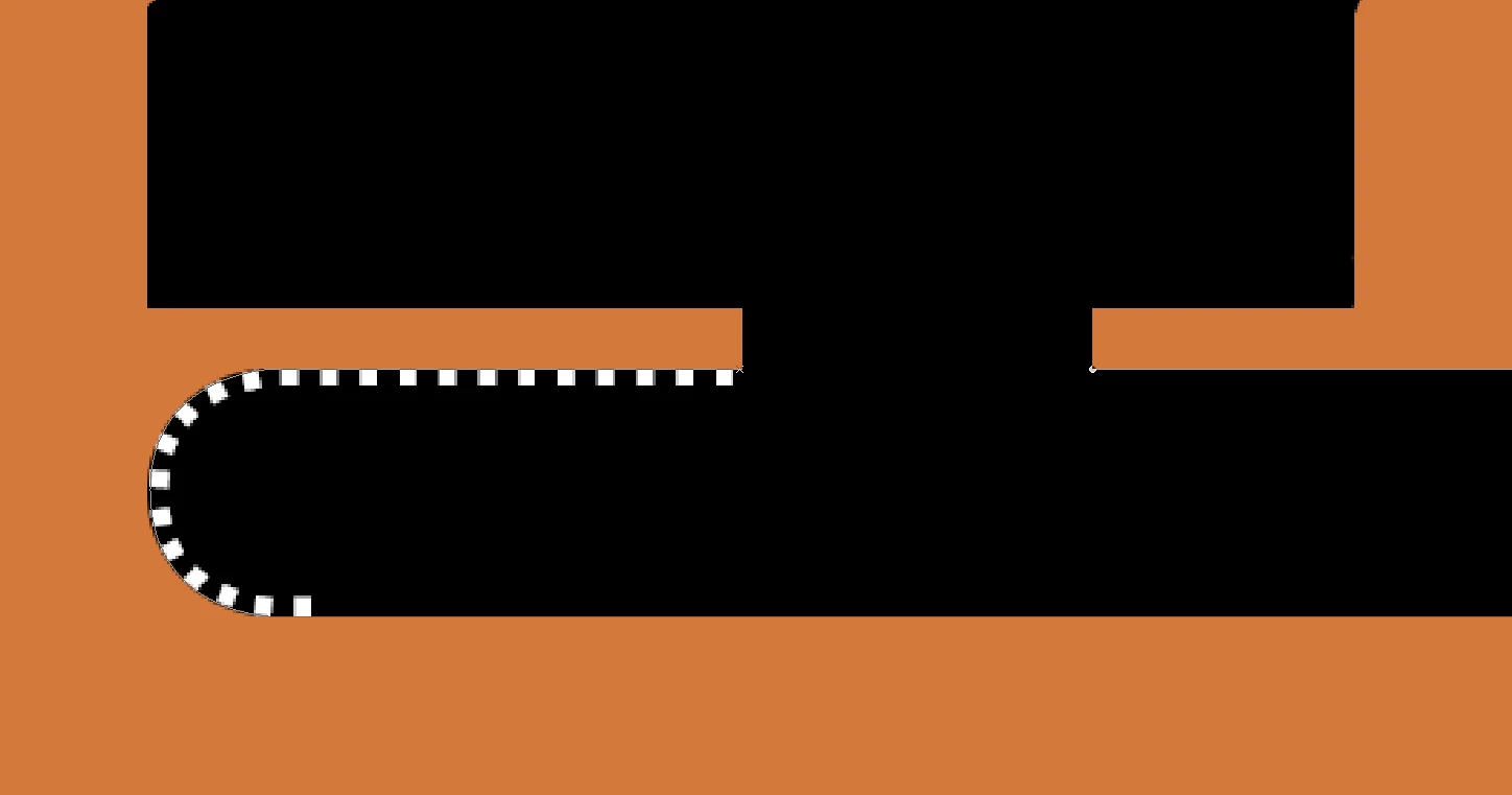

    There's a better way to make your dotted stroke.
    1. Instead of drawing the rounded rectangle with the Pen tool, use the Rounded Rectangle Shape tool (cyan highlight) and in the properties panel move the radius as far as it will go to make the ends into semicircles
    2. Make the Fill black, and the stroke white.  Adjust the Stroke size to match the size of the dots.
    3. To the right of the Fill, use the style drop-down (red highlight) and choose dotted line.
    4. Click on More Options, and in the resulting panel change Align to Outside.
    5. Adjust the space with the Gap setting if required.
    6. If your dots are the wrong size, go back to the Stroke slider and adjust.

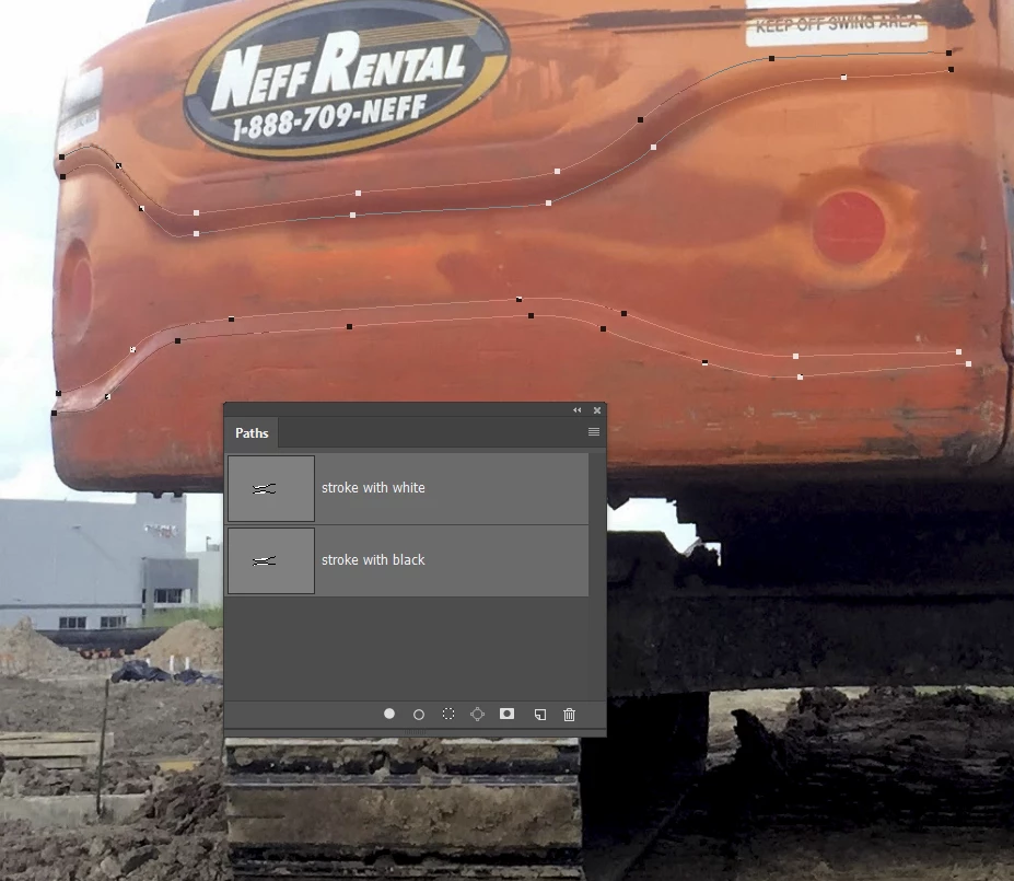

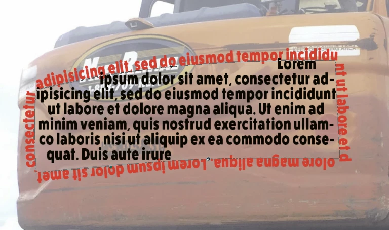

    I also am working on another picture of an excavator; and am using the pen tool to make a guide to which I can just type periods on. However, I do not know how to make it type on the other side of the path. It'll only type on this side:

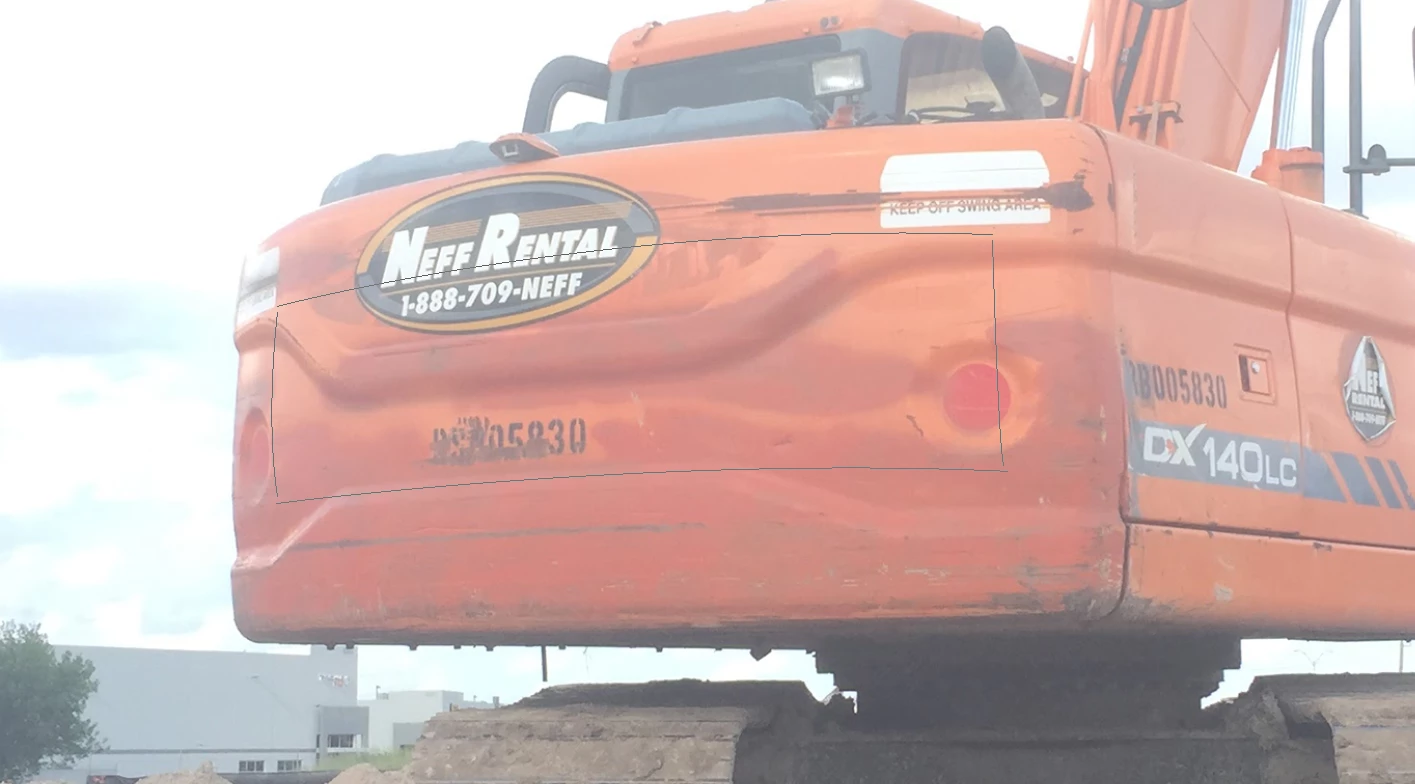

    However, after a google search and search through photoshop, I don't know how to jot down black as well as white anchor points?
    As well, I think didn't explain well enough; I need my text to actually follow these lines (not the wavy contours of the back of the excavator):

    I'm not entirely sure what you would like to achieve.  There is Text on a Path (red), or Text in a Shape (black) below.  I somehow don't think either is what you are after though.
    Do you want your text to fit inside your guides like this perhaps?   Draw it freehand if you find it difficult to describe.
    April 22, 2017
    Yes, I want it to fit the curve that I have drawn with my guides! As if it's like a graphic wrap on the side of a van.
    It's going to be used as a clipping mask, so all I need is the text without any blur's or highlights. :-)

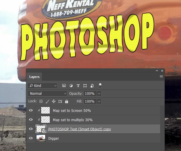

    April 21, 2017

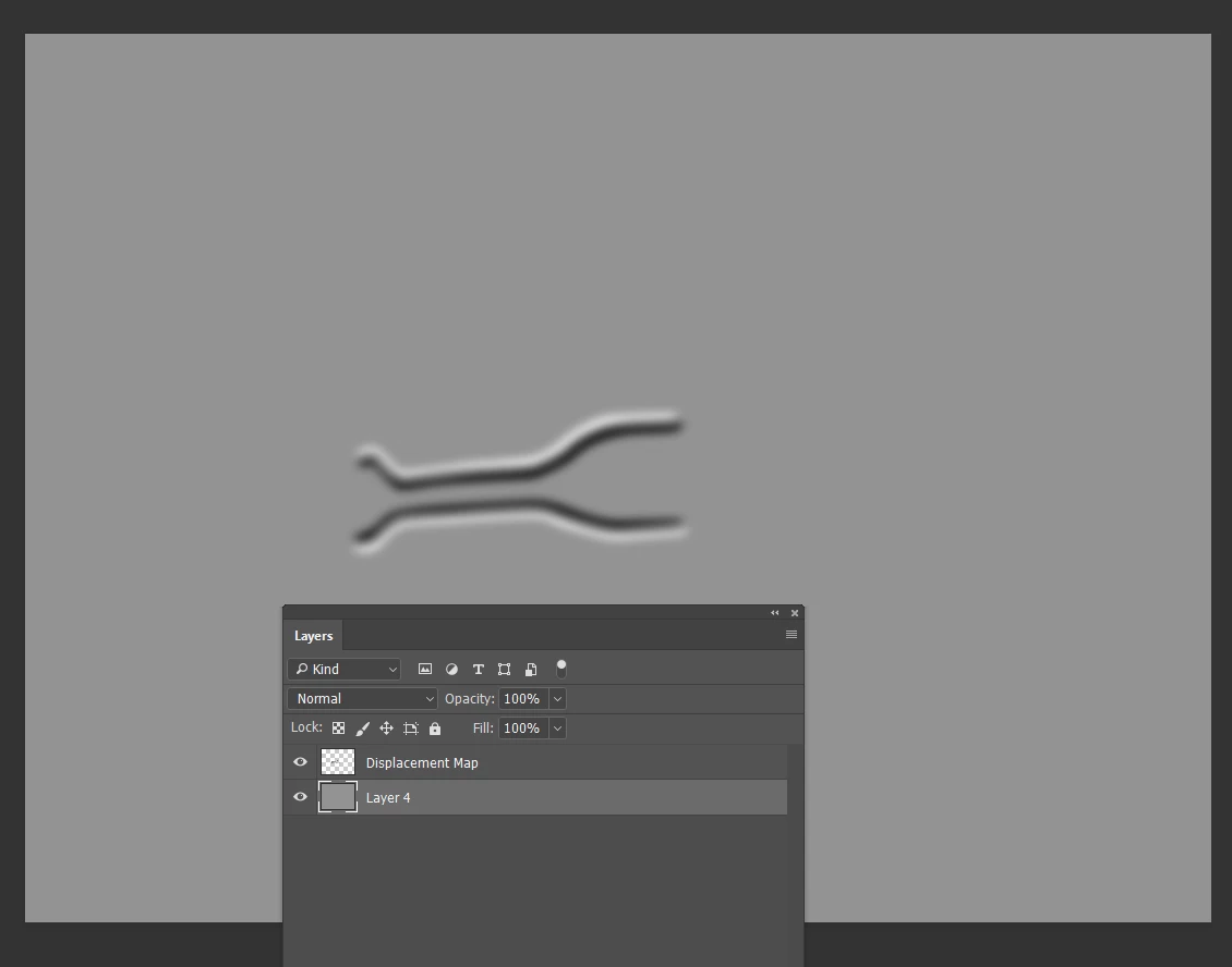

    Ass JJ says, a Displacement Map.
    First you need to construct the map.  That means black where you want a concave curve, and white for convex, and that is best done with the Pen tool.
    Duplicate the map layer to a new document and blur it.  I have placed a grey background behind it so you can see the white, but you don't need that.  Save this layer as Digger Map.psd

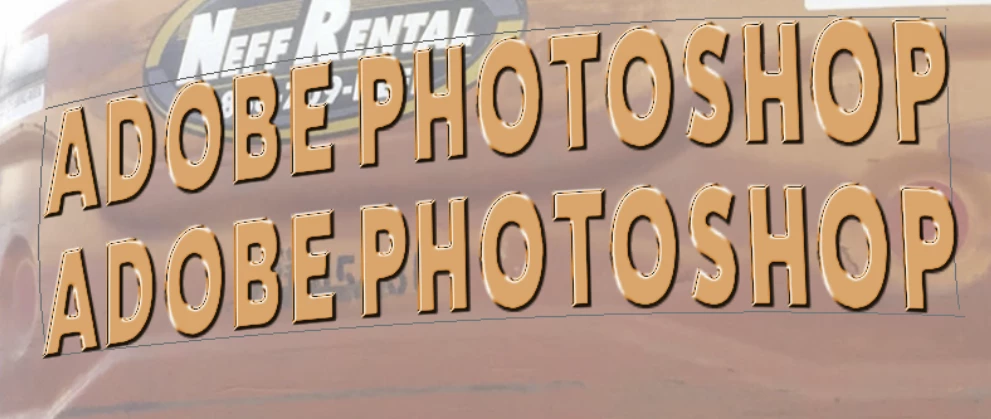

    Then add the text, and Free Transform roughly to shape.  It has to be made a Smart Object in order to warp it.

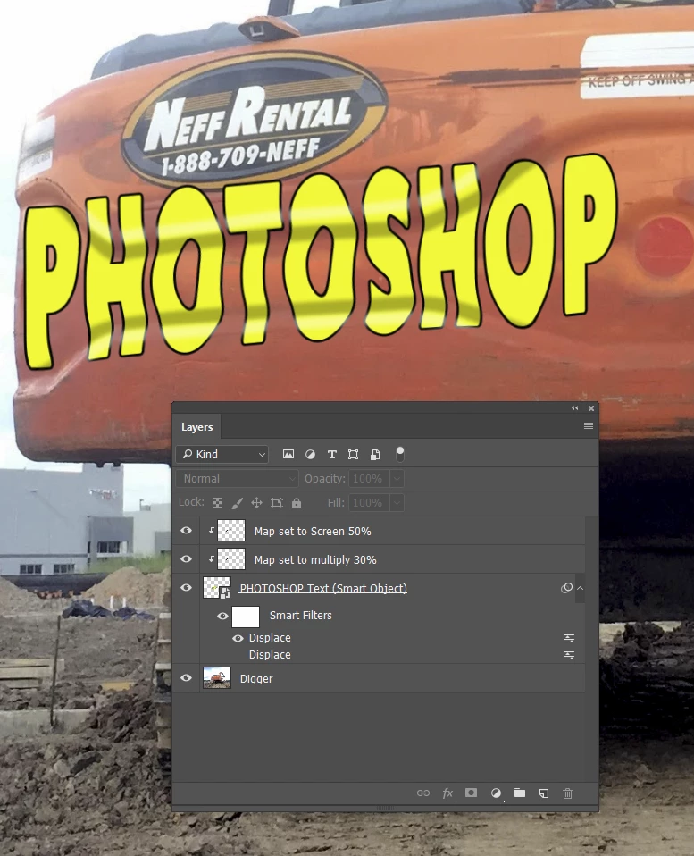

    Select the text layer and go Filter > Distort > Displace and use lowish values (5,5 )
    You'll get something like this.  Note the two map layers are turned off (see next section)
    We need to add some depth, so copy the original map layer, and set one to Multiply, and the other to Screen.  Adjust opacity to suite.
    I'm actually wondering if it work to use the map twice.  Once with 5,5, and then again with -5,-5 to distort the text in the right direction on the left.
    Well it kind of worked, but got a bit complicated.  The masking is a bit fiddly, and you need to relocate the two layers and then recombine them as a nested Smart Object so you can clip the shadow and highlight layers.  Probably not worth the trouble.
    [EDIT]  I've been looking at this some more, and I think the distortion is definitely more accurate doing it two goes using negative values on the left.  That's a new trick for me, so I have got something out of this thread for myself.
