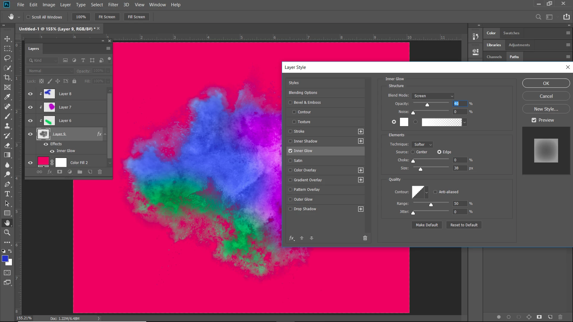

If you don't like the darker outer edge, you can add a blank layer above your explosion layer then select it and your explosion layer and press ctrl-e to merge them. then reclip all the color layers to the merged explosion layer. open up the layer effects dialog and add an inner glow with white, set to screen. adjust to your liking.

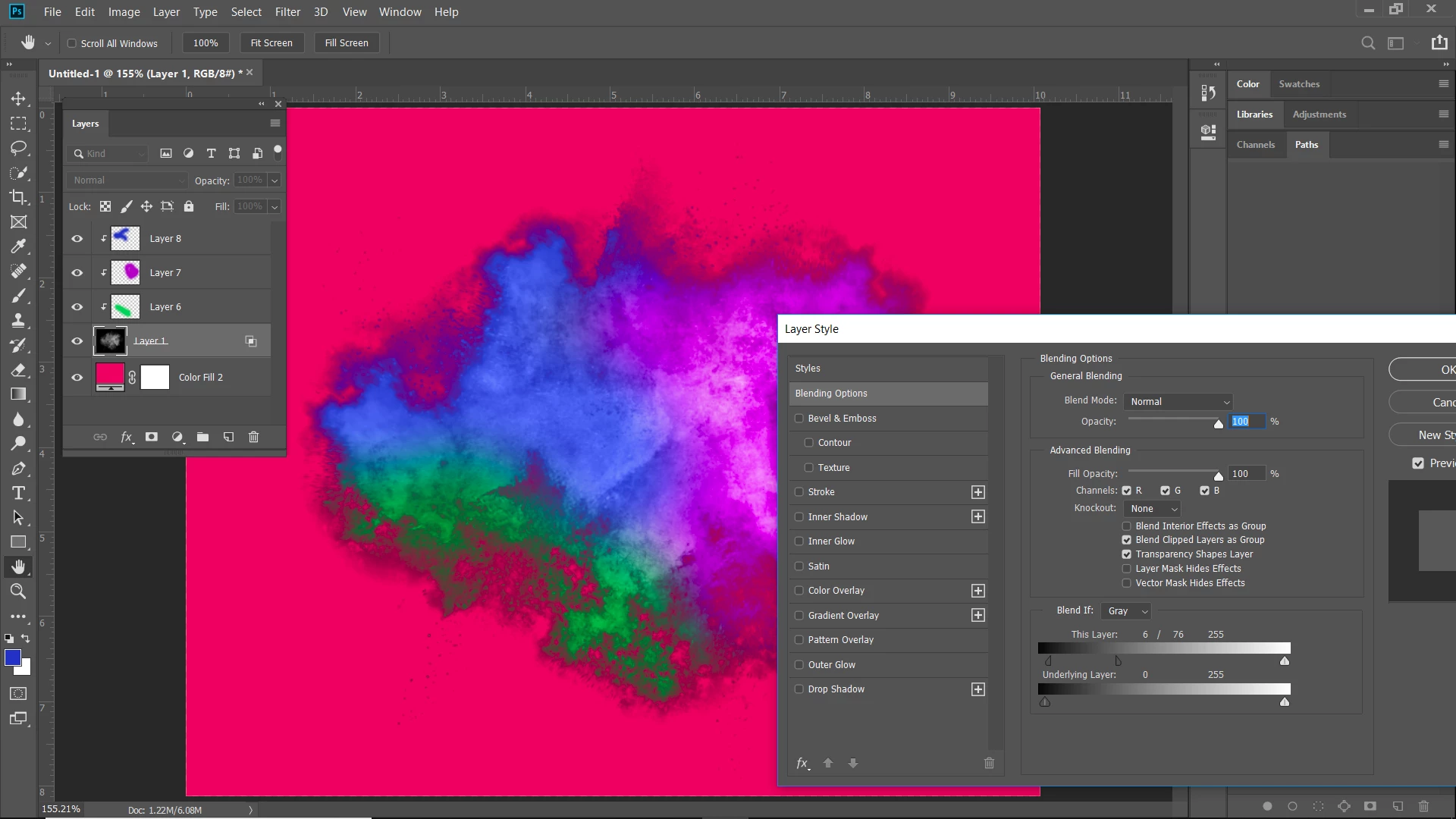

Clip your color layers to the explosion layer, making sure they're set to color blend mode, or you can merge the three color layers into one layer, like the video and then set it to color blend mode. Open the layer effects dialog by double clicking on the explosion layer and use the blend if sliders to eliminate as much of the black background as you want.
