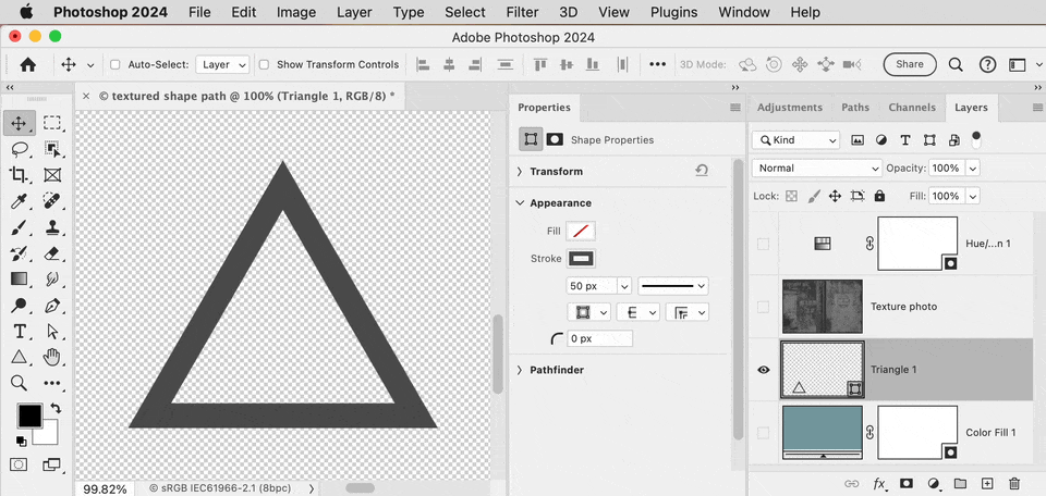

The straight lines, arcs, and shapes in the posted example generally look quite precise and machine-made; what look hand-drawn are the textures within the lines and shapes. If that’s what you’re after, you can stay in Photoshop and get a lot done by studying layer blending modes and clipping masks.
In the demo below, the Triangle 1 shape layer remains an editable vector shape layer, it’s given texture by applying a grayscale photo layer of a textured wall as a clipping mask, and it’s given color by also applying a Hue/Saturation adjustment layer as a clipping mask. The clipping masks restrict those upper layers to the shape, and everything remains adjustable. I think many of the effects in the posted example can be achieved this way.

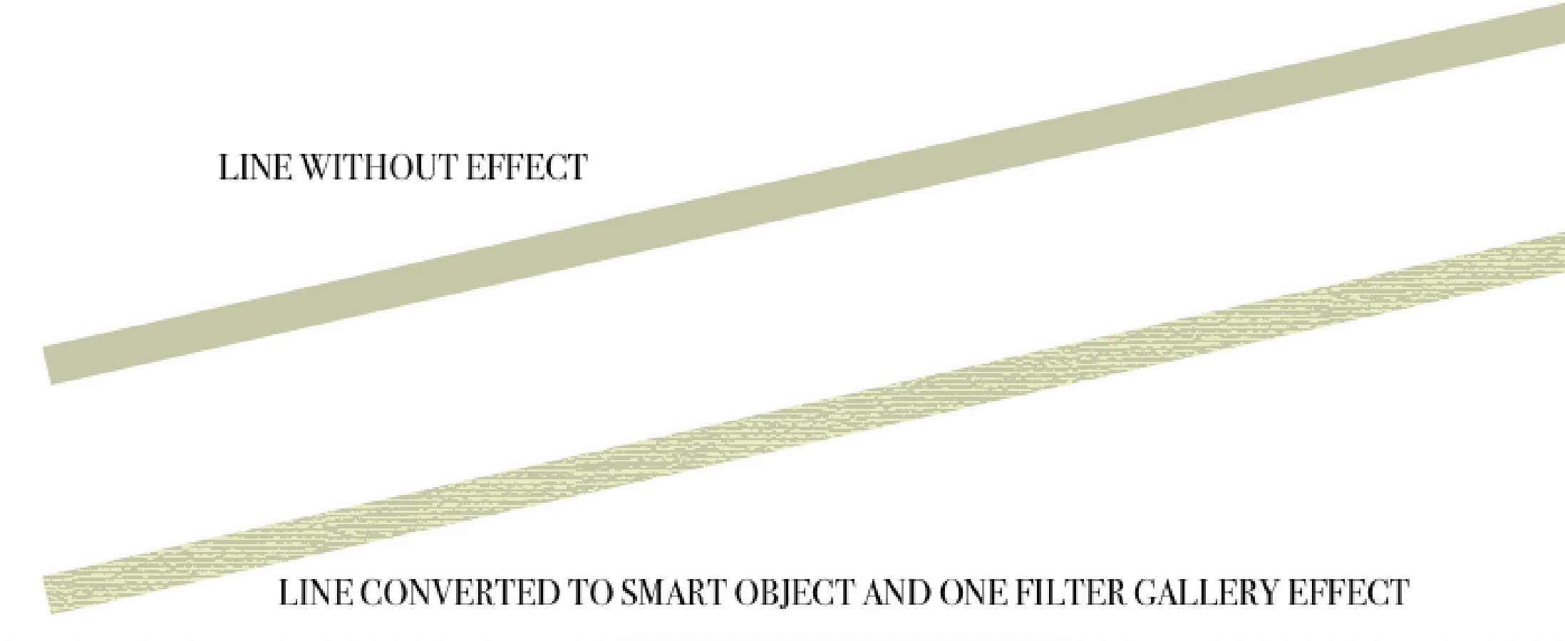

I would draw the shapes and line and afterward use filters…
 But for such hand drawn effects, Illustrator is way more effective

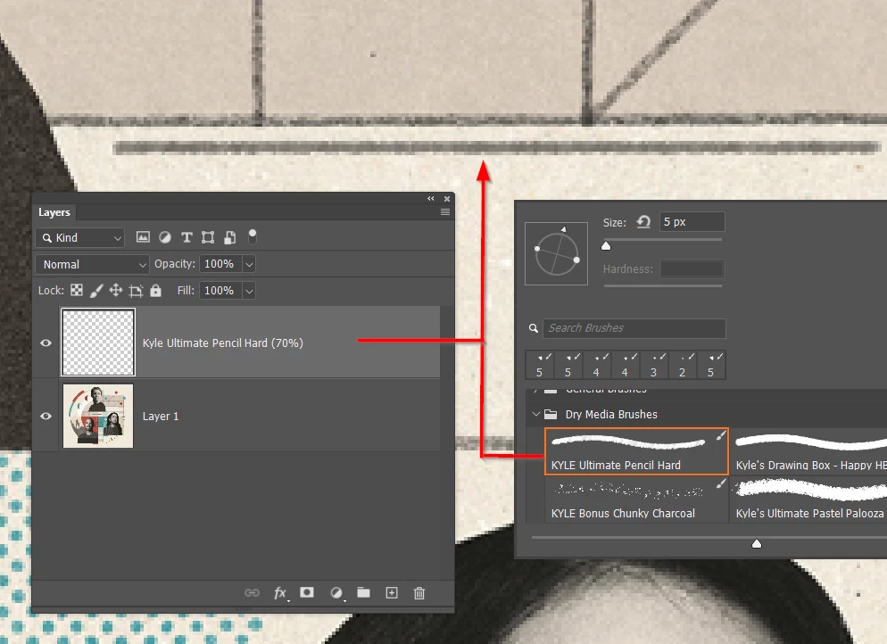

@jeljohnssp why cant you stroke them with a pencil brush?
Perhaps you are using the wrong brushes - check out Kyle Webster's brush packs - they are more organic and simulate media better than the default PS brushes:
https://www.adobe.com/products/photoshop/brushes.html

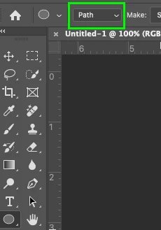

Correct - change the setting to use a path isntead of a shape to stroke.
Shapes can be built as paths if set properly:

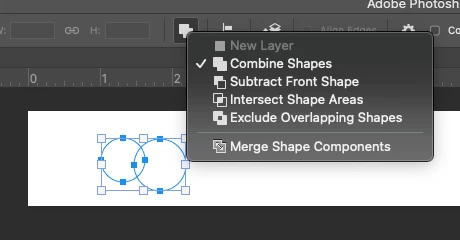

Your issue about not being able to use the shape builder when working with a path is not completely true either. Paths can be combined, etc. when selected:
