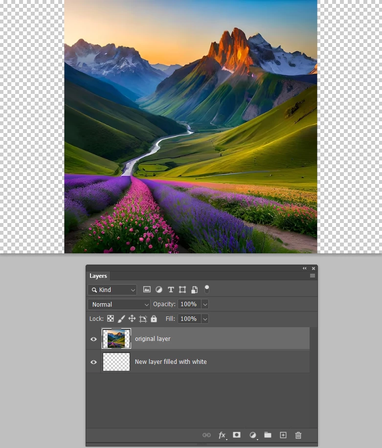

How do I get a white background when I expand a canvas? I get a black and white grid. I want to use the Text tool here but it doesn't show on this grid. I've been using this option for a while, but suddenly the white background doesn't show up.

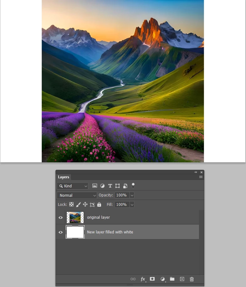

The grid you are seeing represents transparency.  You need add a new layer beneath the background layer, and fill it with white
With white added to new layer
