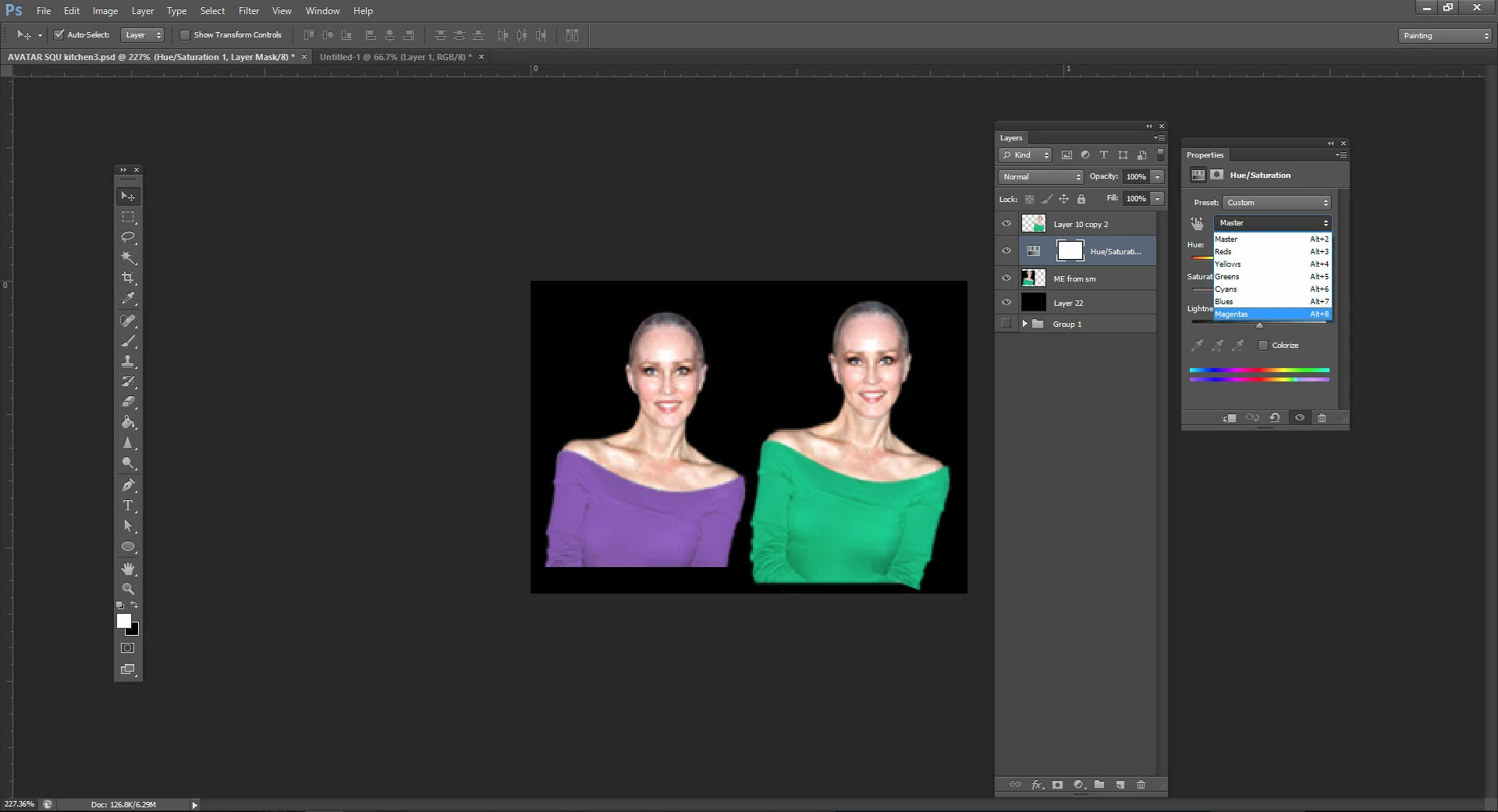

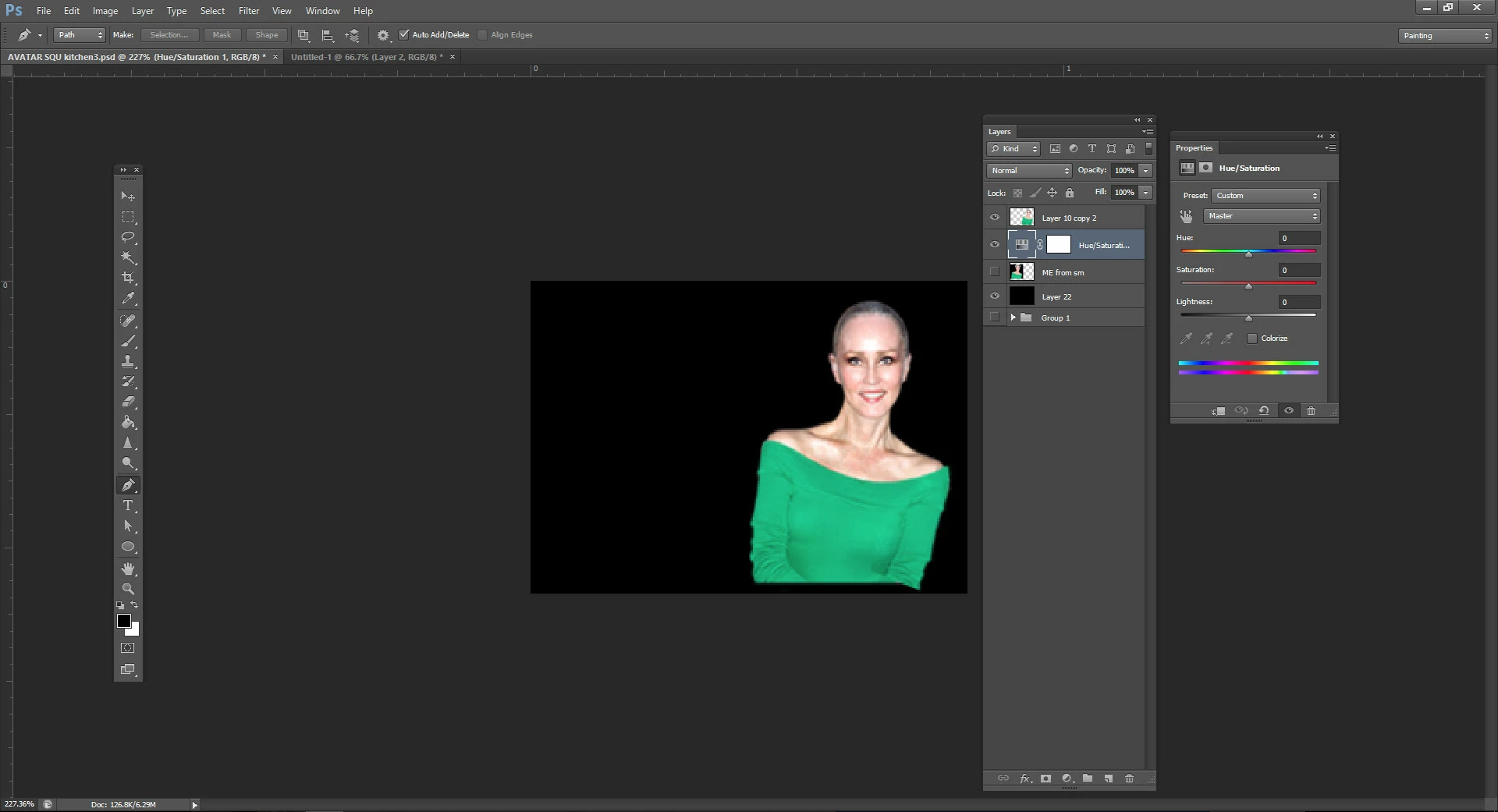

I work in CMYK, and am very familiar with the issue of duller colors. You can often improve them by going Image>Adjustments>Hue/Saturation. If the magenta is not on its own layer, you can do this with an Adjustment Layer:
-Layer>New Adjustment Layer
-In Properties, choose "Master"
-From the dropdown list, choose "Magentas" and play with that
In my example below, the result isn't magenta, I know! This is from something I did yesterday:
