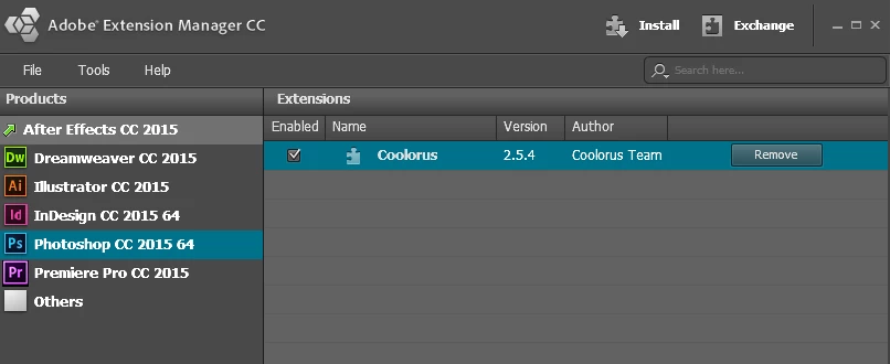

    The Extension Manager is picking up on new installs and Coolorus just released a zxp that works with CC 2015
    If that does not work, there are instructions for a manual install included in the 2.5.4 download.
    So for whatever extensions you have, you have to wait for the maker to set it up for Photoshop v. 16 (CC 2015)
    Fonthero for example is at 15.2-15.9 and won't be installed for 16.0

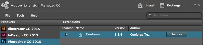

    That's interesting, since on my mac 10.10.3 the extension manager cc doesn't list any of the 2015 applications.
    Which version of the extension manager cc do you have?
    gener7
    June 16, 2015
    I'm away from my macbook,  Kelly. What I did was to open Bridge and launch "manage extensions" from there. That's when I noticed the cc 2015 apps showing up.
    I also restarted my macbook.
    Maybe that's what is needed. I know I have the latest cc extension manager from last year
