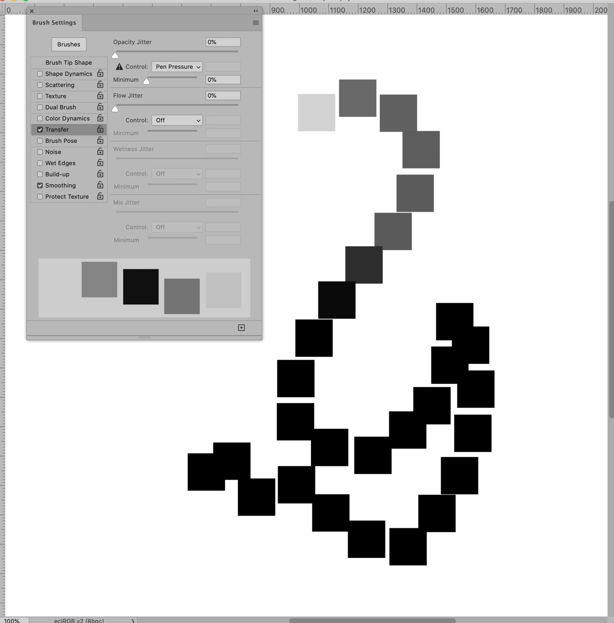

First of all, Adobe seems to have broken pressure sensitivity in the latest release, so, until they fix it, you'd need to roll back to an earlier version via the Creative Cloud desktop app.
You can, though, see it work in v21.1.2 by making a Path, and Stroke with the Brush from the Paths panel, with the simulate Pressure box checked.

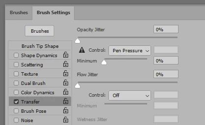

That aside, you set it up this way. In the Brush Settings panel, select Transfer, with Pressure as the Control.
