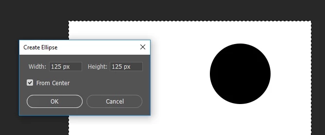

  Whenever I'm trying to create an ellipse in Photoshop CC I get a popup window titled "Create Ellipse" that asks for the Width and Height of the ellipse and has a From Center checkbox.  This is new behavior for Photoshop which didn't exist in CS5.  It's really annoying when I want to put down 50 circles of the same size.  How can this popup be disabled?

    I agree, the default 100 pixel circle is very annoying. Try this in the Shape tool options, in the little cogwheel drop down, select "Fixed Size", and enter the size in the appropriate fields. Then, Click and drag ever so slightly (all in one step). This will create your shape at the proper size. Unfortunately, you will need to position it again, due to the Drag step.

    Click hold and drag out the ellipse you want? If you just click and release you will get the ellipse dialog.
