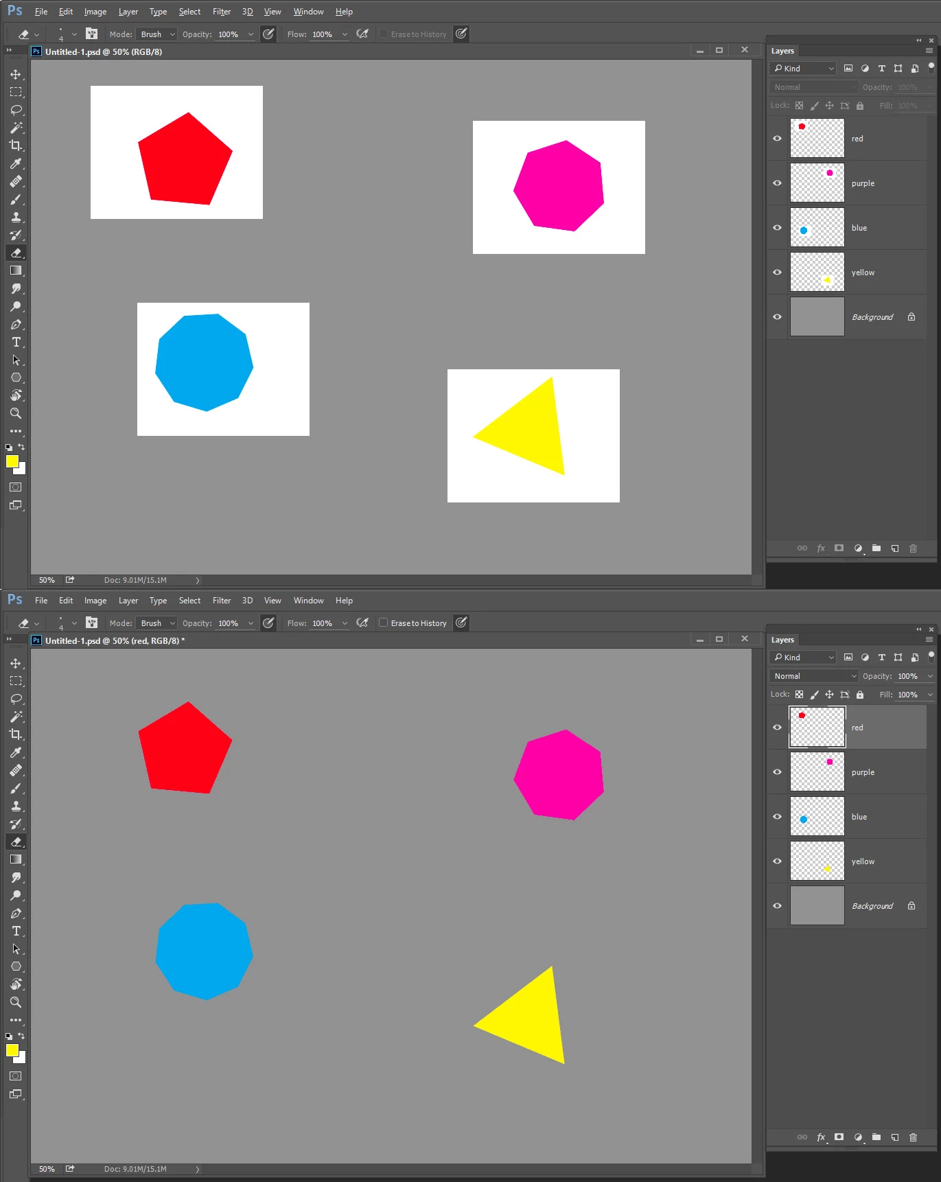

If Trim using the top left or bottom right corner do not work adding a white pixel there may not work either.  I do not know how trim works or how much tolerance it may use.  I would suggest trying to simulate a trim with some high tolerance using the magic wand. If its a background layer image. Convert it to a normal layer and  add a white layer under that layer the use the magic wand tool to select contiguous pixels sampling areas on the boarder of the canvas  invert and clear pixels on that layer.  Do this several time sample different point about the canvas border,   Then get the layer's  bounds and crop the canvas to that layers bounds..
I wrote a script something like that to trim layer that have borders there was no cropping done.
