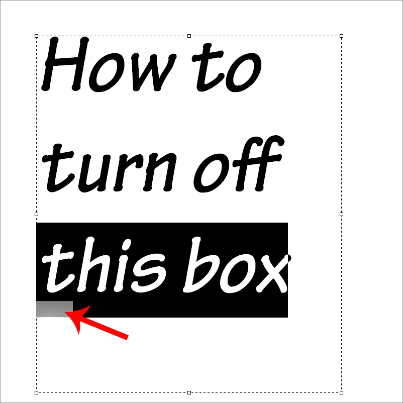

I recently had to reset my preferences and I've been manually configuring settings back to how I had them.  I have no idea what the box indicated in my screenshot is, though, and I'd like to remove it.  I've already turned off the Glyphs popup, but this box is still showing.  I'd appreciate any help to get rid of it.  Thanks!

I see the same here and it appears when alternative glyphs are available in the font for the type highlighted. If alternative glyphs are enabled in preferences then hovering on a letter shows those individual alternatives. The grey box though appears whether the preference is enabled or not.

I have figured out that the box is font-specific.  It doesn't appear for most fonts, but it does for some.  I'm not sure why it doesn't go away when the glyph alternates are turned off, but it will be a non-issue for me most of the time.

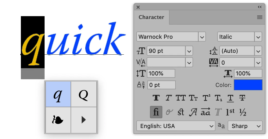

jane-e
June 24, 2021
Hi @nrz0

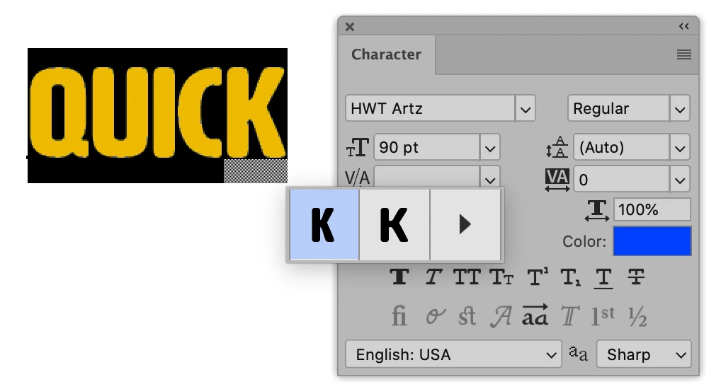

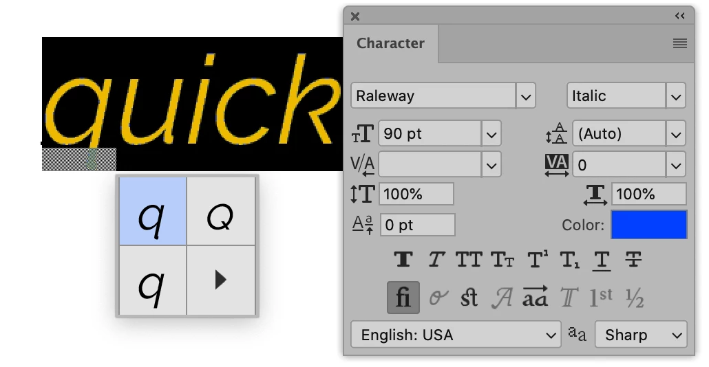

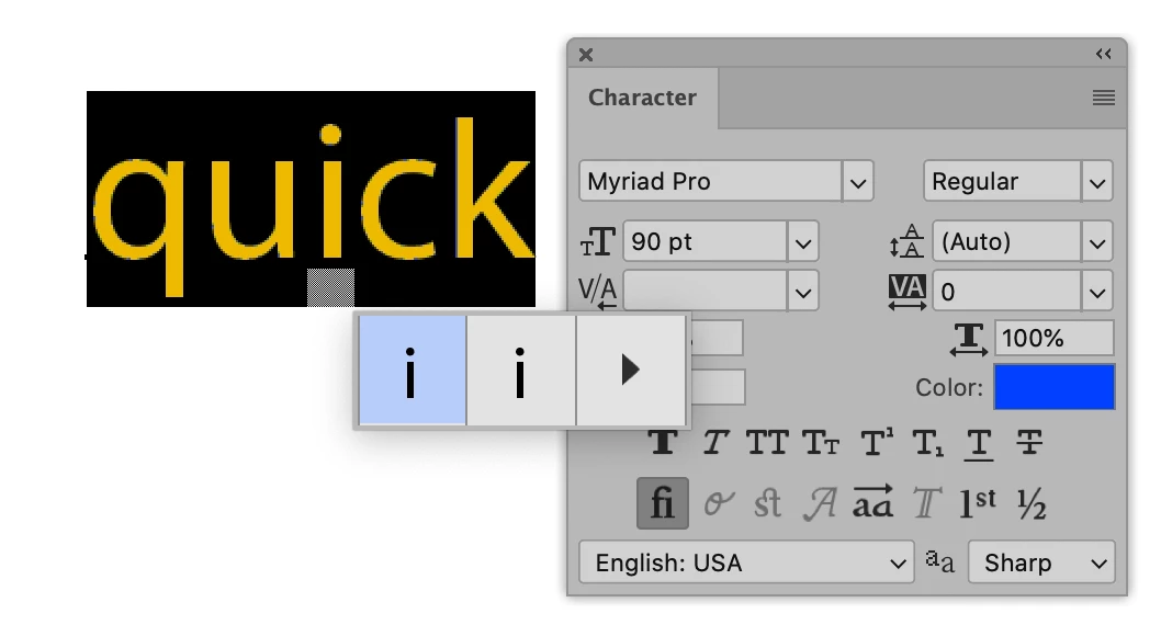

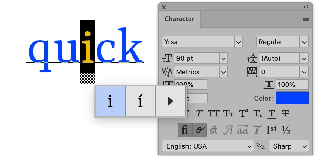

Some typefaces do not have glyph alternates at all. Others have alternates that vary with the specific typeface, depending on what the type designer decided to design. Here's the same word with different glyph alternates.
I didn't think dark mode or autofill would have any effect.
If you are curious, try this:
  • find a typeface where the gray box does not appear
  • enable the checkbox to show the glyph alternates and look again
  • do any glyph alternates show for that typeface?
I'm going to guess "no", but I could be wrong. I think the typefaces where you don't see the gray box don't actually have alternates built into them (at least not with the letters you have typed.)

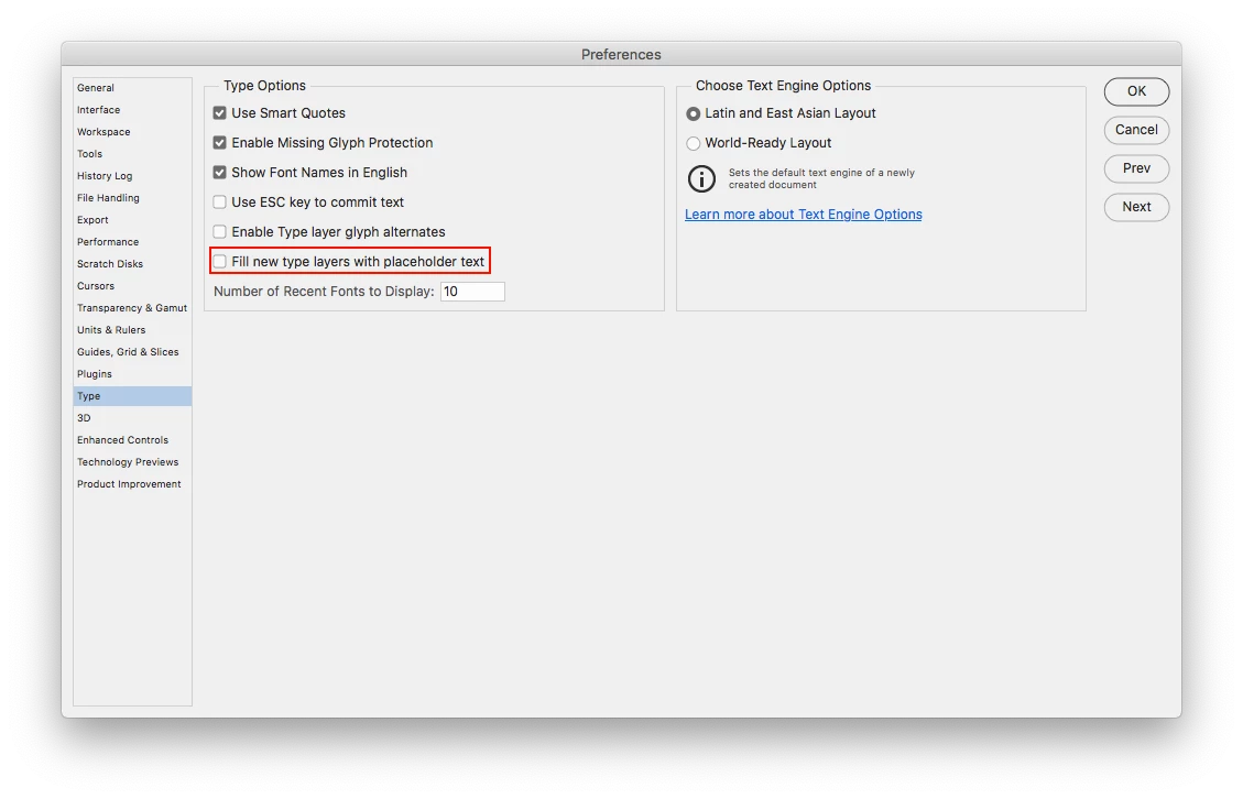

Jeff Arola
June 23, 2021
See if going to Photoshop>Preferences>Type and unchecking Fill new type layers with placeholder text solves the issue.

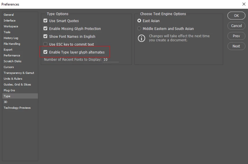

Prefs > Type > Uncheck Enable Type layer glyph alternates.

Hi, Jane, thanks for your post. I had already unchecked that box. That's what I meant when I said "I've already turned off the Glyphs popup". Any other ideas?
