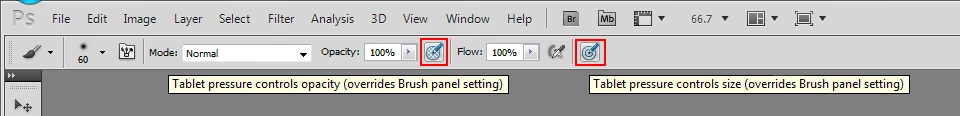

Disable the Pen Pressure button from the top.

I wanted to retouch using the healing brush and it kept changing size with pressure, even if I turned it off via the button in the top bar designed for this.
After trying all sorts of stuff (Wacom settings, Windows Freehand and so on) I found that on the very bottom of the brushs window (the one you get from the top bar too) there is a drop down. I changed it to not use pen pressure for size and now the buton works as it should.
The brush doesn't use pen pressure for size unless I use the button to override this setting. Even makes sense now.

Jeff Arola
July 22, 2012
If that happens again check the override settings in the tool options bar.
One overrides Opacity and the other overrides Size if they are enabled.
