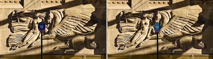

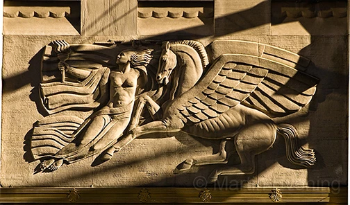

I thought you would also be helped by the following. It is based on shifting vantage points.
If, at the time you take the photograph, you know that there is an obstruction you plan to remove from the final image, you may consider the following technique, pictured in a book by Martin Evening, a noted photographer and author.
Take the first off two photographs. Move sideways so that the obscured area in the image (hidden by the bus stop) now appears in the viewfinder and a neighboring area is obscured. Take the second photograph, as shown in the images below:
(Edit: A longer than normal focal length lens seems to work best.)
Then, in Photoshop:
1. Open both picture files. Put one image over the other by clicking on one image in the Layers panel and dragging the layer over the other image.
2. You will notice that the top layer is highlighted in the Layers panel. Highlight both by holding down the Shift key and clicking on the layer below.
3. Choose Edit > Auto-Align Layers > Auto and click OK. (Extra goodie: If, in making the two exposures, the zoom lens on the camera moved, Photoshop will recognize the difference in object sizes and automatically adjust them to coincide.)
4. Click on a clear area in the Layers panel and then click on Layer 1 to highlight only Layer 1. Then add a layer mask to Layer 1 by clicking on the symbol to the right of the fx at the bottom of the Layers panel.
5. With a hard edged brush, paint in black on the obstruction in the image in this case, the bus sign and pole. (You are actually painting on the mask.)
6. Choose Layer > Flatten Image. The end result is shown below.
