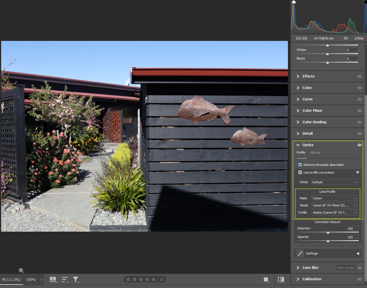

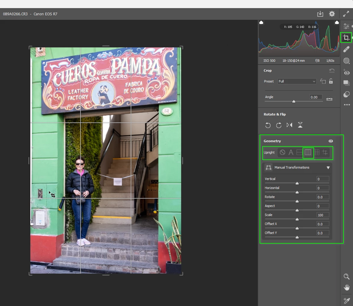

Reading your post again, I am thinking you are talking about straightening curved, or bent lines.  Is that closer to what you are after?  If this is a building, then Camera RAW > Geommetry is your forst step.  Actually it is your second step, because Optics > Lens Profile is the first.
They have moved Geommetry to the Crop tool now, and it is not as I remember it from when I used to work as a photographer.  For iinstance there used to be a Barrel distortion correction, which I am not seeing.  Is this closer to what you need?
