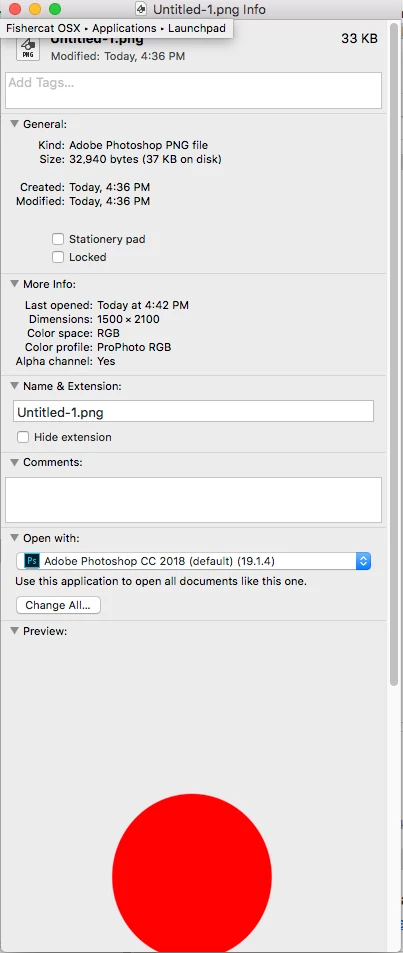

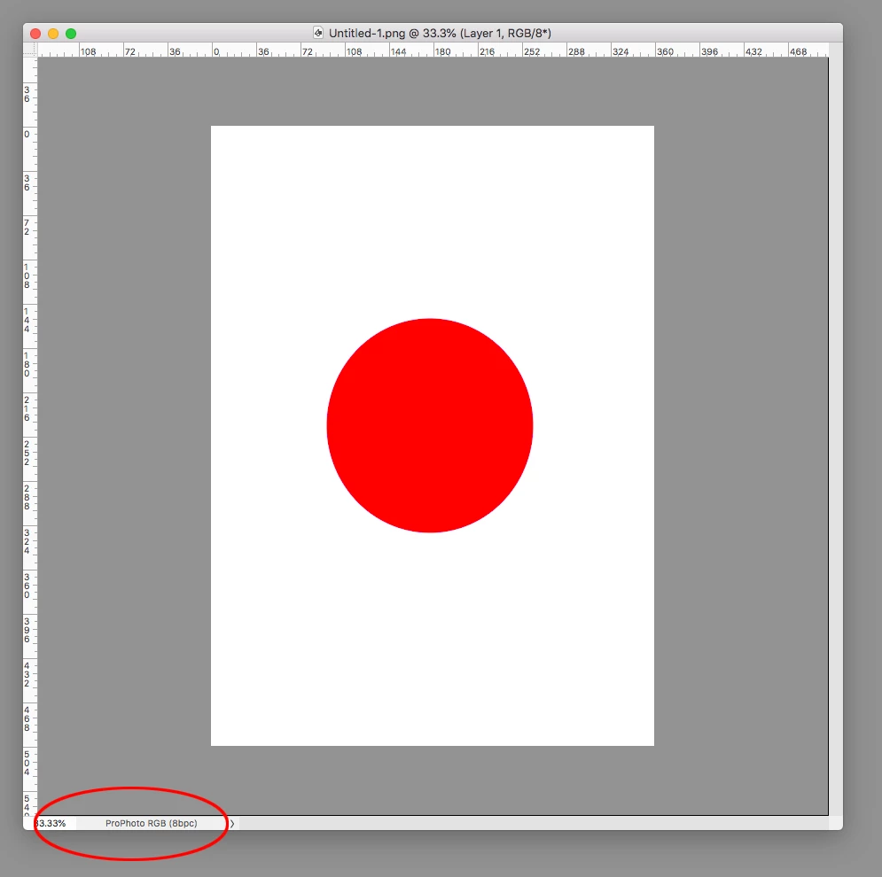

    I wonder if that's an OS problem? On OSX if I open the Save As... png I placed in InDesign, Photoshop shows the correct assignment:
    OSX's Get Info also shows the profile:
