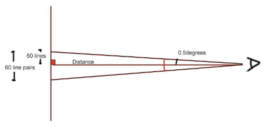

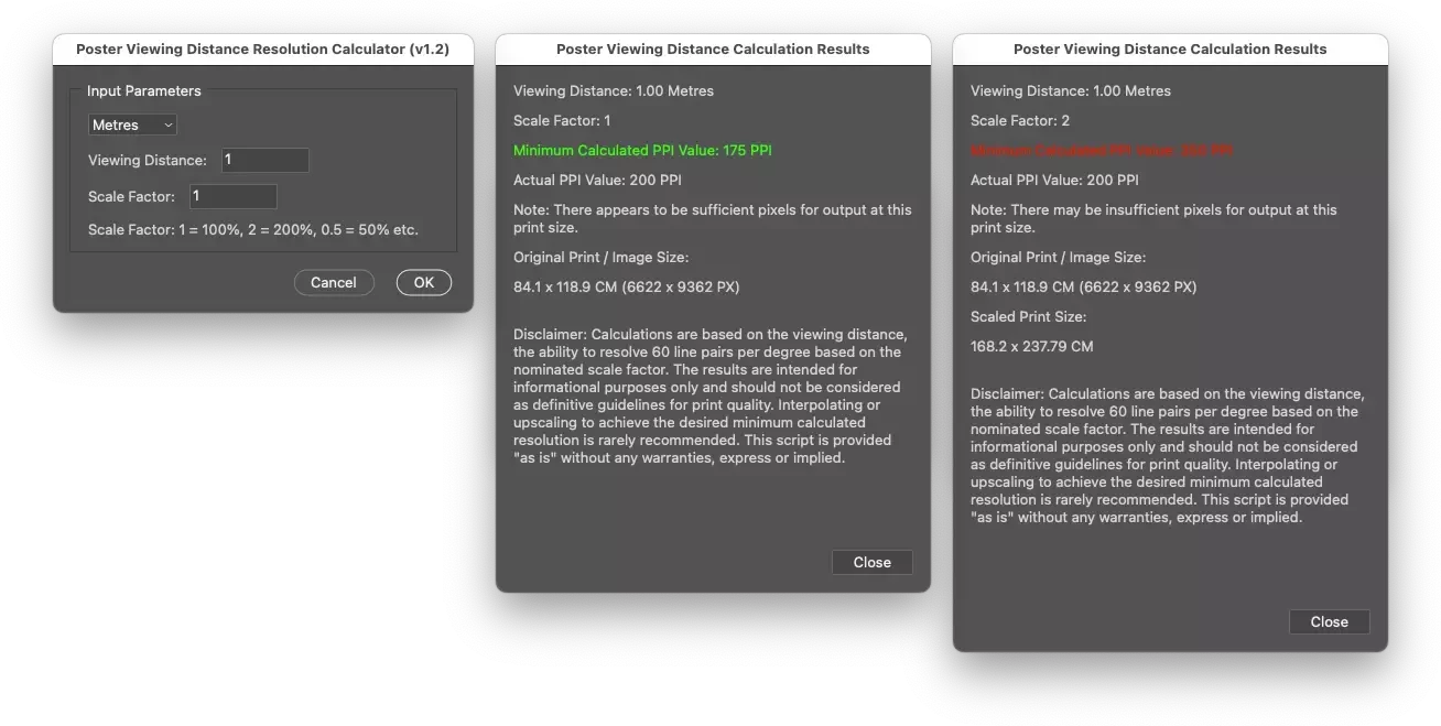

    davescm
    Feb 16, 2026 12:24 PM UTC
    A bit of math for those that insist they can still tell the difference (I’ve posted this before in the old forums).
    A good human eye can resolve 60 line pairs per degree i.e. pairs of black and white lines.  So in half a degree that would be 60 single lines.
    Simple trigonometry means that the width containing those 60 lines can be calculated by:
                   Width of 60 lines = Viewing distance x tan(0.5°)
    Knowing the width for 60 lines (or pixels), how many lines per inch can be seen by using 60/Width of 60 lines can be calculated.
    So putting those together gives :
    maximum visible ppi = 60/(Viewing distance x tan(0.5°)) = 60/(Viewing distance x 0.0087269) = 2/(Viewing distance x 0.000291)
    Or
    maximum visible ppi = 1/(Viewing distance x .0001454)
    Or
    maximum visible ppi = 6878/Viewing distance
    So as an example, for a print viewed at 36 inches, ppi = 6878/36 = 191ppi. Anything above that is wasted as even good eyes will not resolve it. In practice, we do not print black and white lines so the real world requirement is even less as shown in the video Trevor linked.
