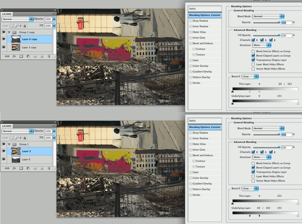

Some time ago someone in the MacIntosh-forum declared their wish to use a layer’s Layer Style Blend If-setting’s result as a mask (for whatever reasons).
The »This Layer’s« effect is easily enough converted to a mask by grouping and flattening the layer and using the resulting transparency.
But the »Underlying Layer«-setting seems more difficult (naturally as they depend on other layers’ content).
Is there a way to get the current (for an RGB-file 32) numbers of a layer’s Blend If-settings with JavaScript?
Or is there a way to reset the This Layer-Blend If-settings, but leave the Underlying Layer-settings unchanged?
Any help appreciated.

What I’m after (and mainly for the challenge, not because I have an actual need for it at the moment) is getting the the same effect as the applied Blend If-settings through masks on a non-blend-if-layer (and I’m aware that they are then no longer »live« so to speak).
Anyway, I was operating under the assumption that one could produce an identical result when resetting the formerly top-layer and putting it below the other one and applying the inversed Underlying-settings as This Layer-settings to the newly top-layer.
Unfortunately that seems to apply only for the Gray-settings, but when the other channels are modified it doesn’t hold true.
So, even if it might not be any help here, I would like to know how I can get the values in a layer’s current settings.
