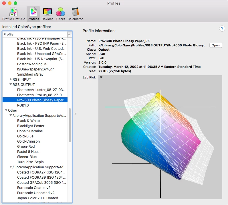

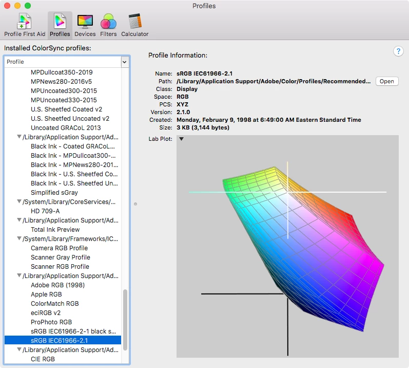

Here's a 3D plot of the sRGB (a typical standard display) gamut:
Here's a comparison of sRGB to an Epson inkset printing on glossy paper (sRGB is the white plot), The 2 spaces’ gamuts intersect:
The same Epson profile compared to ProPhoto RGB. The Epson space sits inside of ProPhoto:

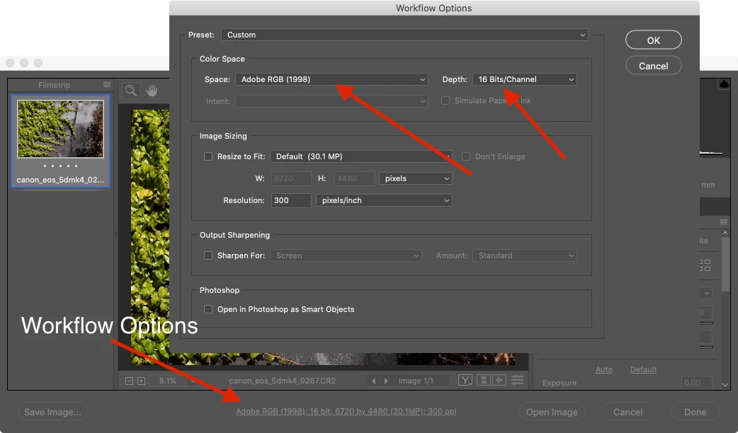

Hi, You can set the format for opening RAW images in the Workflow Options of Adobe Camera Raw.
--Susumu Iwasaki

A raw file doesn't have a color space until it's encoded into one in the raw converter (ACR/Lightroom). Only RGB files have color spaces. So you can't do that.
You set your color space preference in ACR or Lightroom. Then, when the file opens into Photoshop, it will be in that color space. Not before.
In ACR you click the blue "link" below the main image window. In Lightroom you go to Preferences > External Editing.
