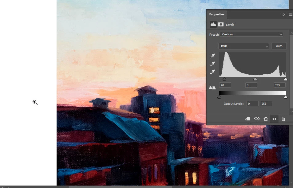

I just tested and it works to record single step action then to batch process. The only requirement is that you must have always black color in top left or bottom right corner, in other words all your images must be either as example 1 or as example 2.
Update: based on @r-bin suggestion which seems to work to avoid tiny black border, record additional step with black point set to 20 in Levels adjustment layer as shown on screenshot below, it does work for tested single image, test with random chosen image or try to find consistency like single pixel black border then record step to delete that border, you can use conditional actions to check orientation of image.

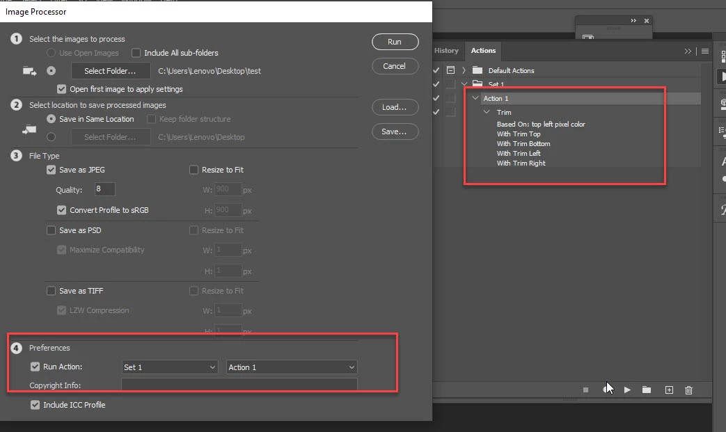

After recording single step action run File > Scripts > Image Processor and check Run Action then choose proper set and action in section 4.
