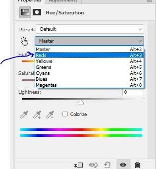

    3. Go to your panels and click where it says "Adjustments"
    4. This will open the adjustments panel and you need to click on the symbol below to add an Hue/Saturation adjustment layer
    5. If you look in the layers panel you will see an adjustment layer has been added (the black next to it is a mask and will ensure that your adjustments will only be applied to the area you selected in step 2
    6. Go to the properties panel and you will see the controls for that adjustment layer
    7. Where it says "Master" click and from the menu change that to Reds (or Greens if you are getting rid of Green eye in pets)
    Now slide the control sliders.
    Hue will change the colour, saturation will change how vivid that colour looks and Lightness does what it says.
    Watch the eyes when you are doing this and you can change them to whatever you need
    For example in my image:
    or at the other extreme :-)
    Hopefully that will help you
    Dave
