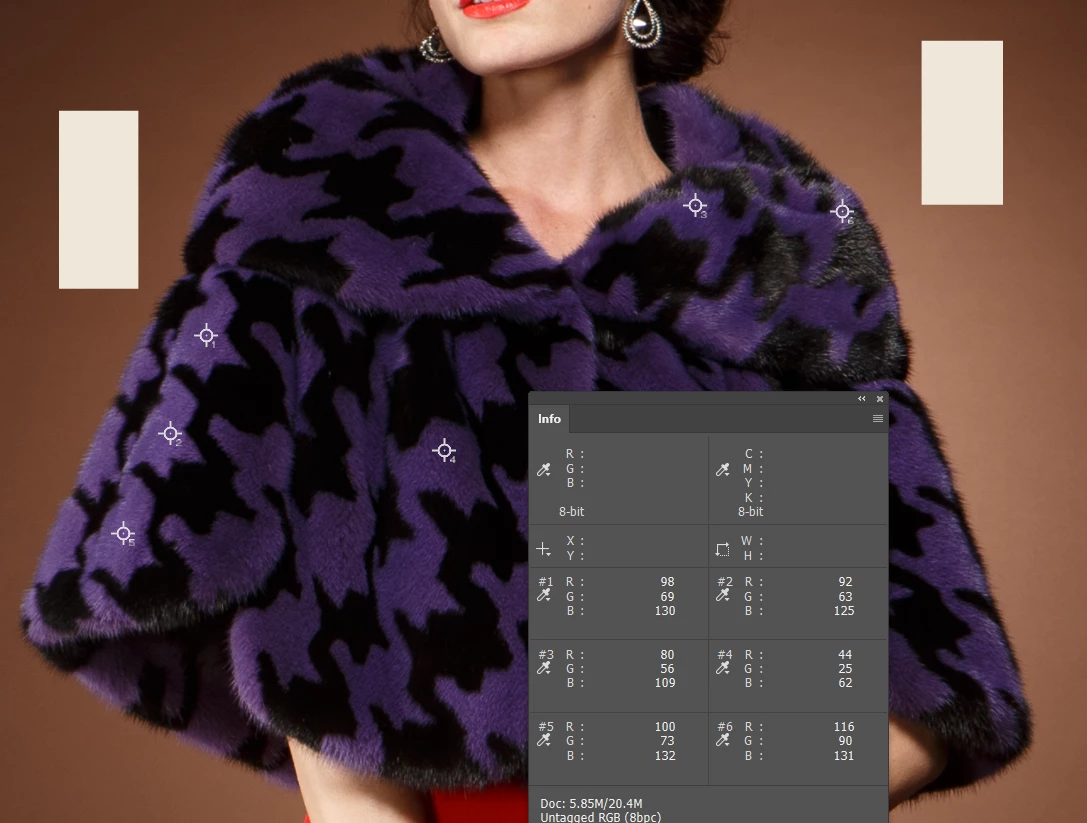

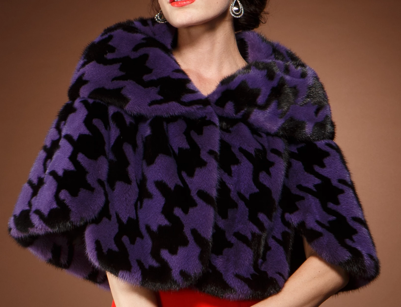

I have an image where I need to change the color of the jacket from purple to a much lighter color: #eee7d9
I tried using solid color and then blend to color but not really getting what i am looking for. If I use Hue/Saturation I could maybe reach that color shade but it needs to be the exact one. I feel like im missing a step here, as I dont really do this on a regulr basis so I am a bit like a fish out of water. Thanks in advance!

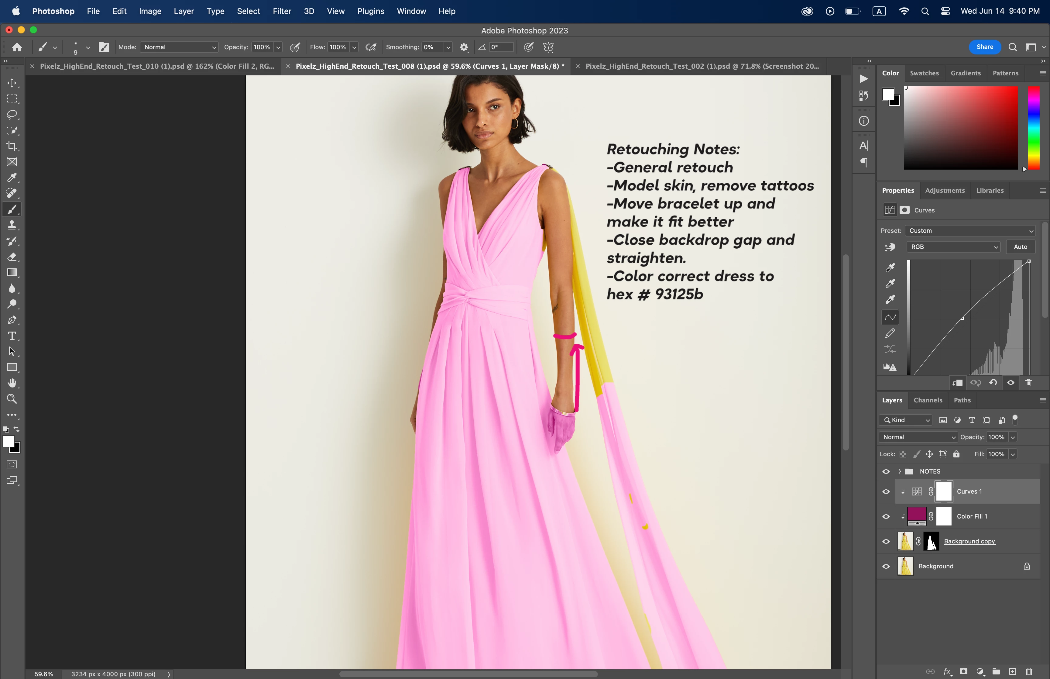

Thank you all for the replies. Ok well this might be a dumb question but if a client requests a specific color code, does it mean it has to EXACTLY that when they use the color picker or do I have the option to actually now adjust brightness etc to match it as close as possible. Like here is a super quick masking just to show that the HEX purple and that same applied on the dress are different colors (obviously lighting, material etc all take effect). So do I send it as this OR i start adjusting to visually make it look more like the purple in the color picker?

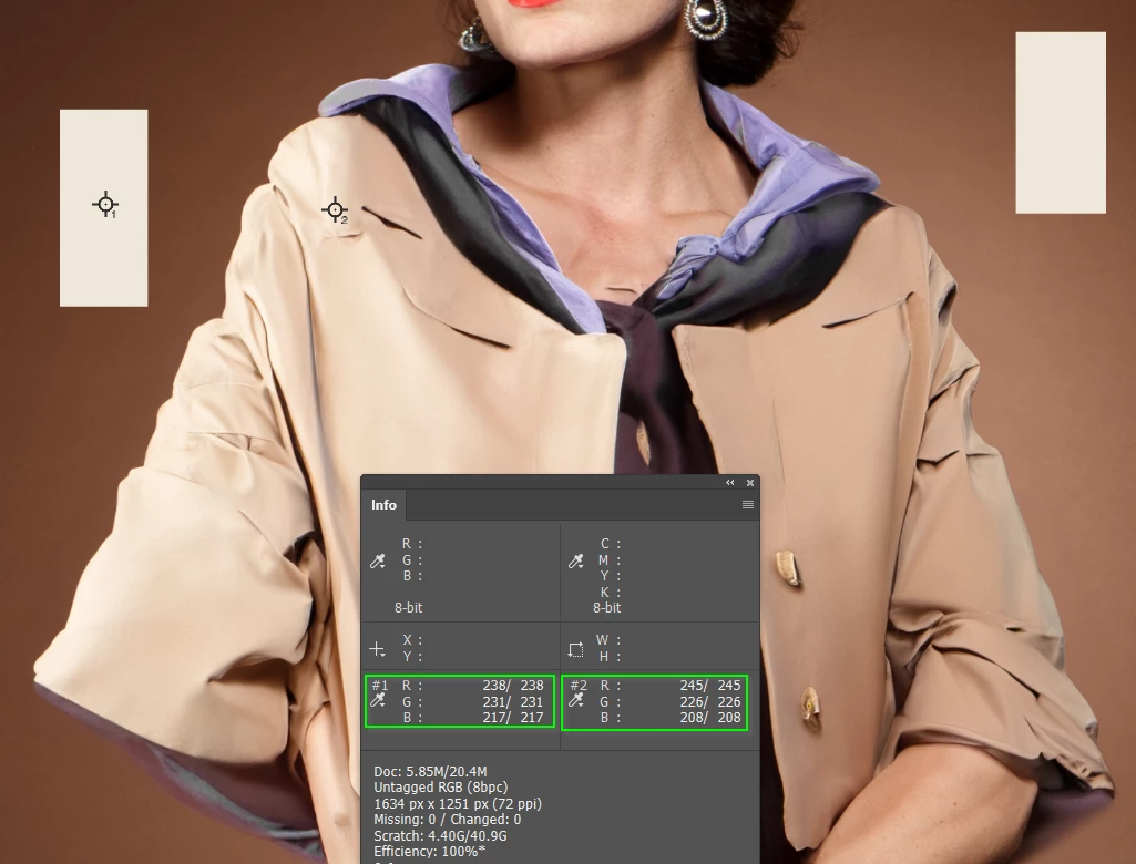

I set the Solid Color layer to the same HEX value as the bg, but in Color mode.
I then tested at which gray value the folder looks exactly the same as the bg.
This turns out to be #626262, so I guess a spot with that "Luminosity" on your model/clothing should look exactly the part.  Just a guess, as this stuff can get confusing easily...

I went as far as loading the image and made a pallet with the #eee7d9 code, and immediately thought this is not doable without a ton of time and work, and that even then, the results might not be great.  What I usually do is add a bunch of color sample points, and move the Info panel into a convenient position, and then select with color range, which hopefully means using a Hue/Saturation layer.  Then make the adjustments watching the sample values, which will update in real time as you try to match all points to sample #1.
It's not there yet, but I think Dag might be right saying this could one day be done with Ai.  I made a selection ever so slightly larger than the jacket, and used Pale beige jacket as the prompt, and look how close it got the colour with only a vague text description.  OK, it's not the same jacket, but it seems to me that if Gen Fill can work the magic we are seeing in a beta version, then swapping to a designated color can't be too far away.

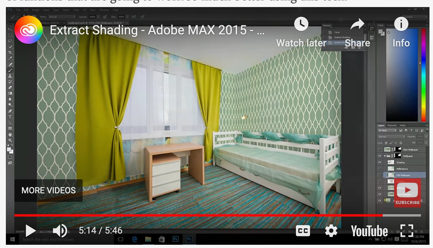

Do you remember the Extraxt Shading Sneak Peek from MAX in 2015?  I was so exited about that asit would be game changing for composite building, but it was apparently too hard and it fizzled out.  Well how hard would that be with the power of Ai now?  There must be a ton of funtions that are going to work so much better using this tech.

I remember that Sneak, @Trevor.Dennis , and how it did not change the wallpaper above and below the window where it was partially covered by the sheer curtain. See 5m46s. It would be great if AI can do that now!
