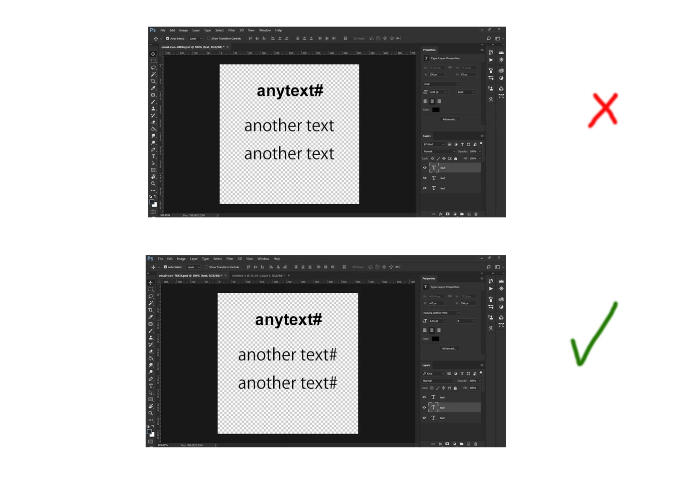

i need to change the content of all selected Text  layers the same this image ..i`m wrote the code but i can`t make chance on all text layers
if (app.documents.length > 0) mainScript();
function mainScript() {
    try{
        var myLayerName = activeDocument.activeLayer.name;
        var myLayerText = app.activeDocument.activeLayer;
        myLayerText.name = myLayerName + '#';
        myLayerText.kind = LayerKind.TEXT;
        myLayerText.textItem.contents = myLayerText.textItem.contents + myLayerName;
    }catch (errStr){
        alert(errStr);

This script should work for you...
https://raw.githubusercontent.com/Paul-Riggott/PS-Scripts/master/Layer%20Name%20Edit.jsx
If you are using Photoshop newer than CS6 change this line:
var myBrush = g.newBrush(g.BrushType.SOLID_COLOR, [0.99, 0.99, 0.99, 1]);
to
var myBrush = g.newBrush(g.BrushType.SOLID_COLOR, [0.5, 0.5, 0.5, 1]);
or just remove this line.

var myDoc = app.activeDocument;
var myNumber = myDoc.layers.length;
for (var i = 0; i < myNumber ; i++) {
var myName = myDoc.layers.name;
if (myNumber - i < 10) {
myDoc.layers.name =  "" + myName + " #";
if (myNumber - i >= 10 && i<100) {
myDoc.layers.name = "" + myName + " # #";
if (myNumber - i >= 100) {
myDoc.layers.name = String (myNumber - i ) + "" + myName;
See if this is good for you.
October 4, 2018
You will have to loop inside selected layers, not all first level layers.
Besides, a test has to be performed on current layer kind to ensure it's a text layer, because the OP would like to modify layers's content, not name.
I would try to post a script if I knew how to loop inside selected layers...
