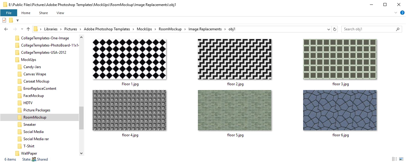

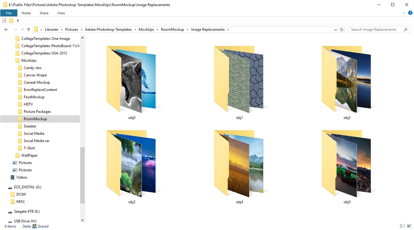

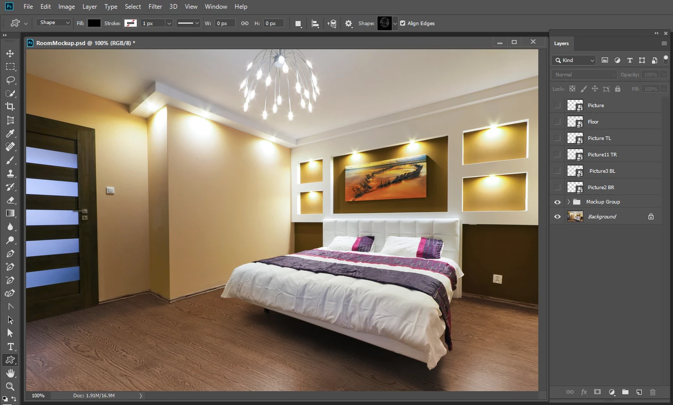

Here is an example mockup template that has 6 Smart Object that will be populated with replacements Images. 5 wall hanging images and floor replacement. Each Smart Object that need to be updated need to has a  folder of  replacement files. So there are 6 input image replacement folders required.  If a had 20 room designs there could be 20 Template in the mockup templates folder
All the template would have the same 6 object layers input replacement image available. However, the templates  may not need all 6. Perhaps just a main room wall picture and a floor.  May be requited.  Each room's visible smart object layer will transform the replacement for its room design.
The only problem I think you will have is knowing you need at three smart object layers in some of your templates  to be able the handle image with the different aspect ratios the you seem to have in some templates.   Only the smart object layer that has the correct aspect ration replacement need be visible. All you portrait image have an aspect rate close toe each other.  It looks like you may have two different landscape image aspect ratios in your emplate collection

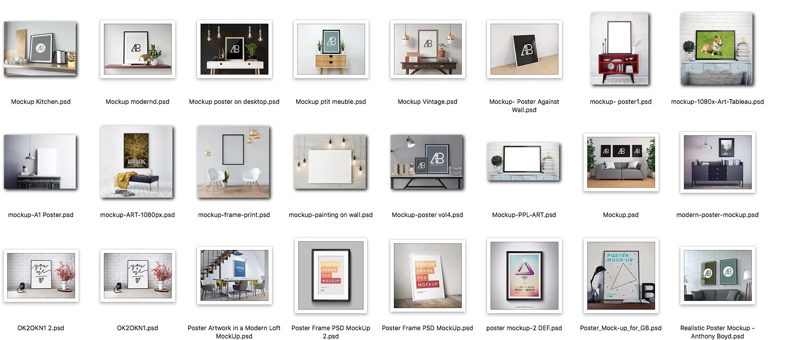

I see your example but in my case each mockup is separate not in one mockup regarding my collection it's just a sreenshot of course if I success to make script work I will separate for Landscape view mockup and Portrait to avoid problem. For my need I will most of time doing max 50 different designs on each mockup around 20 is enough.
So 1 design give me 20 mockup at the end then I have enough choice for my future needs.

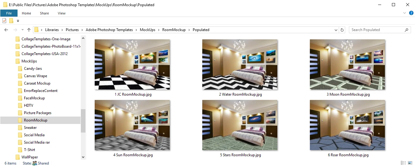

If the Template comply with my four Mockup Template rules there a chance the BatchMockupTemplates.jsx Script in my package will be able to populate  your 20 mockup in a single execution.  It has been able to populate 84 Mockup with 41 label designs, That is 3,444 output files.  Each template only needed one smart object updated. The script took around 5 hours the save the 3,444 populated mockups. Free Photoshop Photo Collage and Mockup Toolkit

My mockups look like this don't know if I can use your script with or I record action making one by one mockup then do it in batch for the folder not sur it's the best approch I'm very newbie for this !
