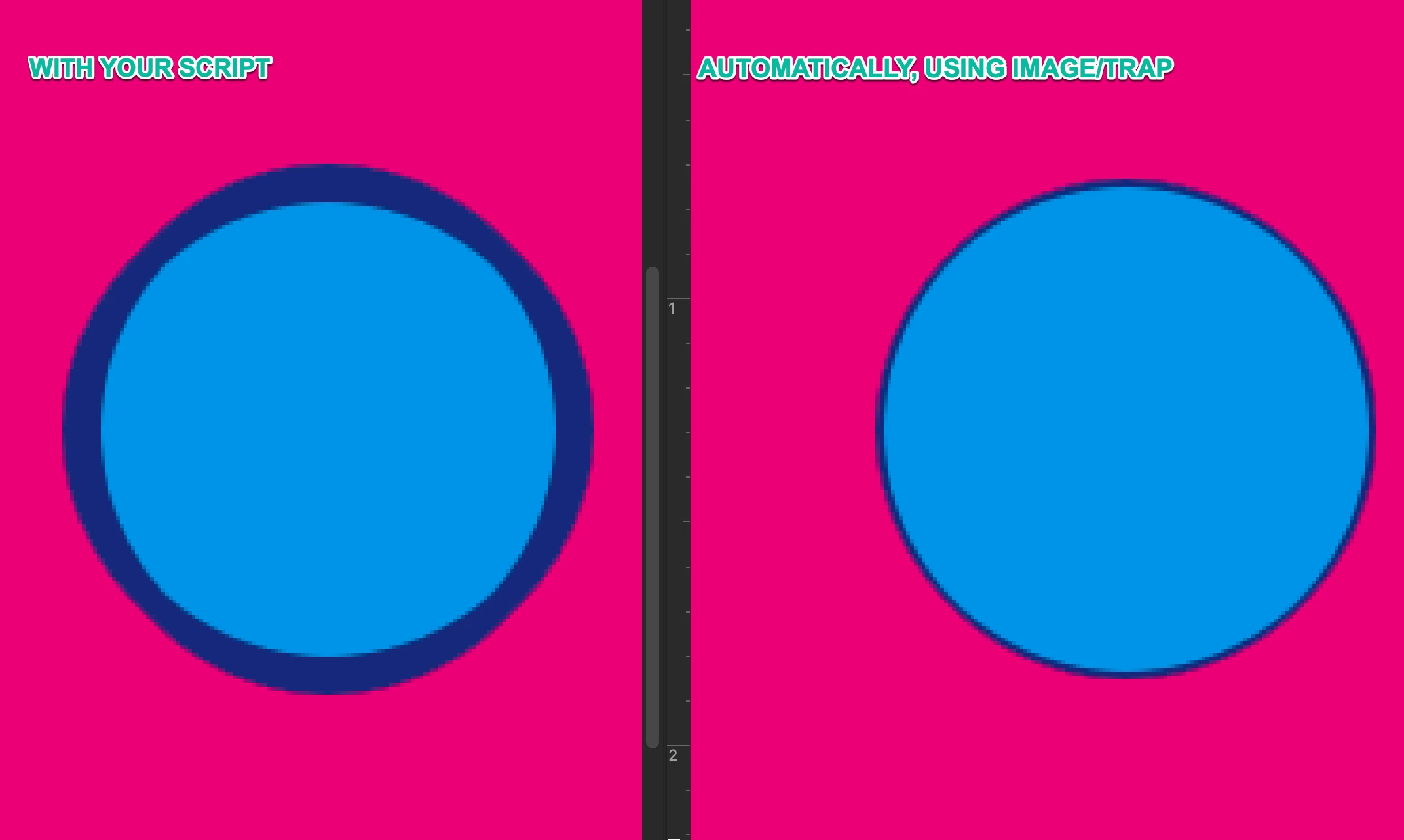

Hi @rob day  Thank you for your dedication, I like your solution but result of your script looks like 2mm trap, not 0.2mm.
Could you improve this? Also, is it possible to use (or to adapt) yours code for MULTICHANNEL mode?

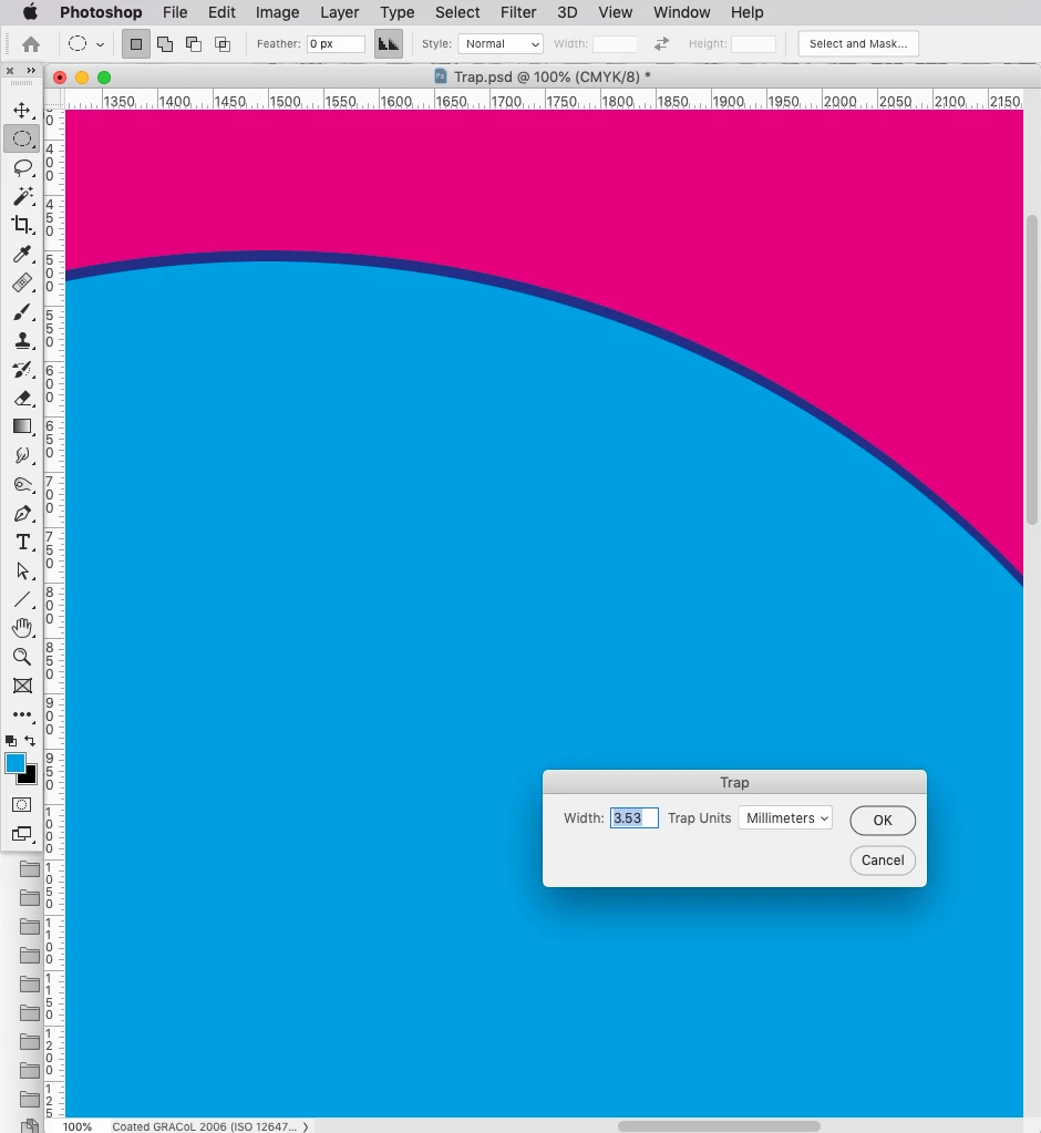

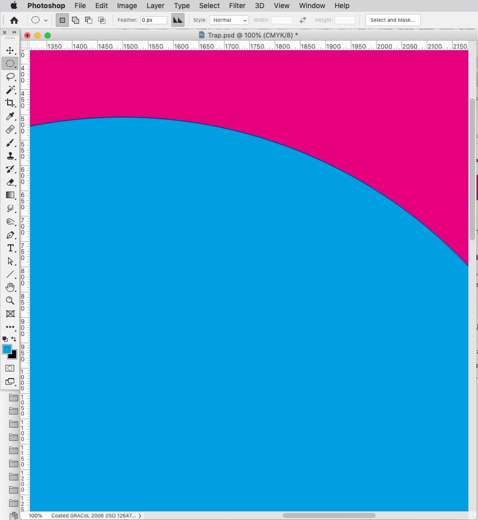

I noticed that the Trap Units setting is sticky, so my script won’t work if you run it after a trap has been created with the UI using Millimeters as the unit, but will if the last applied trap’s unit setting was Pixels.
There doesn’t seem to be a way to specifically set trap units before running the trap method with the API, and setting the ruler units doesn’t seem to matter. Here’s the method description—it should work so it seems like a bug:
Photoshop ExtendScript API Adobe Photoshop CC 2015.5 Object Library - Document
With the trap units set to the default pixels, I get this running the script:
But running after a manual trap using Millimeter trap units I get this:
