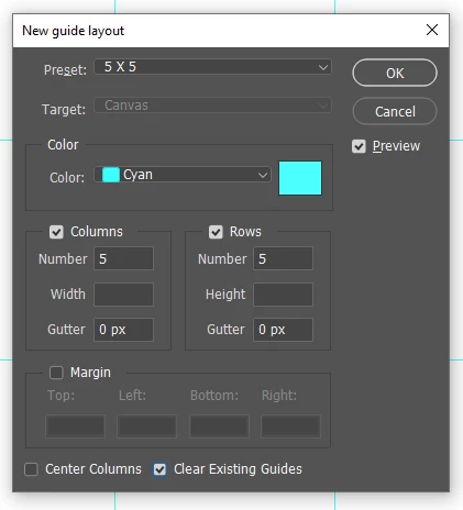

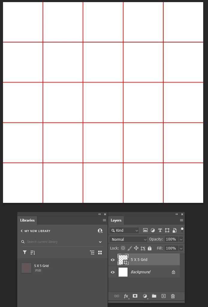

A slight variation
Make a New Guide Layout. Save with a meaningful name if you like to make it a preset.  (It will easier to use in an Action if it is a saved preset.)
Make your grid using the Line tool.  The line will snap to the grid.
I made one line; copied it three times and space them out using Move > Align.  Merged the layers, copied again and rotated 90°. Merge one more time and you have a vector grid.
What I suggest you do at this stage is open the CC Libraries panel. Make a new library with a meaningful name, and drage your grid to it.
That grid can be dragged onto any new document with square dimensions, and dragged to fit.  CC Libraries are super useful.

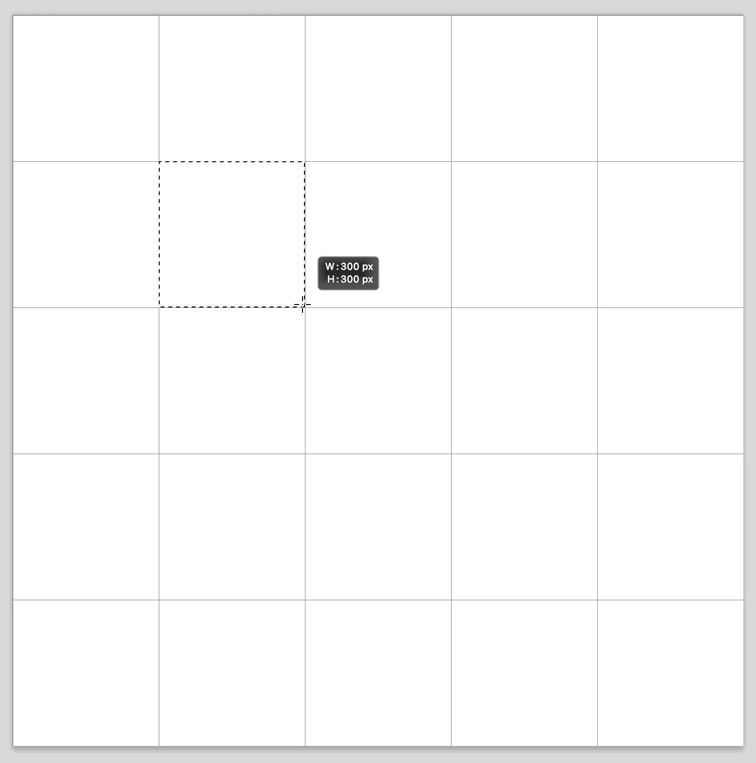

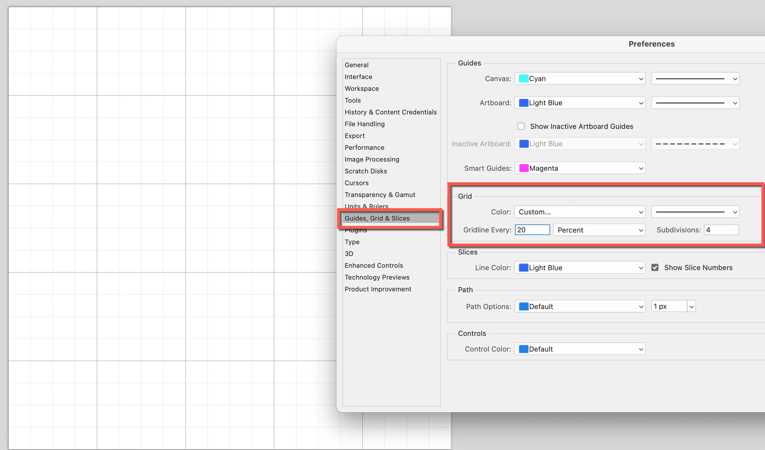

@kirbydoo
Can you show your settings in Preferences > Guides, Grids, & Slices? Here I have 20%. You can set the subdivisions higher or lower — setting it to "1" will leave only the larger grid.
Each section is 300px x 300px.
Jane

In addition to Bojan's method, you can also set the grid to %.
I use both methods depending.

Have you tried View > Guides > New Guide Layout > use Columns and Rows without Gutter (delete value or type 0). This will create guides which you can lock using View > Guides > Lock Guides. To show/hide guides use Ctrl + H keyboartd shortcut. I do not think you can control order of guides, they will stay on top, otherwise guides will lose purpose.
