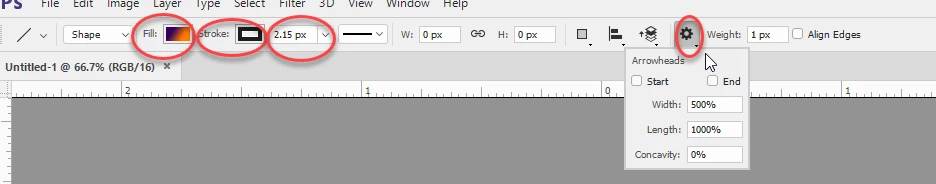

For the line :
With the line tool selected go to the options bar.
Set the fil - Stroke - Sixe and arrowheads as required
Then draw your line

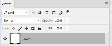

For the background :
In the layers panel click on the lock symbol to convert from background layer to Layer 0
Then Ctrl+A to select all   -  then press the Delete key to delete the background

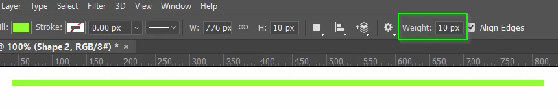

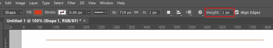

Trevor.Dennis
July 21, 2017
Adding to Dave's comment, you need to use the Weight field in the Options bar to set the line thickness
