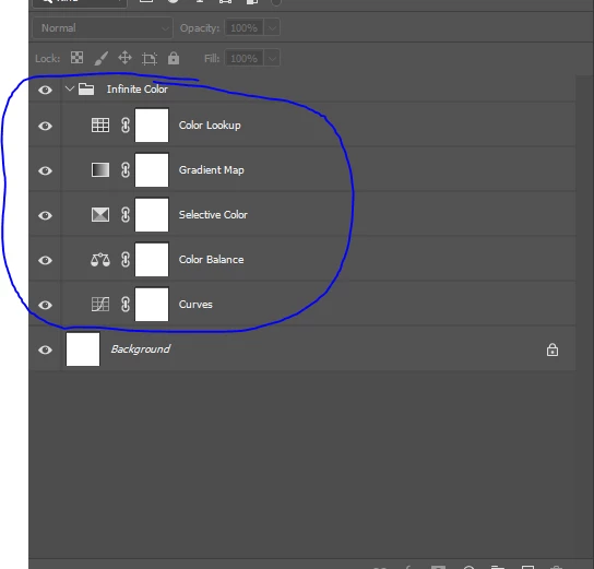

Is there a way to create an action to copy adjustments ( Curve, level color balance.....) from a document
containing images that I have Color Graded?
I want to create an action to batch from the "Adjustment" method I did
Thank you very much, wish everyone a peaceful and happy day

Technically it is possible even what is on your mind.
Below is process that should work. I am not recommending this method over other mentioned above.
There are some asumptions from my side that you want to process single layer images.
Action steps:
  • First of all open image with adjustments and one more image. Start recording action with another (non adjustment) image. Ensure that layer group Infinite Color is not selected in the document with adjustments.
  • Select previous document.
  • Click on Infinite Color layer group to select it.
  • Go to Edit > Copy.
  • Select next document.
  • Edit > Paste.
  • Stop recording action.
Play action during batch process, I will recommend Image Processor Pro or Image Processor.
October 24, 2023
After a while of struggling, I finally found a way, it works for me in PS 2022 vs 2023
First I save the document with many adjustment filters applied in .psd format ( ex name: infinity color.psd)
Then I turned it off
Next I open a completely new image, with only one layer being the image
Then I started "Record Action"
Next I go to file -> open -> open file "infinity color.psd"
Then I go to document infinity color.psd, I copy the folder containing the adjustment layers, then I paste it into the document that I need to adjust
Finally I Stop the action, then run Image Processor
If anyone has new ideas, please tell me
Bojan Živković11378569
October 24, 2023
Just follow my instructions and open document with adjustments before running batch.
Otherwise you can keep existing action just add step to select next document, document with adjustments and close it as a last step in action.
There is also option to export all adjustments as color lookup and to use it as action step, it should work too.

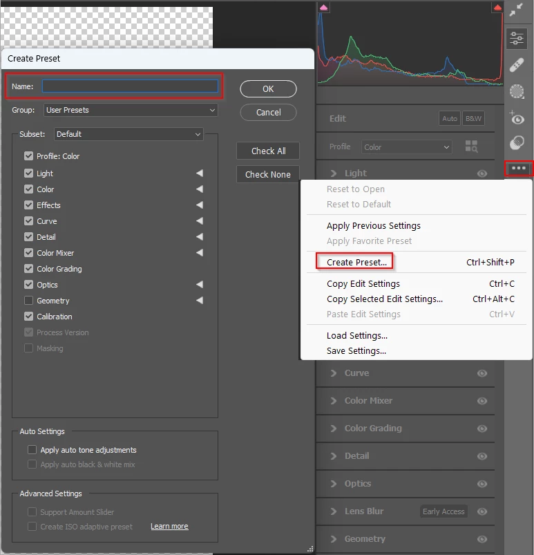

Can we still create presets for Camera RAW?  Michael Ninness demonstrated Camera RAW presets way way back in 2014 (I think).  That would be easier than creating a bunch of individual Adjustment layer presets.  I also have a feeling I saw some sort of grouped presets recently.  I rarely take photos nowadays, so don't have a use for it and have got rusty with that aspect.
Trevor.Dennis
October 24, 2023
Yes we can do it with both loading a RAW file to ACR, or using the ACR filter inside Photoshop.  That's the way I would do it.
