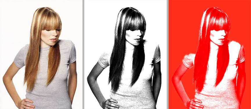

I have an image of an athlete that I would like to edit to make it like this one? Does anyone know how to do that?

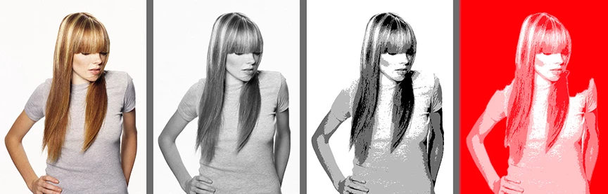

    Consider the Image> Adjustments >Posterize...2 levels and lighten the black end of the tonal scale.Then fill the surrounding image with solid color
    Norman Sanders
    March 16, 2018
    Another option is to use Levels to increase contrast, then Hue& Saturation command with colorize checked. Fill with red set to Color. Then Select the white surrounding the person and fill with red.
    Theresa J
    March 16, 2018
    Create a layer above the athlete and fill it with red. Change the layer blend mode to ‘Color‘. That will make the photo look red, but you may also need to add some contrast to the image. You can add a levels or curves adjustment layer between the athlete and the red layer to adjust the constrast.

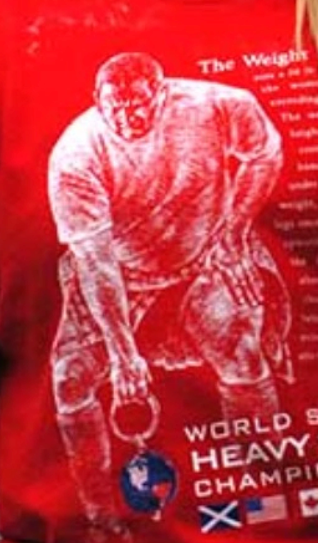

    Sorry for the confusion, I dont need to make it red. I need to take a photo of an athlete and make it a detailed line drawing like this one. I tried image trace in illustrator, but I think this is something that needs to be done in photoshop. I have tried a few things but can't quite get it right. I need to be able to take the white lined drawing of the athlete and have it printed on t-shirts.
