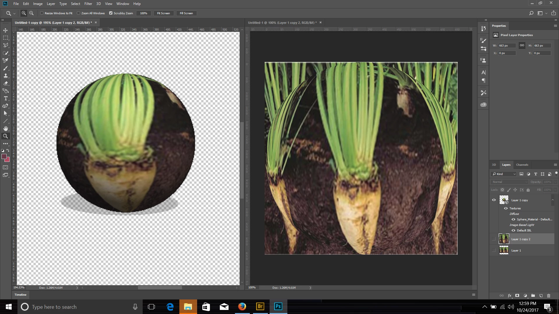

I tried to find out by myself but without any success. Is there anybody who could avise how to create a ball from picture (see example below)?
Thank you in advance!!!
Martina

    I personally like Daniel's method, but you can also use Filter>Distort>Spherize to make a 2D ball. It works best on an image that has a 1:1 aspect ratio, and you would have to isolate the sphere and delete the outside area. Here's a sample between the two methods:

    3d....

    May I suggest my YouTube channel if you would like to venture into Photoshop 3D tools.
    The Photoshop 3D Menu - Guide - YouTube
    This video demonstrates creating an object:
    To make a ball:
    1. Open your image.
    2. Go to the Photoshop Menu > 3D
    Once you select the sphere > it will "wrap" the image around the sphere.
    There are many videos that go thru all the elements of the 3D interface for Photoshop.
    I hope that helps,
    Daniel
