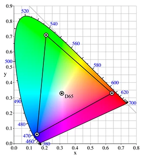

I'd like to create a CIE 1931 Color Space-type diagram. For illustrative purposes only, scientific accuracy not required. Making the blended colors has me stumped. My efforts so far are clumsy looking. Using Photoshop CC. Any suggestions? Thanks.

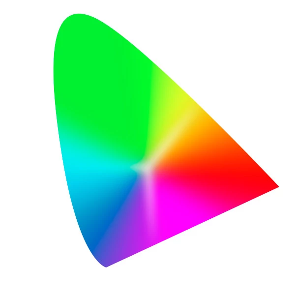

Cool Project. I tried using the Gradient Tool, One painted layers and smart Object to maintain edibility or scale.
Result:
Heres the PSD File should you wish to use it as a base.

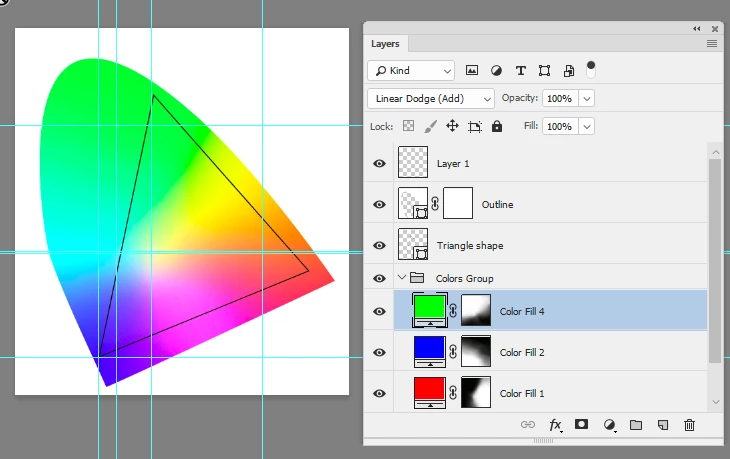

You could do an illustrative approximation using Color fill layers set to Linear Dodge (Add) and masks. I used Lab mode as it seemed to blend better
To get a more scientifically accurate result you may need to use a script

You're welcome. Actually there is a black layer at the bottom, not visible on the screenshot - it just made it easier to see when lining up the masks
