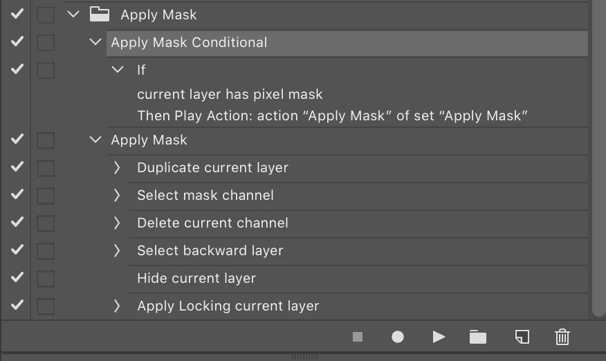

Stephen Marsh
February 10, 2020
So how did the action set download and matching script code that I provided work out?
Stephen Marsh
February 9, 2020
I tried your script code but it does not work for me.
I have tested the following with success in a limited testing model (however, I don't know your layer structure so it may not work the same):
You can download the action in the link below:
https://www.dropbox.com/s/yyum9jvntvlhjmb/Apply%20Mask.atn?dl=0
Then using a helper script to run the conditional action on all layers (if the condition is true, then the conditional action plays the action to apply layer masks):
//forums.adobe.com/message/8895266#8895266
//forums.adobe.com/message/8895401#8895401
var ActionName = "Apply Mask Conditional"; // Replace with your action name
var ActionSet = "Apply Mask"; // Replace with your action set name
if (!documents.length) {
    alert('There are no documents open.', 'No Document');
} else {
    processArtLayers(activeDocument);
function processArtLayers(obj) {
    for (var i = obj.artLayers.length - 1; 0 <= i; i--) {
        activeDocument.activeLayer = obj.artLayers[i];
        doAction(ActionName, ActionSet);
    for (var i = obj.layerSets.length - 1; 0 <= i; i--) {
        processArtLayers(obj.layerSets[i]);

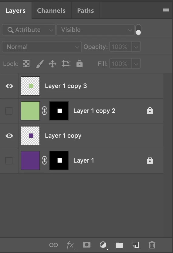

Layers Before:

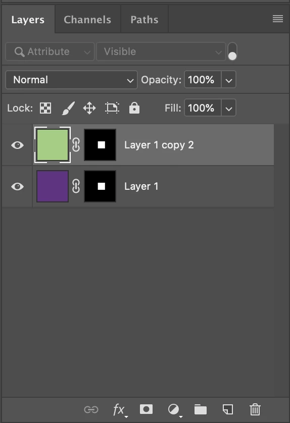

Layers After:
