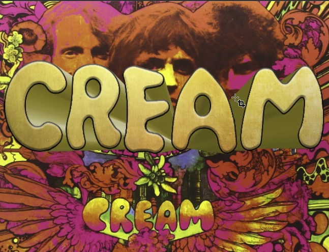

I am looking to create text that looks like the word "Cream" in the attached image. I would like for the text to "grow" from a smaller point, as it does below. Can anyone offer tips on how to make this happen? Thank you!!

    You could do it as a Frame Animation fairly easily so long as you didn't want the trails.
    This uses 60 frames so is fairly slow, but you could convert to a video timeline which would take just over two seconds (at 25fps).  Or you could use less frames.

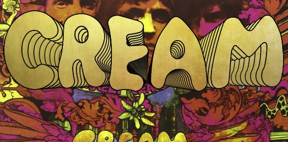

    If you need the trails, then that's a bit harder (although I am having an idea as I type this)

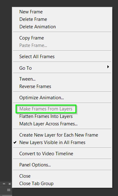

    What I did was to use Free Transform Step & Repeat to make the ever smaller layers, and then after creating a Frame Animation, use Make frames from layers
    You could manually turn each trailing layer on frame by frame, but the laminated ply effect is not especially attractive.
    OK, this is the idea I had back up the thread.  What I have here is an Extrude effect from Alien Skin Eye Candy 7.  It cost me $99 several years ago, has a tone of great effects, and I use it constantly.  In fact this is two layers because I extruded a copy, and have a Bevel & Emboss layer style on the original.  My plan is to  run Step & Repeat on this, or maybe a Smart Object from both layers.  I'll use a lot less frames to make it quicker as well.
    The Smart Object didn't work, so I had to rasterize the layers to make step and repeat work.  It doesn't matter as you don't have time to see the resulting loss of quality because it happens too fast.  We also need a bit of blur to make for a smooth animation.  This uses 27 frames stepping down 10% each step.  If this is useful, I'll give you a detailed description of how to do it, but there are lots of tutorials for Free Transform Step & Repeat.

    I missed out a step when describing the above, but I expect you'll have worked it out.  With FT Step & Repeat you have to start with the full size object and make it ever smaller.  Using the resulting layers with Create frames from Layers would produce an animation that went from large to small.  You have two options.  Before making the frame animation, you could select the relevant layers and go Layer > Arrange > Arrange > Reverse or you could make the Frame animation back to front and select the frames and use Reverse Frames from the timeline's pop up menu (top right corner of timeline).
