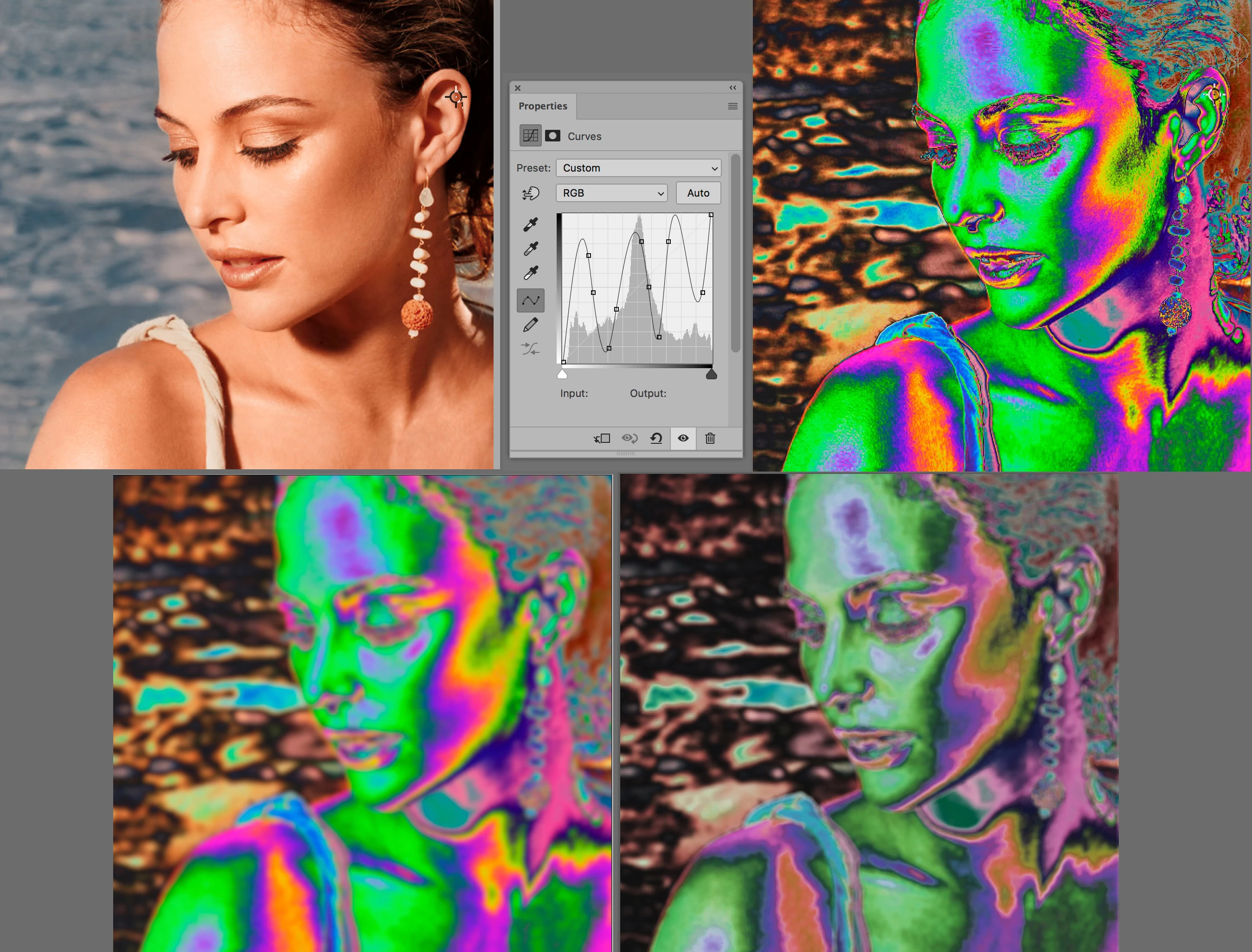

Correct answer Norman Sanders
Fig 1. Original
Fig 2. Curves (The possibilities are infinite.)
Fig 3. Lens Blur
Fig 4. Hue/Saturation
Norman Sanders
Norman SandersCorrect answer
January 17, 2021
Fig 1. Original
Fig 3. Lens Blur

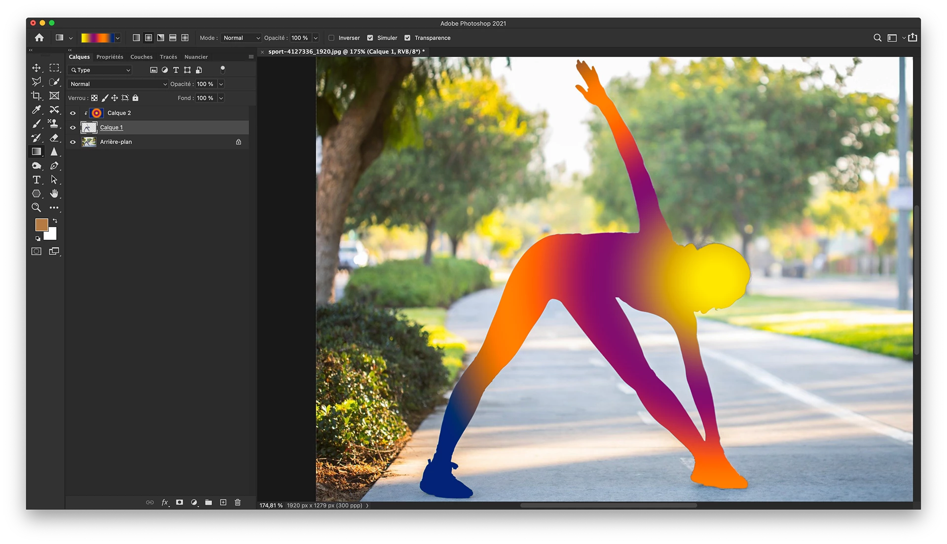

didiermazier
January 17, 2021
Just a clue… try with gradient… several ways with or withour mask, uniform or noise
Semaphoric
January 17, 2021
I would guess a Gradient Map. I think it is helped by the lighting of the original, which models the subject well. The area around the ear looks weird to me. I think the original was monochrome, and someone airbrushed out the ear. The smoothness of the airbrushing would yield the bulls eye effect with a Gradient Map applied.
