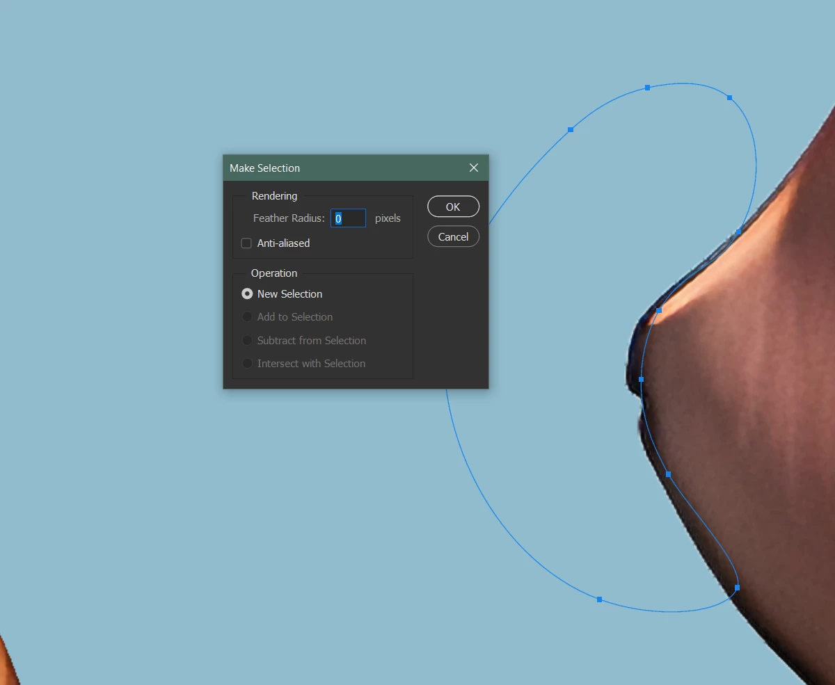

Hello everyone, I hope I get your help with this issue.
Basically, I use the pen tool to create paths/shapes and then convert said shapes into selections. Once the path is closed, I right-click and then choose "Make Selection" to do this. The issue is this pop-up that appears every single time. I would like it disable it but can't find a way to do so.
I do know that the lasso tool can be used to make selections but my issue with the lasso tool is that the curves are never as smooth as what I get with the pen tool.
I would appreciate your help. Thanks in advance. ^_^  - Germaine

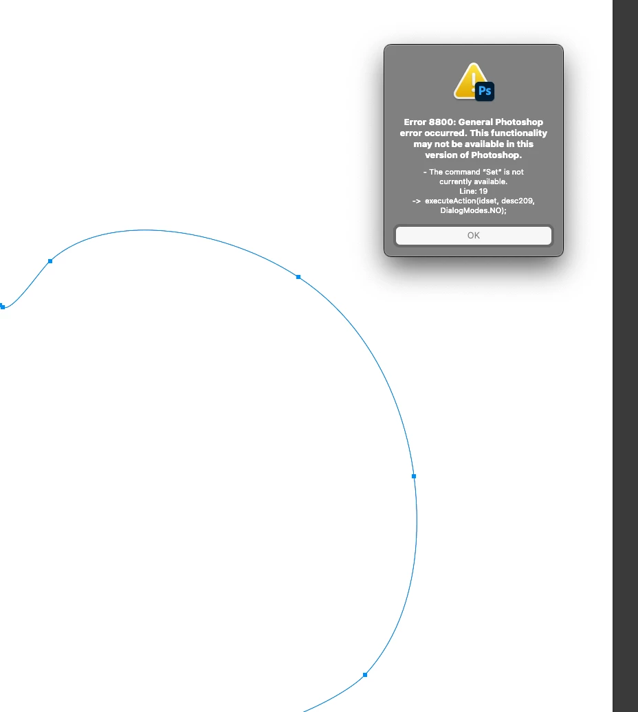

Hi Stephen, thanks for your reply. This is the error that comes up when I execute the keyboard shortcut which I assigned to the script.
Both blocks of code work for me in Ps2024 (25.9.1) without error and I am also on a Mac.
For what it's worth, here is the re-recorded code (tested in 25.9.1 and 25.11.0):

Do not use the menu item.
[Ctrl] +click on the miniature of the path in the path panel   or   use the third icon at the bottom of the path panel (stylised marching ants).
artbygermaine
August 9, 2023
Hi pixxxelschubser. Thank you, this is my current workaround for now. I've been keeping the "Paths" tab open and within reach. It's not exactly what I wanted but Iguess I have no choice? T_T
I should have noted in my post that I have set a keyboard shortcut for the "make selection" function and those keys are ones close to my left hand while my right hand remains on the drawing tablet. The annoying pop up forces me to move my right each time in order to reach the Enter key which was why it's a bother for me...
Thanks for your input though. It's greatly appreciated. ^^
