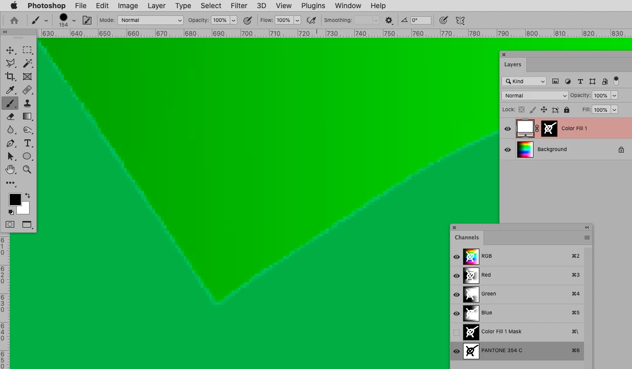

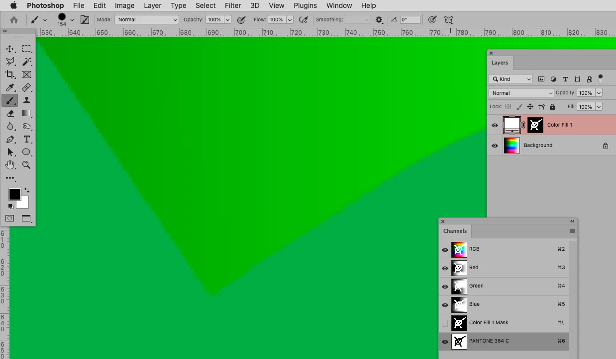

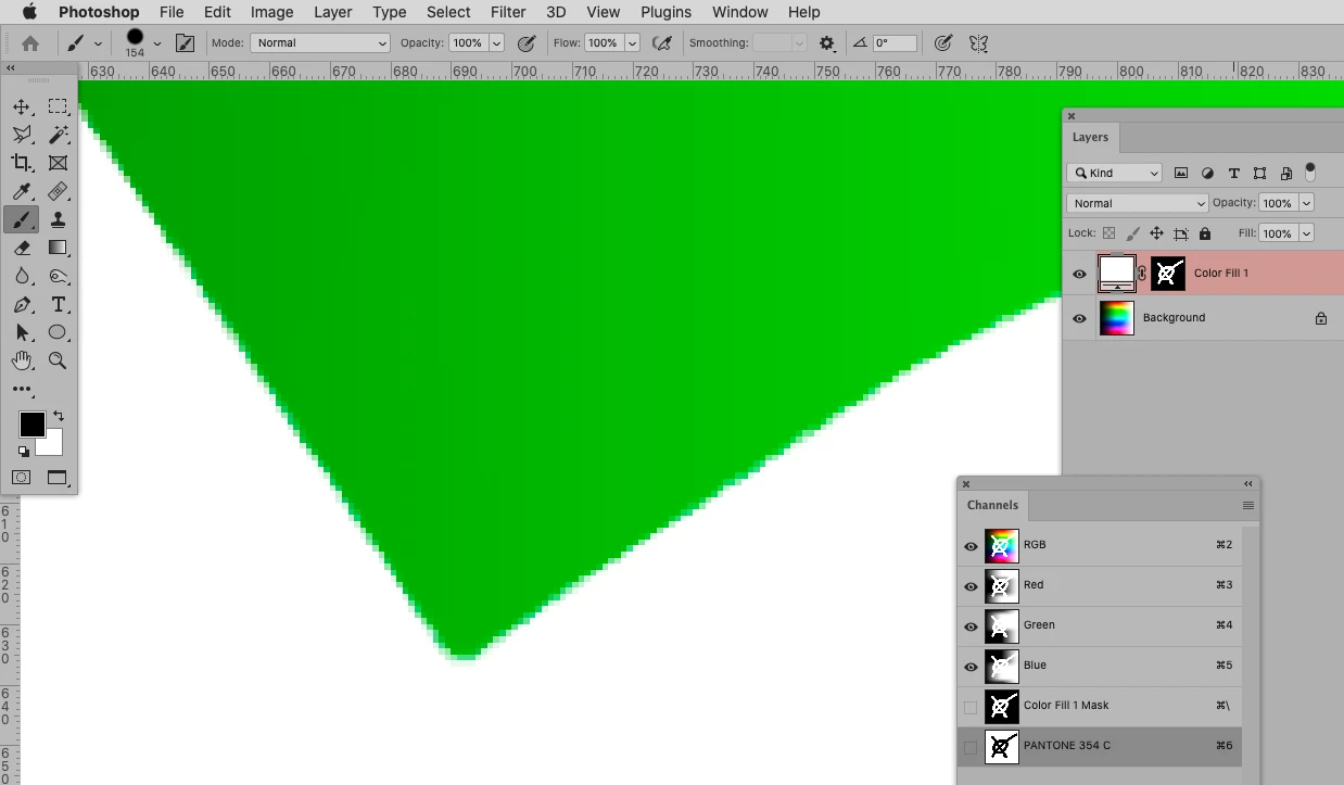

Could you please post screenshots with the pertinent Panels (Toolbar, Layers, Channels, Options Bar, …) visible?
Load the Spot Channel as a Selection, invert the Selection and create a white Solid Color Layer.
With Spott Channel areas of other values than 100% this naturally can become pretty nonsensical.
Anti-aliased edges should not be an issue themselves but you may want to employ trapping for the spot color – most likely choking the knock-out for a metallic color:
Best ask the print provider about how much to contract the knock-out.
