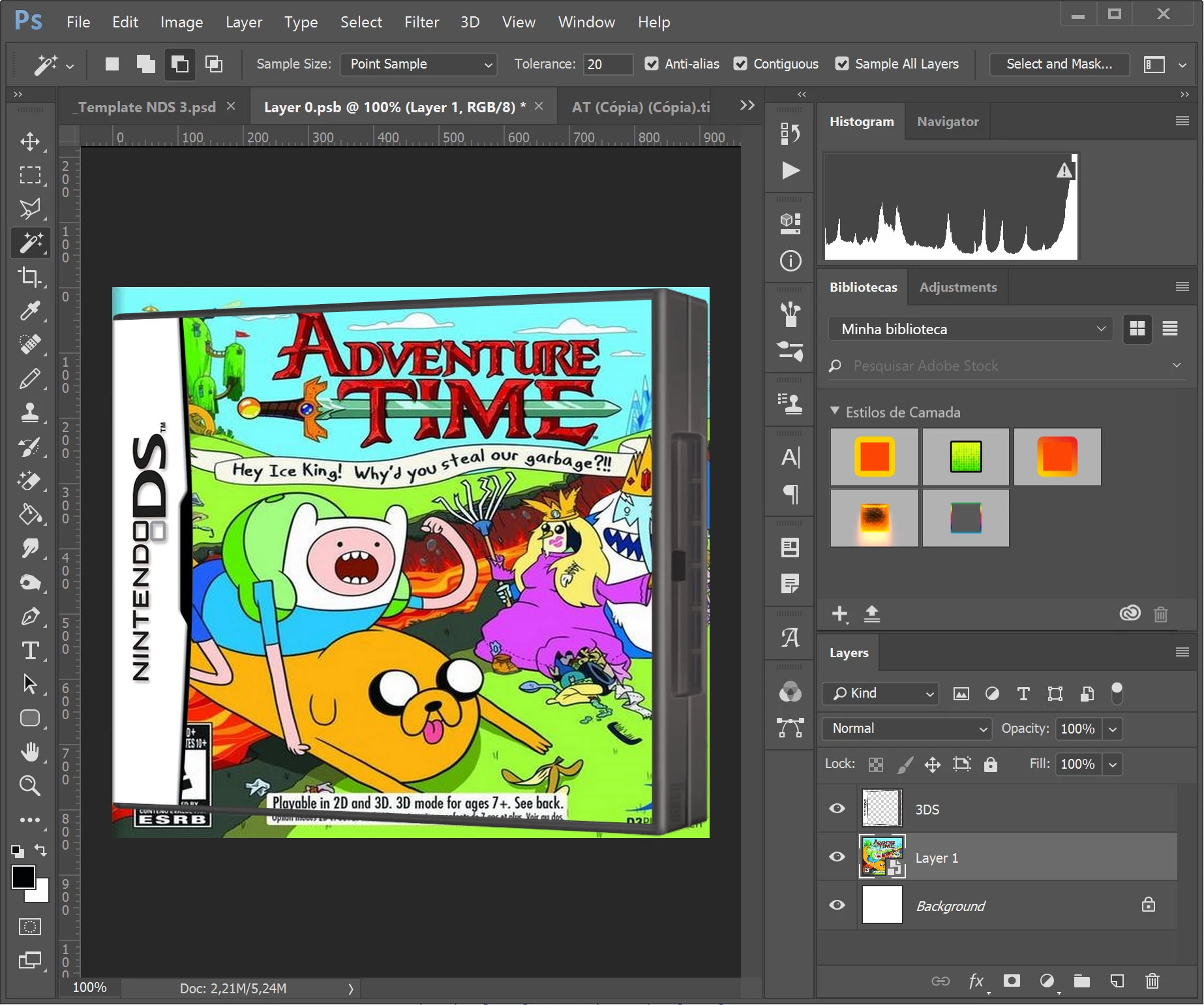

    claudiop42841845
    July 11, 2018
    Hi Bojan, I make it but some step is missing on my mind.
    Here: 3DS.zip - Google Drive
    Its contain 2 files.
    Claudio

    c.pfaffenbichler
    July 11, 2018
    Sorry, there seems to be a misunderstanding.
    First you need to set up the dummy file like this and then you can use a Script to automate switching in different content for the SO.

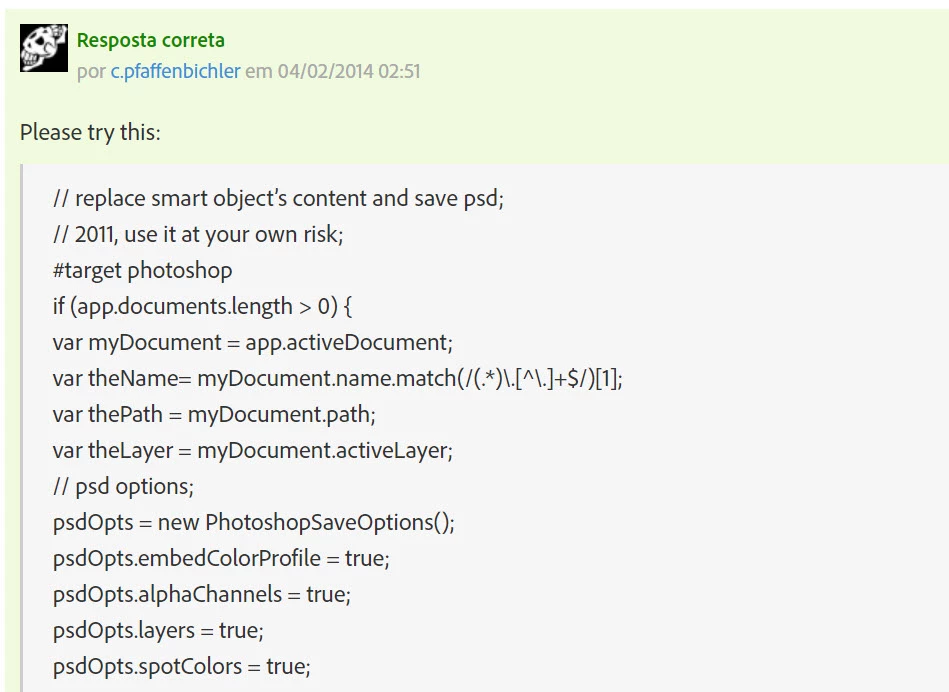

    Make this.
    But when use the script, give me the "Command SET is no avaliable"
    Used this script:
    Claudio
    c.pfaffenbichler
    July 11, 2018
    As perspectival foreshortening seems to be involved I would recommend creating a master file with a transformed Smart Object and switch in the images in turn.
    There have een several threads on the Photoshop Scripting Forum on automating such processes.
    But if the images do not all have the same relative dimensions you should set up a rule: clip or add white/black/… space?

    c.pfaffenbichler
    July 11, 2018
    I need transformation Ds model in Smart Object, correct?
    The translation may be off, but the transformation should be applied to the Smart Object in the containing document.
    Then replacing the Smart Object’s content with the other images would apply the same transformation to those.
