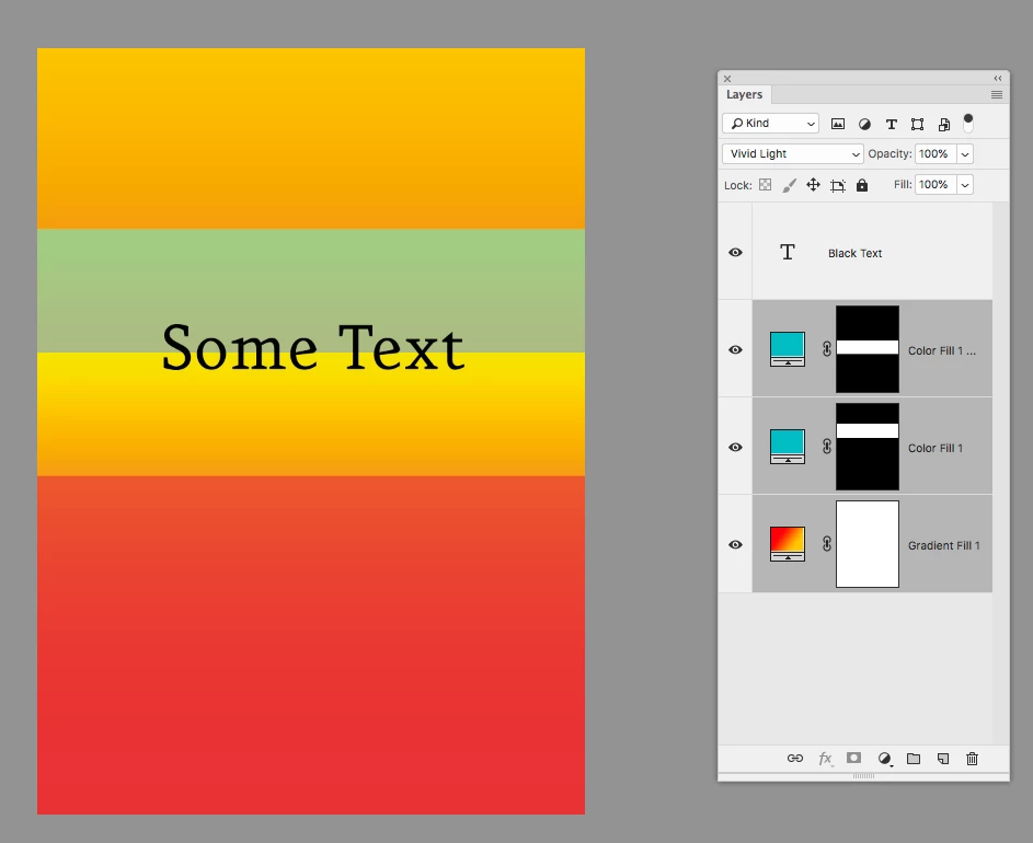

If you have to use PS as a layout app, you can set type as 0|0|0|100 CMYK as long as your document's color space is CMYK, but usually it is better to edit in RGB mode and convert to the press CMYK space, because of TAC and black generation issues. You also want to keep the text as a type vector layer so the document can be saved as a PDF, where the text doesn't get rasterized.
If you can keep your text in a top layer, you can edit in RGB, merge the bottom layers, convert to the destination CMYK space, and edit the text layer's color to 0|0|0|100. So:
RGB layers

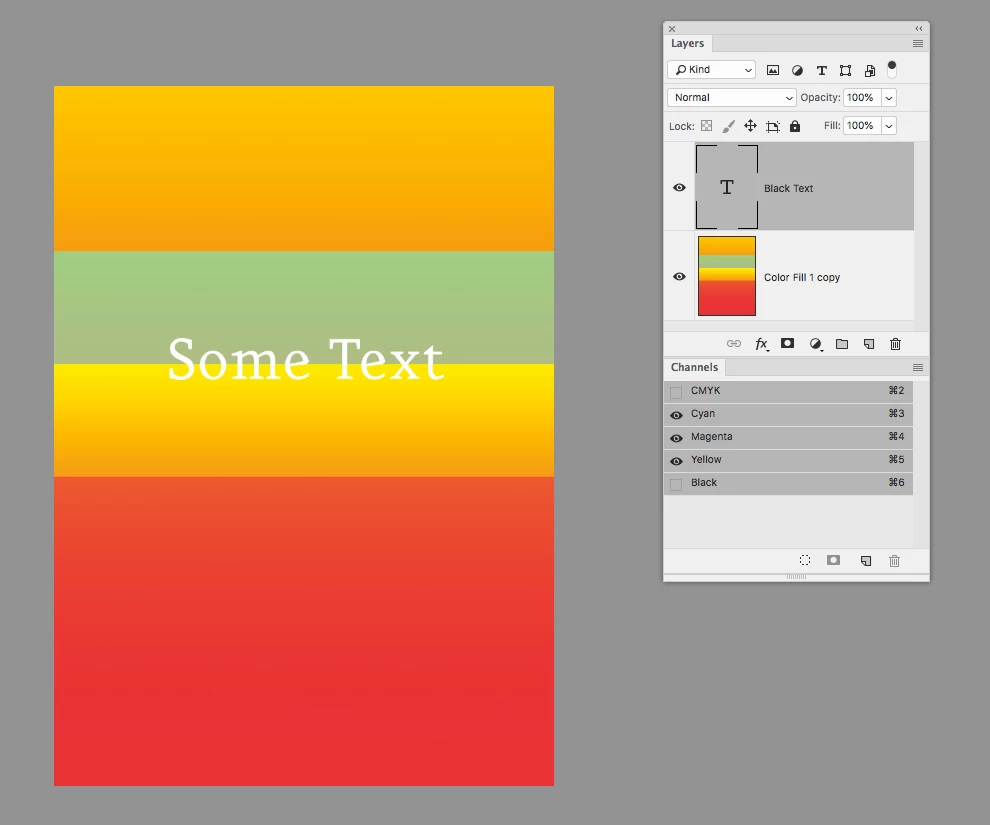

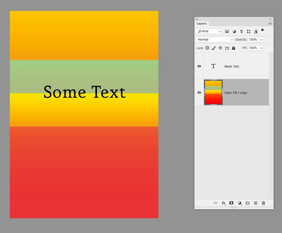

Duplicate the doc and merge the bottom layers

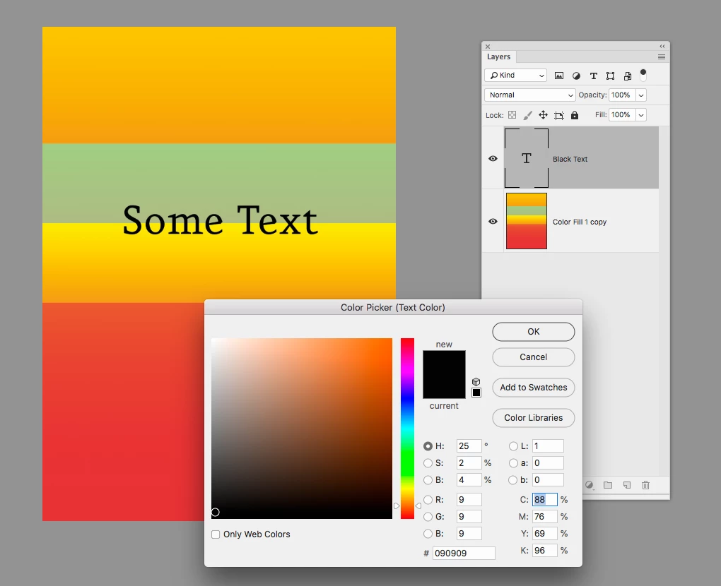

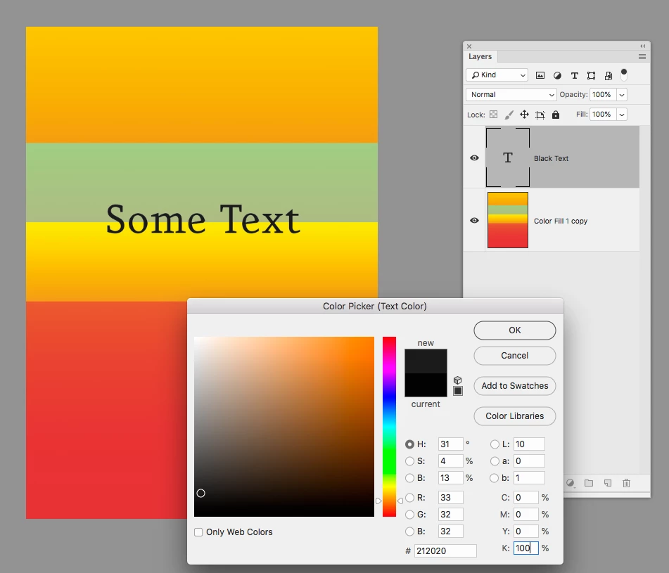

Convert to CMYK, select the text and edit the text layer's fill color to 0|0|0|100:
By default the black only text will knockout
If you want it to overprint set the text layer to Multiply
