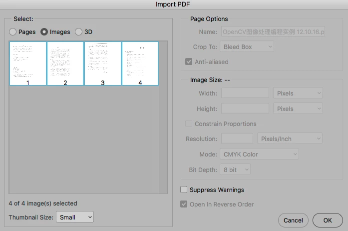

I have a pdf file to processing here.
I note I can import the pdf file as a image for every page content. like this
I can auto-adjust the contrast by Alt+Shitf+Ctrl+L for every page. Then I will get a very good page like this
I have to say I get a larger improvement for this page, but if my pdf have 200+ pages, I don't know how to adjust and export it in batch method. Can anybody help me out?
    Correct answer c.pfaffenbichler
    That seems to be a fairly suboptimal pdf to begin with … the type appears to be pixels.
    I am afraid the task exceeds Photoshop’s default functionality, but Scripting would provide a work-around:
    Photoshop Scripting
    But mind you: The pages apparently already being images you should open the images, not the pages, to avoid resampling and the ensuing image degradation.

    c.pfaffenbichlerCommunity ExpertCorrect answer
    December 17, 2017
    Photoshop Scripting
