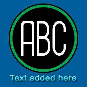

You mean like this?
The text animation runs on 2s and the blinking one runs on 1s (base frame rate of 24fps). The animation is actually slightly longer than 8 seconds. As was stated before, the blinking consists of only 6 frames, and two frames at the very end will have to be cut off to match the frame length of the text animation.
I did this in OpenToonz - easier to do in OT, since importing the two gif animations automatically creates two frame-based timelines, and the text anim is imported on 1s. With OT I selected those frames, and told it to expose on 2s. Then repeated the first 6 frames of the blinking, and exported as a gif animation.

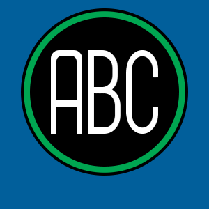

JJMack help, Thanks for response, Yes, these two animations have not the same frame size, but want to play & finish together at the same time. For example, the two animations like this:
This is Logo-ABC (8 seconds):
This is Text-anim (8 seconds):
Then, I plan the Text-anim to be merged to the bottom of Logo-ABC, and play & finish together at the same time 8 seconds.
