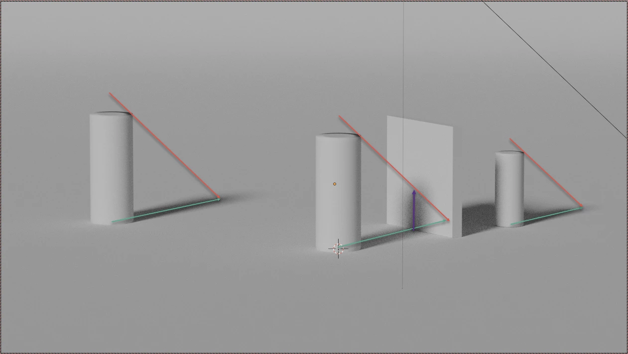

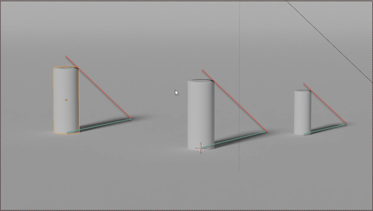

To add what Dave mentioned, if the main light/sun is coming from behind the subject, you can draw lines from different objects in the photo and extend them out. They should meet at one point. Then you can draw new lines from that point to your new object and get the proper angle.
davescm
May 13, 2022
Good point Chuck. The closer the light source gets to directly in front of, or directly behind, the viewer then the more the impact normal perspective has on the shadows. So, as you rightly point out, there is the vanishing point to take into account.

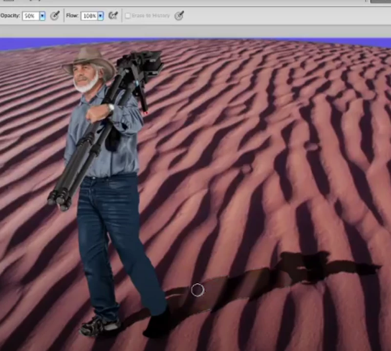

Bert Monroy is the master of this sort of illustration using Photoshop.  You probably don't need to worry too much about the second half of this video where he uses a Displacement map to shape a shadow aupon a wavy desert floor, but the first half should help.
In this video he deals with shadows that fall on complex surfaces like a floor and a wall
In actual fact Bert is choosing not to complicate things too much, as he would perform more steps to make the shadow look real.  For instance where the shadow falls on rippled desert that is facing away from the subject it would be less dense like this.  (Quick and dirty and much easier to do when you have the layered document)

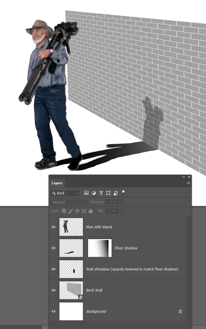

When a shadow falls on the ground and a wall you do each element separately as below.  Note I used a dragient in a layer mask to lighten the floor shadow with distance.  To fine tune that I unlinked the layer mask and moved the layer mask for best effect.  It was then a simple mater to lower the wall shadow layer opacity to transition into the floor shadow.
Bert has another video somewhere that shows him runing a shadow along the ground, up a kerb, along the sidewalk and finally up a wall.  It's exactly the same technique used as many times as needed.
