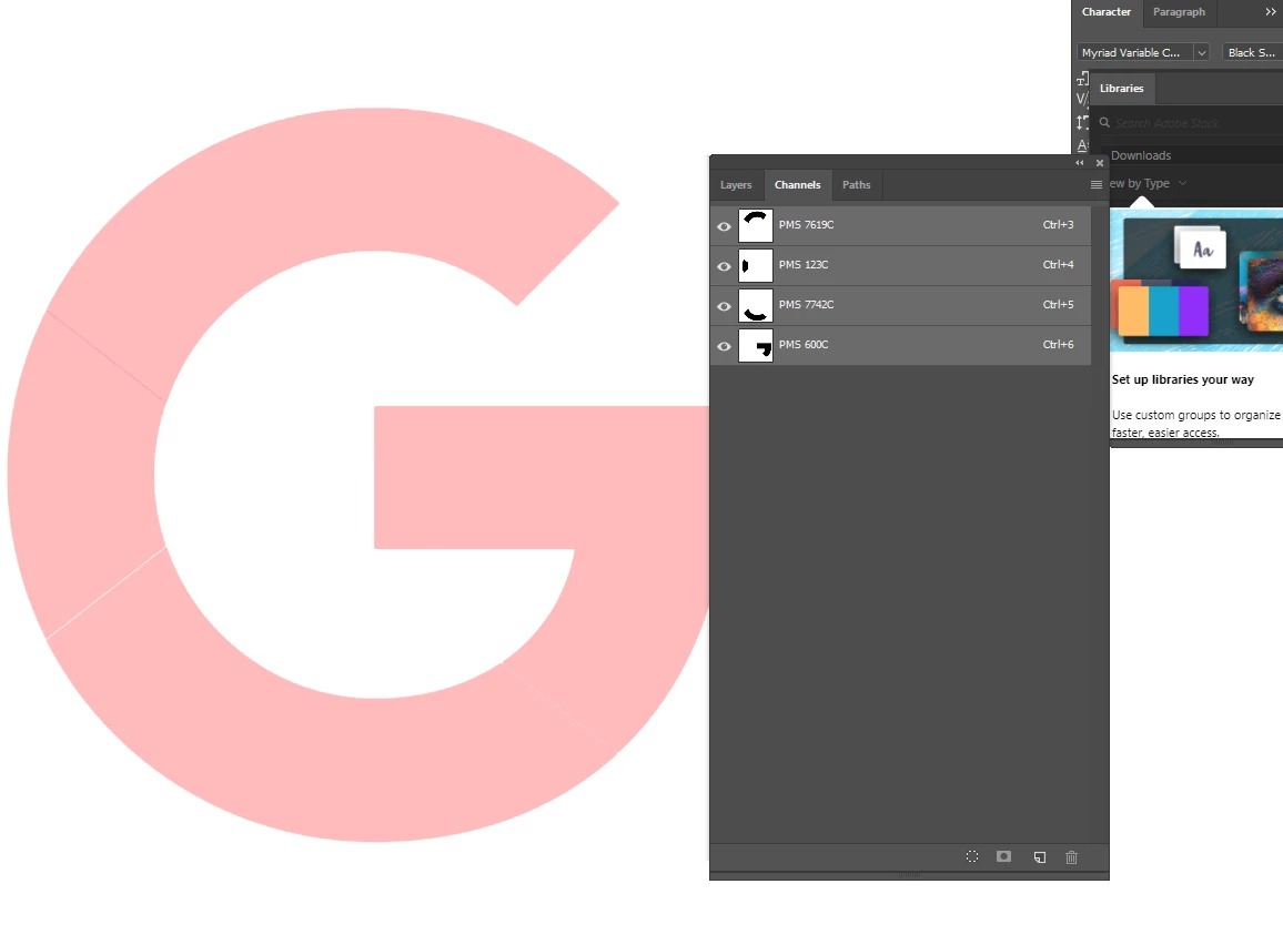

maxwithdax
February 15, 2019
jordini​ are you creating specific spot color channels in your files? If you are creating logos inside Photoshop that will be printed with spot color ink, then you want to make sure that you have the channels setup in your PS file. You can't just design and sample with the eyedropper and tell them what color. Each color has to be on its own channel. Just wanted to make sure you were aware. Typically Photoshop is not the normal tool for complex spot color printing.

Jordini
JordiniAuthor
February 15, 2019
Thanks!  This is very helpful.  No, I was not "creating specific spot color channels in my files" but that is really good to know. I'm self-taught and this is clearly new territory for me.  So I really appreciate the help.
